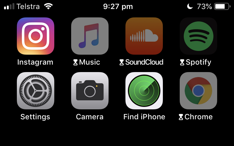

Okay, so I have Downtime set on out daughter's phone so nothing bar the essentials should be available after 7pm & before 7am.
I have added the required apps to the access at all times list.

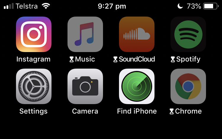

Out of hours the restricted apps show the little hourglass beside them. All but Instagram.
It is not in the allowed list yet it keeps showing up.
This has to be a bug of some sort.
I've tried adding it to the list & removing it. Rebooting the phone etc yet still it shows up when it is not supposed to.
Any suggestions? Of all apps it's the one I really do want blocked!!!

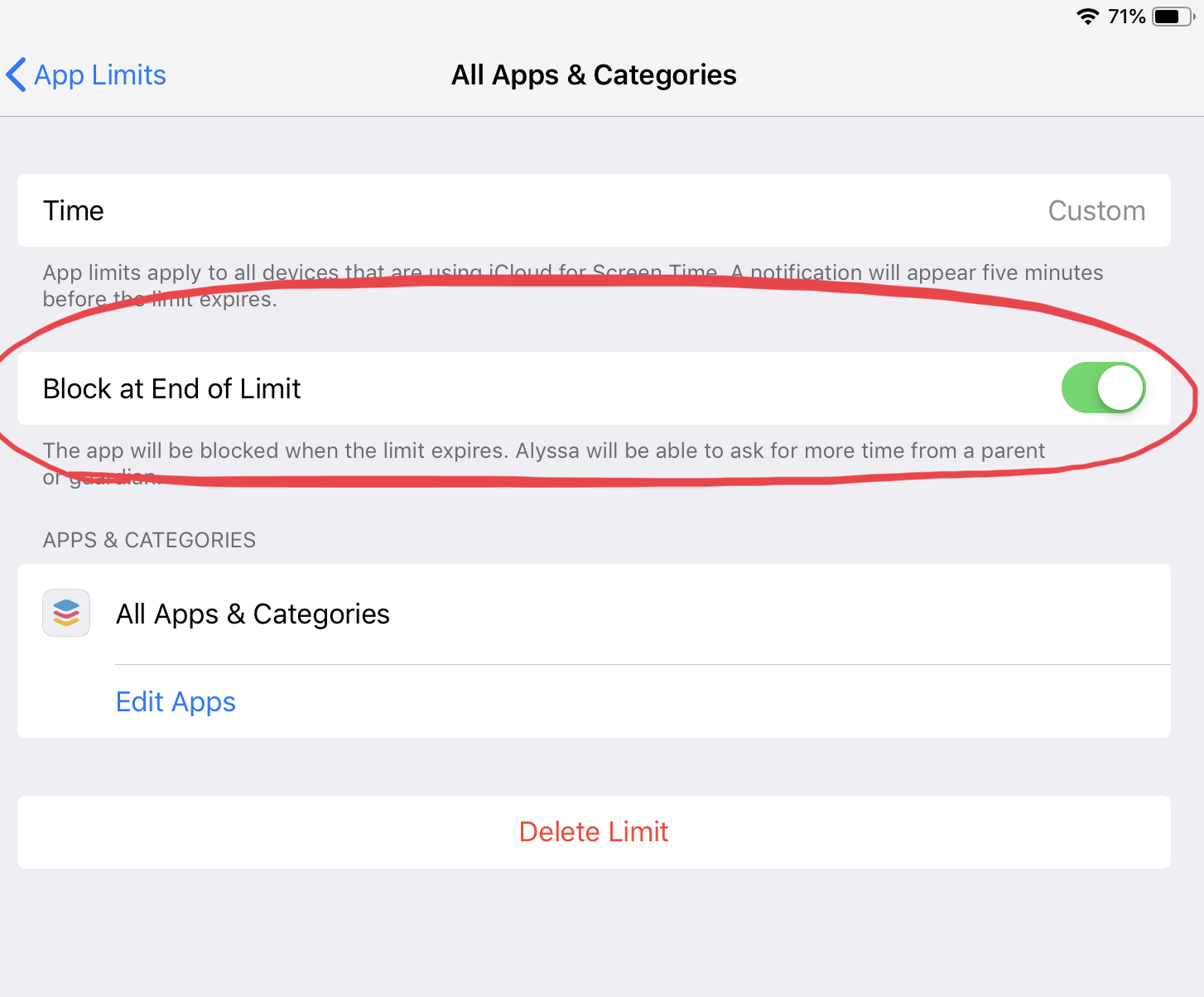

Do “All apps and categories” and make sure “Block at End of Limit” is on under the App Limits section. Works flawlessly for me. Could it be that you don’t have this checked? If so, the child is presented with a message saying the limit has been reached, and do they want to ignore the limit? If they click ignore, it lets them right back in.
Thank kmichalec, I have all that set yet Instagram just keeps ignoring the settings.

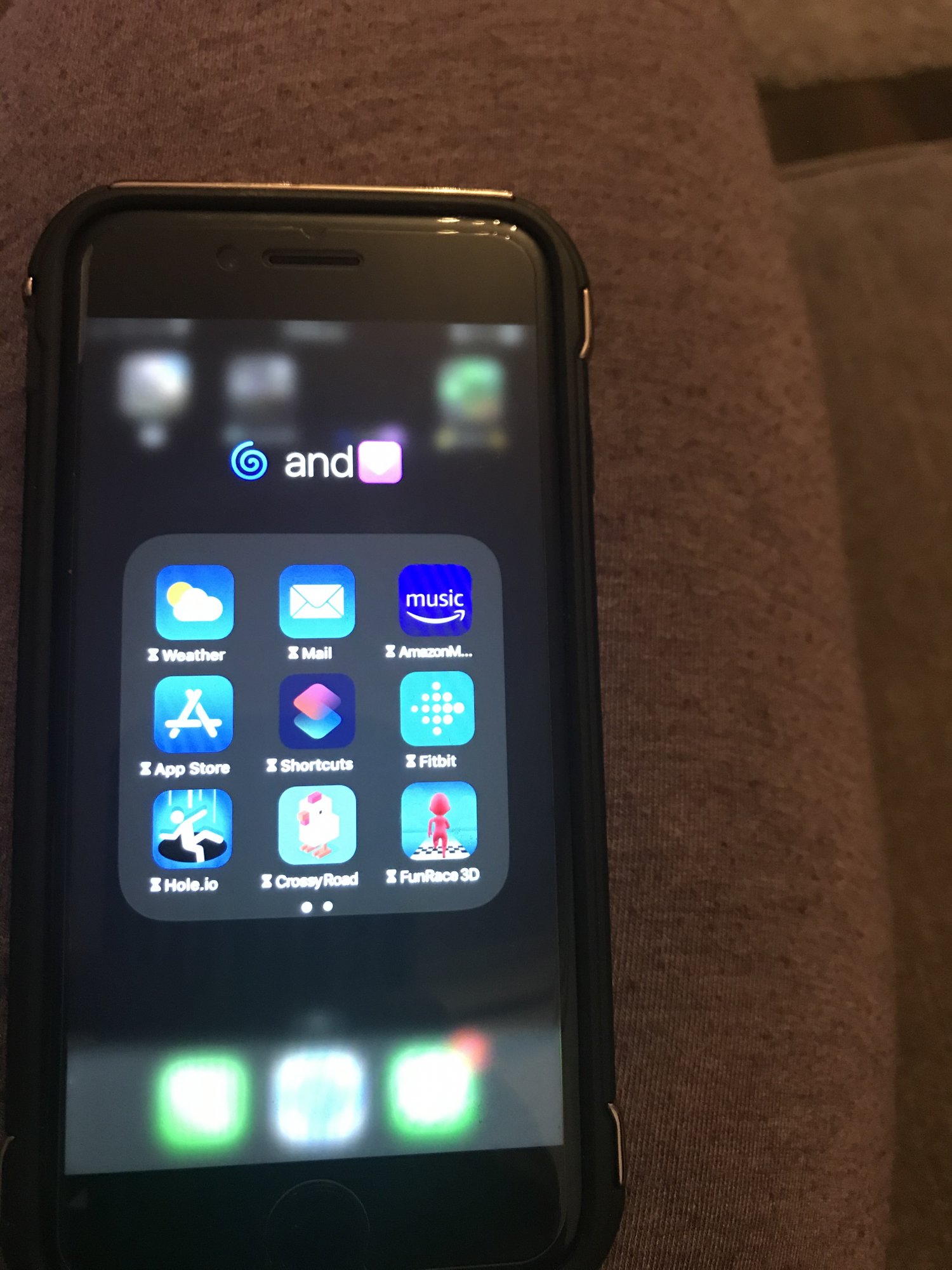

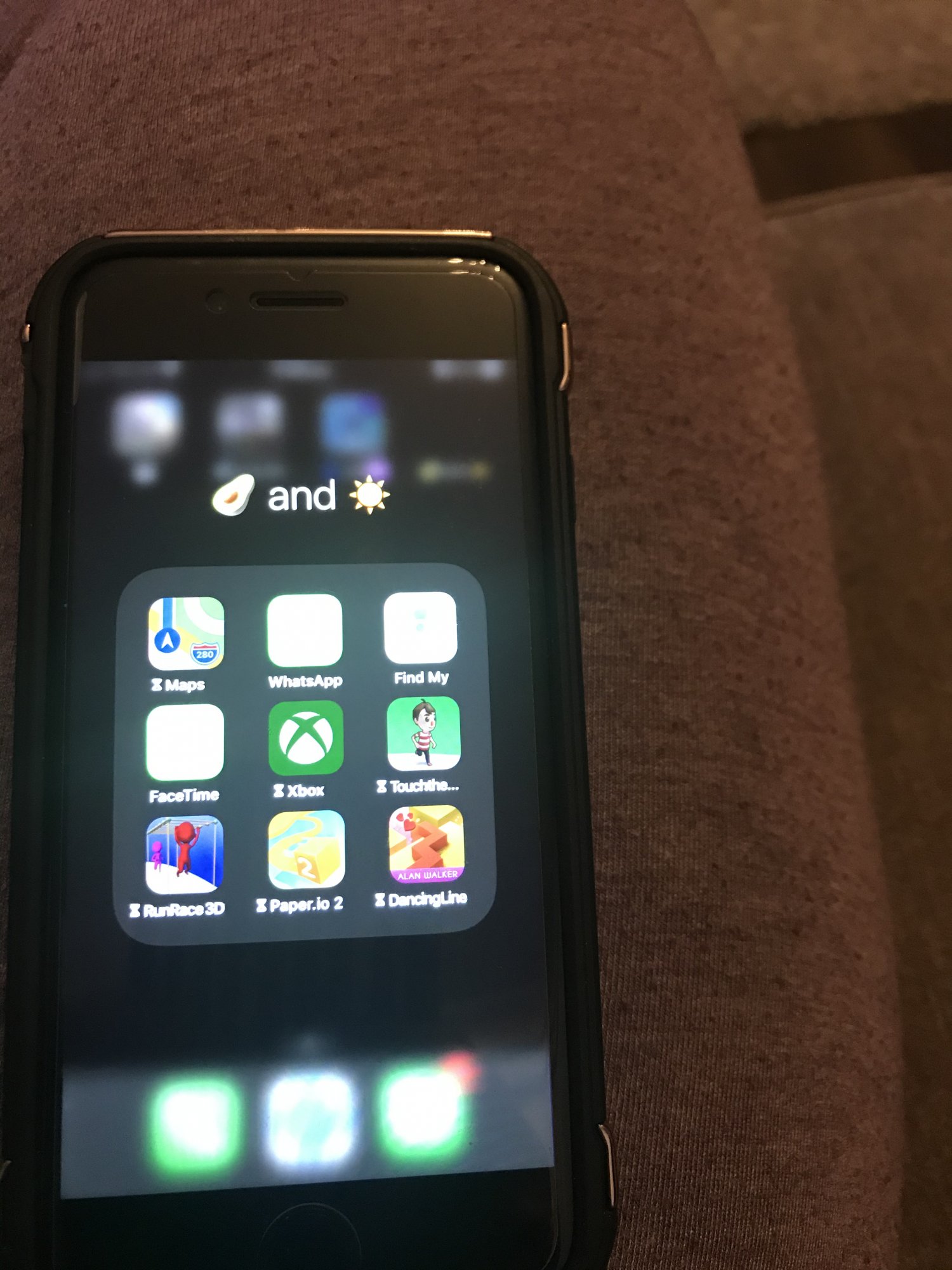

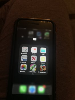

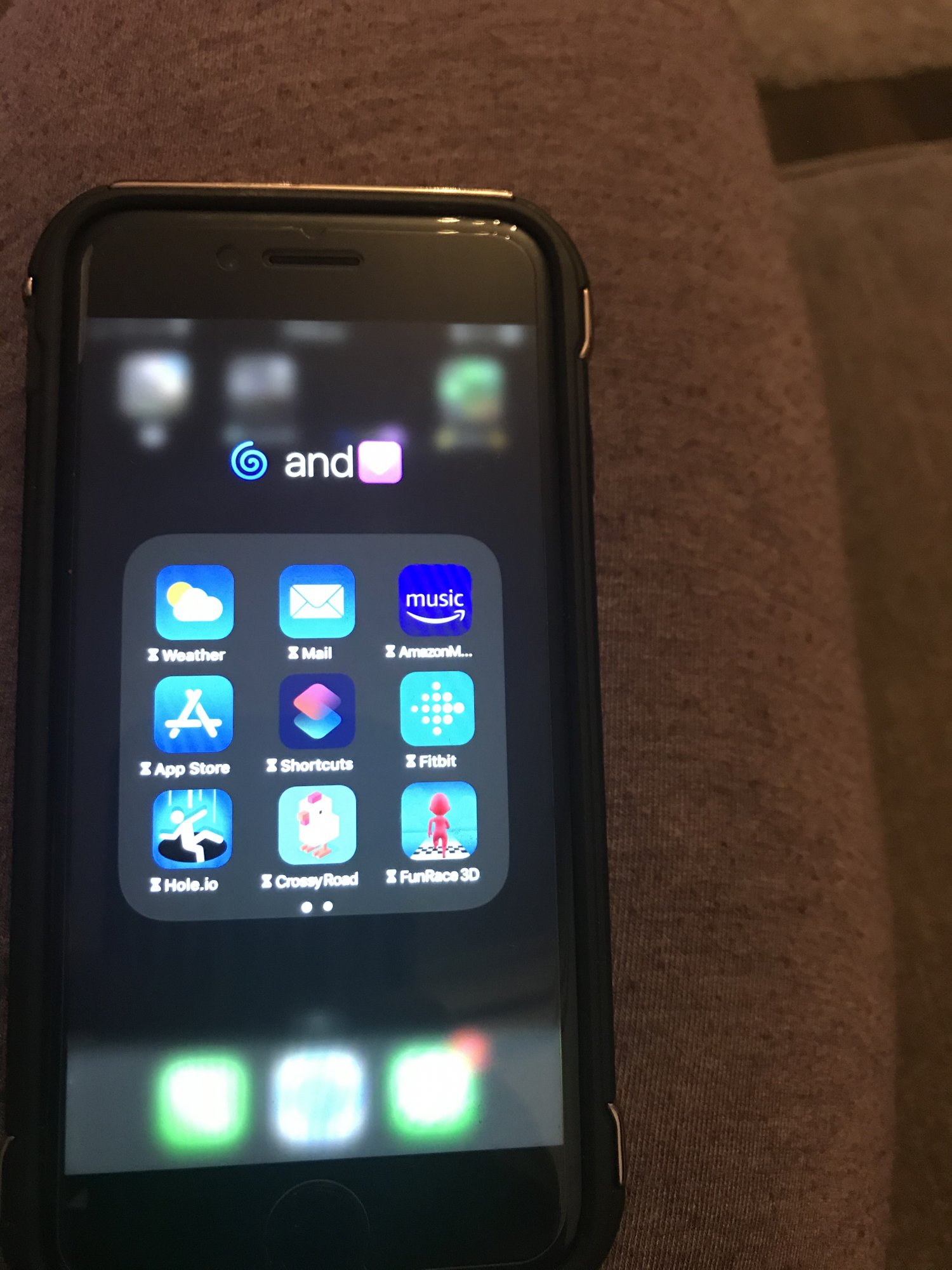

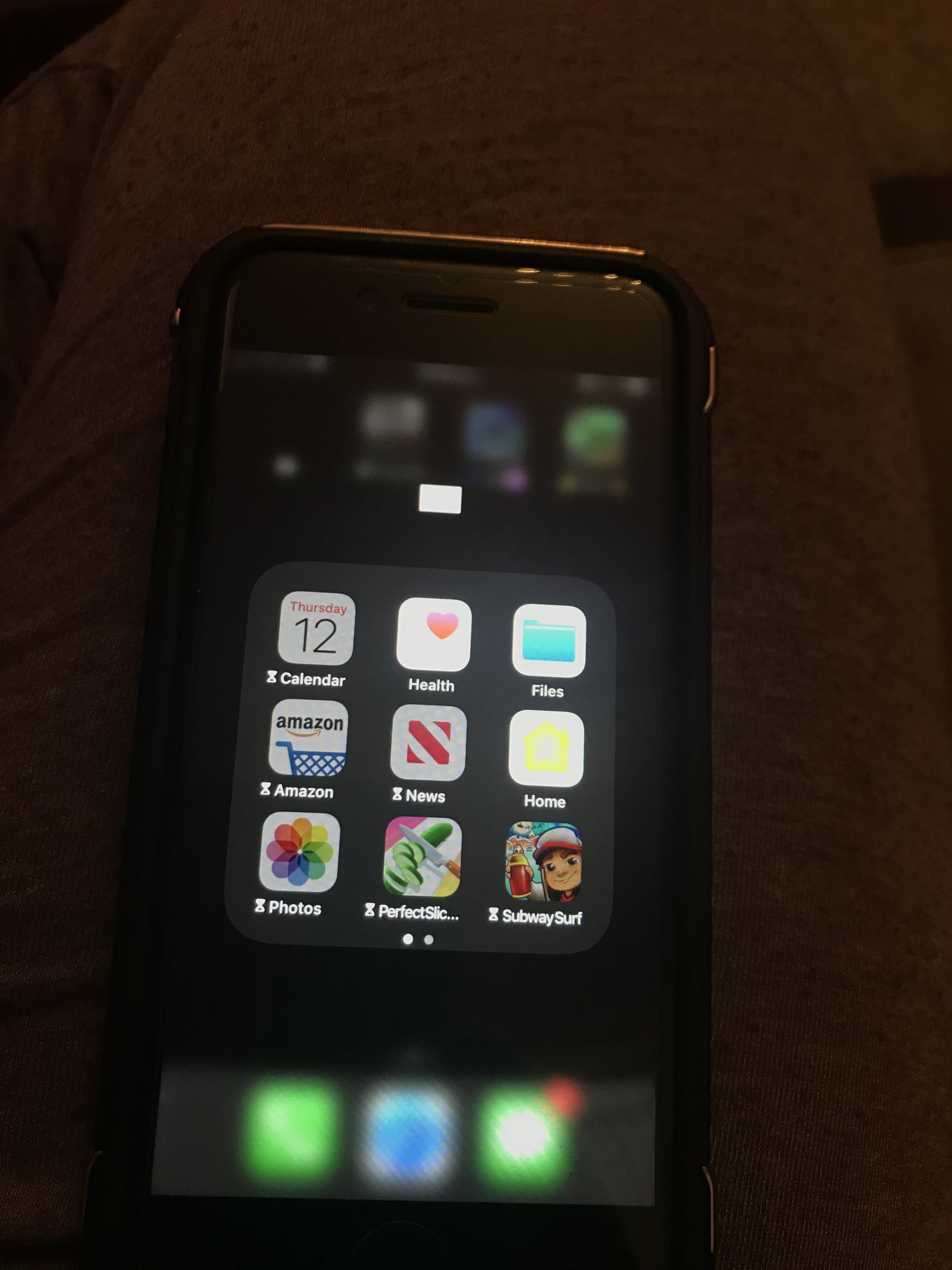

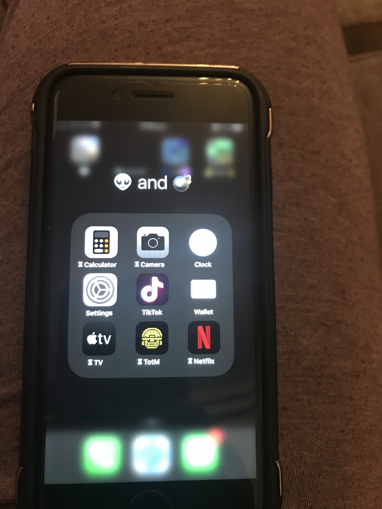

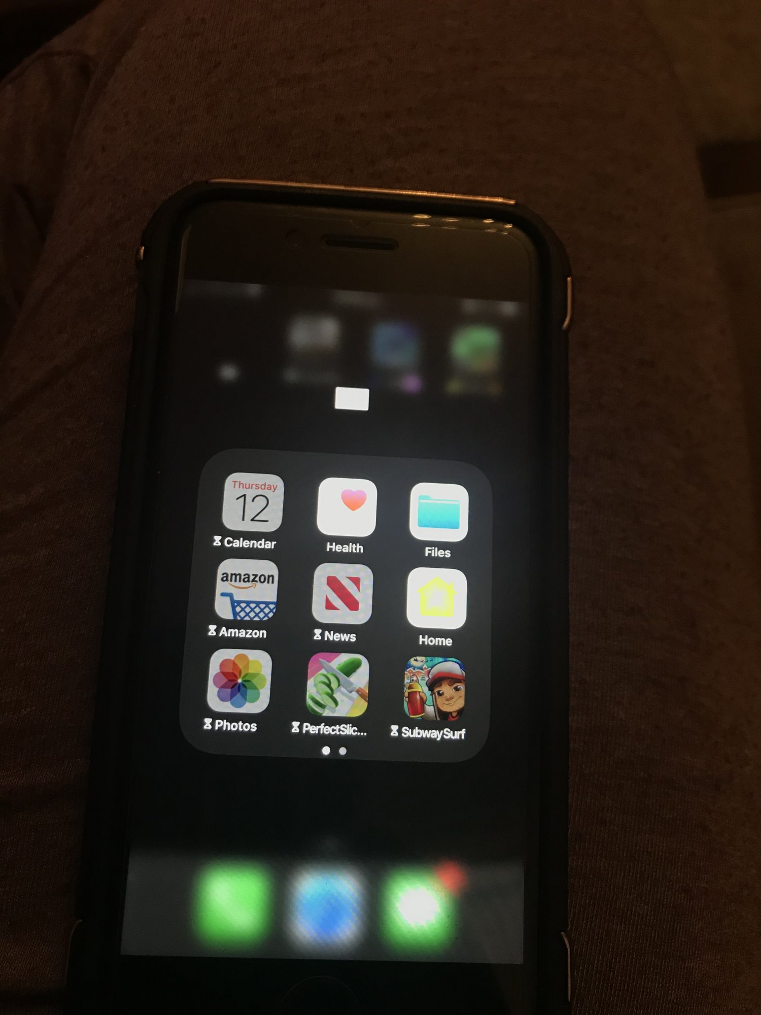

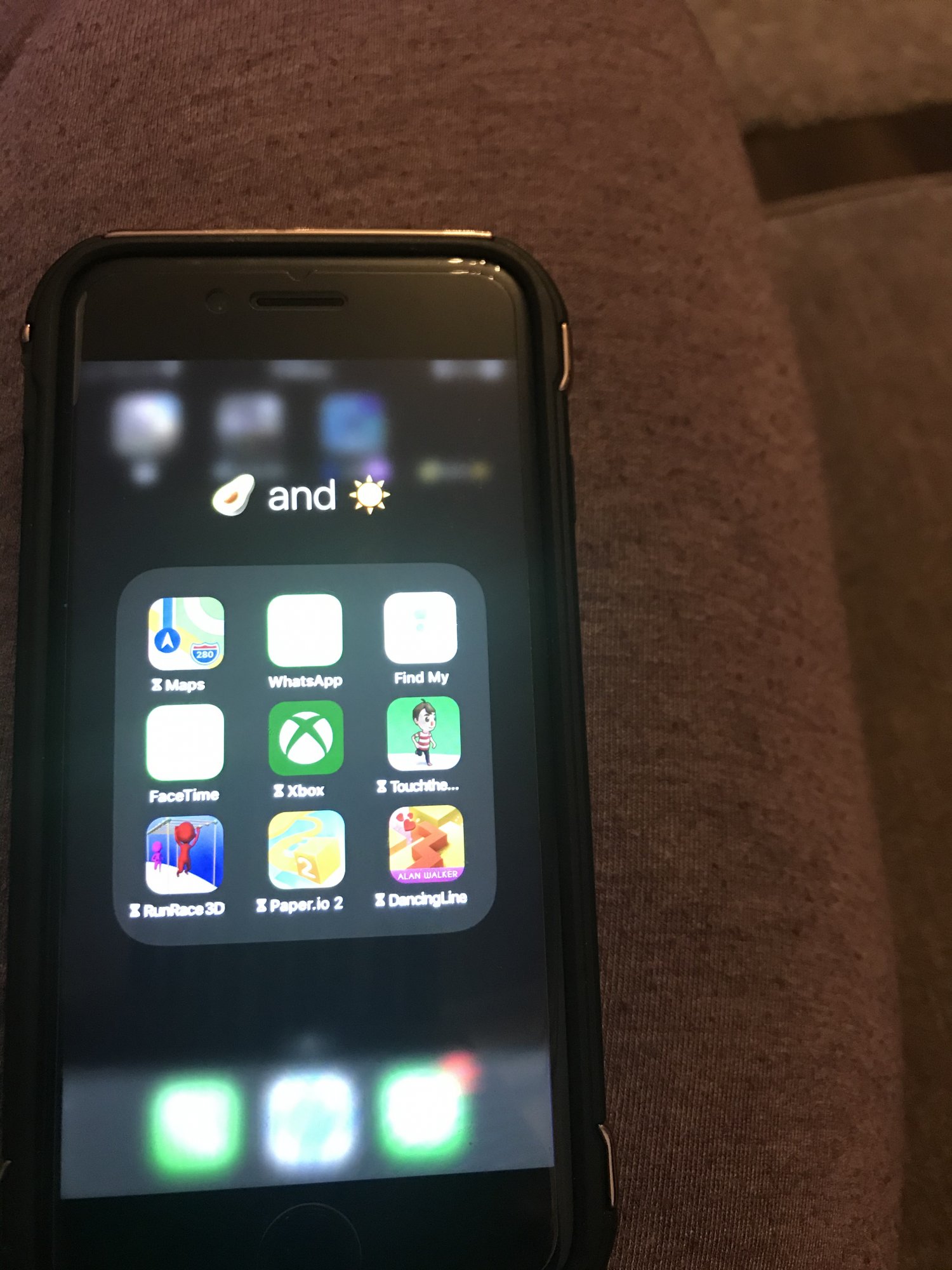

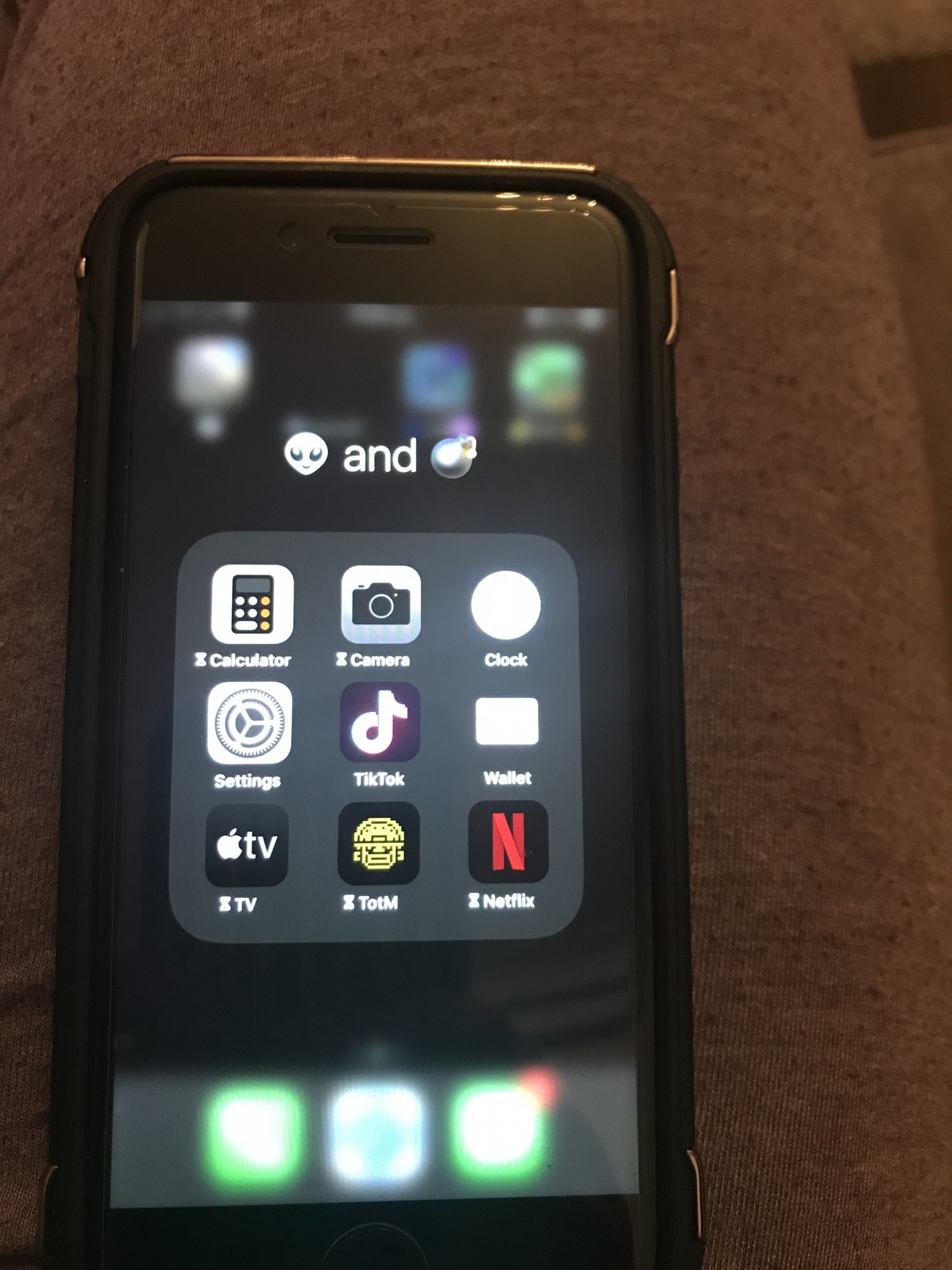

All is set correctly. The only thing I can think of is, I had the passcode turned off recently and she had over ruled the limit on certain apps. And now I’ve put the passcode back on downtime isn’t blocking these apps.

Is it in low power mode? Instagram disables background app refresh when in low power mode, which seems to be how the data is monitored by screen time. So if your kid puts their phone in low power mode, it stops your phone from tracking the app via data flow.
Had this same issue with my child’s Instagram app being active past downtime. I checked Instagram settings and saw background app refresh was off while phone was in low power mode.
Switched phone out of low power, went to Instagram app in iPhone settings and enabled background app refresh.
Went back to screen time and enabled block when time expires. Set time to 1 min. After 1 min, Instagram was blocked.
hope this helps.
