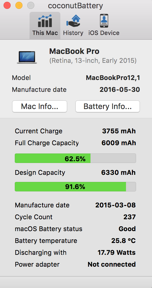

Have you checked the battery using "Coconut Battery"? (free app)
The macbook is 2 years old - here is the coconut battery stats

Others will correct me if I'm wrong here, but...
Is there a separately-replaceable "charging/power" board on that one, that connects to the motherboard?
If so, could it be the "point of failure"?
You might check this out on ifixit.com.
