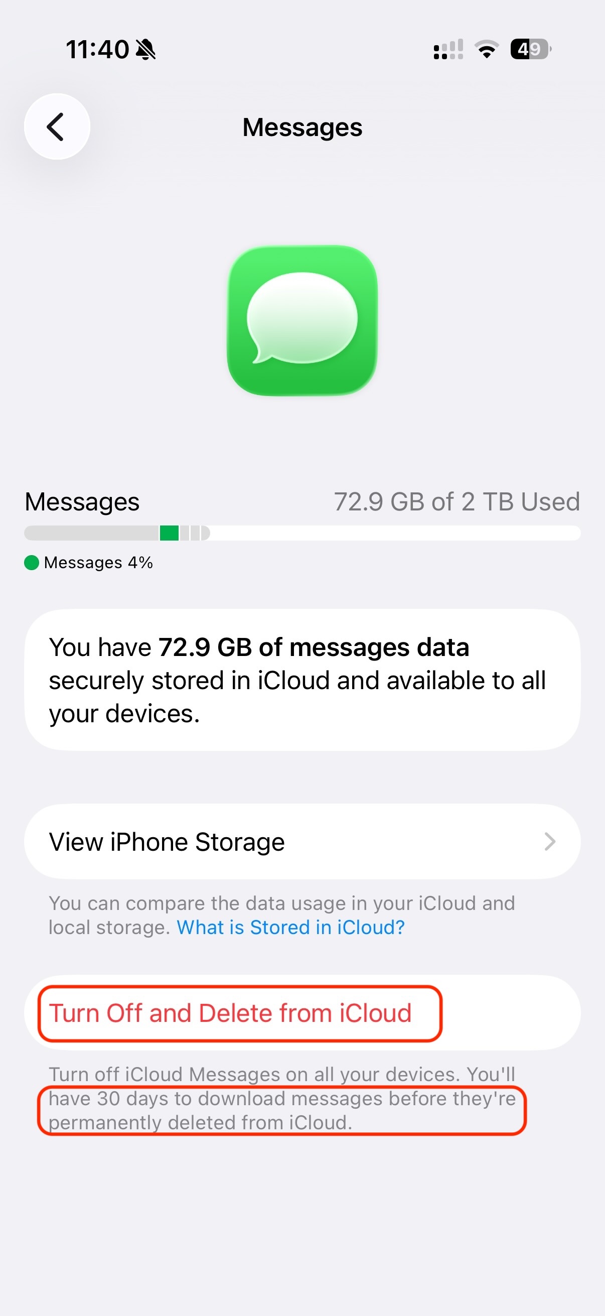

I was thinking something similar. I have 72GB which blows my mind since I don't keep many texts. Based on what I can find, if you go to Settings | iCloud | Messages | Manage Storage and select "Turn Off and Delete from iCloud" iCloud will download all of your messages from iCloud to your iPhone (assuming you have enough free space... in my case I need 72GB available). Once that is complete, your phone will have all your mom's messages and they will no longer be on iCloud. Delete all messages you do not want to keep. Then wait 30 days (otherwise iCloud will restore all the messages). After 30 days with only your mom's or other messages you choose to keep, you can turn iCloud back on and it will upload your iPhone messages back to iCloud and it should take up much less space. iCloud keeps every attachment, photo, emoji, genmoji, sticker, etc from every message so that's why it grows over time. I'm at 72.9GB right now even after permanently deleting the "Deleted Messages" from the Messages app. I'm going to give this "Turn Off and Delete from iCloud" setting, curate/delete messages once they are all downloaded to my phone, then wait 30 days and then re-enable iCloud Messages sync and see if that shrinks the iCloud size for Messages. I think this is the way to do it.

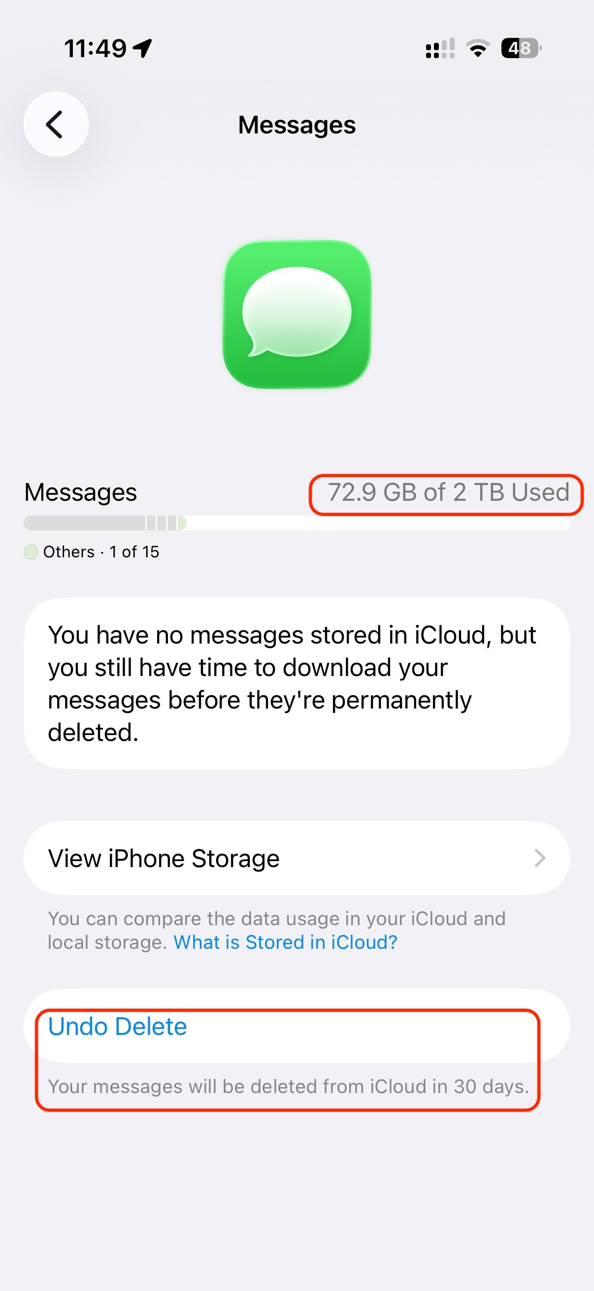

Ok, I just did it. Here's the current status in settings for the next 30 days. It still says 72.9GB so I guess I'll have to wait 30 days before it goes to zero. All of my messages are still in Messages on the iPhone so nothing disappeared from the phone when I turned off Messages. I'll check back in, in 30 days, and let you know how it goes.
Also it looks like I have to disable iCloud Messages on my Mac (and any other devices) to make sure iCloud deletes all messages. So be aware that all devices need to be logged out of iCloud Messages for the 30 day deletion to complete.

So unless someone knows of another process/workaround, I think the only way to "shrink" the iCloud Messages size is turn everything off for 30 days (like I show above) so a permanent delete is performed on iCloud. Then after 30 days, enable iCloud Messages and it will sync whatever is on your iPhone/Mac back to iCloud. If you've deleted everything from your iPhone except your mom's texts and also make sure to permanently empty/delete "Deleted Messages" in the Messages app, then when you re-enable iCloud Messages after 30 days, it should only have your mom's texts in iCloud.
I'm going to be curious how much I can shrink my iCloud Messages with the above process. I've set a reminder for August 3. I will re-enable at that time and see how much smaller my messages are than current (72.9GB). I only have about 50 recent family texts on my iPhone at the moment, so there's no way they should take up 72.9GB.

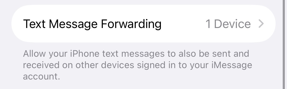

If you turn off icloud does it stop messages from my iphone coming in on my Mac.
I thought the same thing at first but they are unrelated features. The iCloud sync saves your messages in iCloud so they can be restored to a new device (or if you factory reset your current phone for some reason and iCloud will restore your messages). What you are asking is the Text Message Forwarding that is a setting in the Messages settings on your iPhone. I turned off iCloud Messages for 30-days (see above - will turn back on August 3) and my iPhone and MacBook Pro are both still receiving new messages.
P.S. Just to be clear, if you turn off iCloud Message sync, text message forwarding to your Mac will still work. But if you mean (I don’t think you meant this but just in case) log out of iCloud completely then no, it won’t work. iPhone and Mac (and iPad etc) all need to be signed in with the same Apple ID for forwarding to work. But it does not rely on the iCloud Messages sync feature.

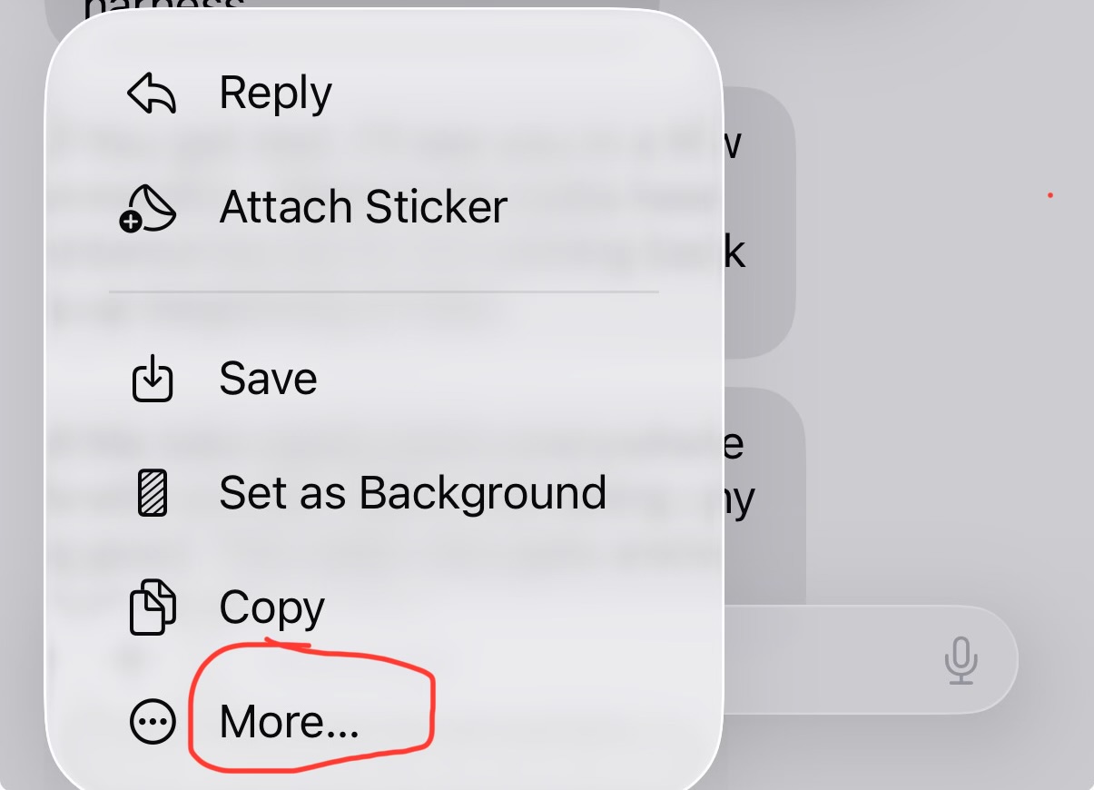

It would be nice if there were more options for automatically deleting old pictures and videos sent in Messages. I would like to preserve old text messages, but not the pictures since they take up so much space.
You probably already know the manual option since you mention “automatically deleting” but thought I’d post a reminder for others. Just press and hold the attachment or photo, when the menu pops up select “More” then you can select the attachment or photo and delete it while still keeping the text. It’s a pain and not automatic but will help keep storage down.
