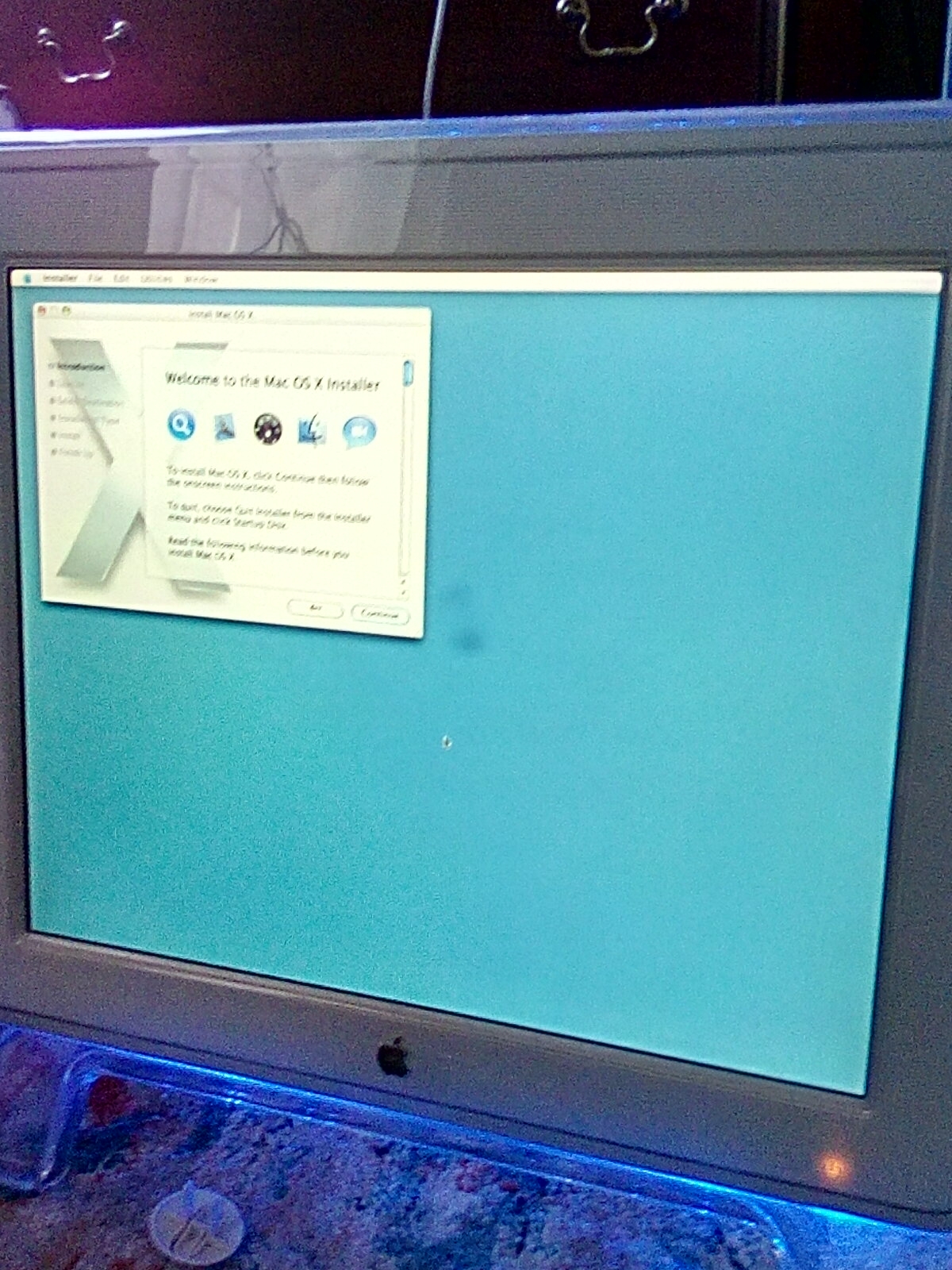

I don't know what happened. When I booted the Mac from the DVD, it didn't panic, it worked. here's a photo of the 10.4 installer. It said it wouldn't install because I had Leopard, so I clicked Archive current OS and install Tiger. This worked, but I didn't dual boot because my HDD only had 12GB left.

Might be simpler/safer to just find an old HDD to put in the tower?
I think to partition that drive you’ll want to boot from an installer disc and use Disk Utility. I think that should work but my memory of the capabilities of older versions is… fading ;-)
This is what I'd do as well. Keep Leopard on the 80gb drive and add a 2nd hdd and install Tiger to that. You can format the new drive to APM/extended via diskutility on the tiger disk (or from the leopard installation) and then install. 1.2.3 done. Best of luck to you.
