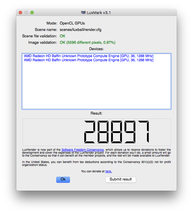

Here is the LuxMark score I got after plugging in my monitor cable (DP) into the second card (2nd 16x pcie lane):
I'm rather surprised by this score as I usually get a score around 22K, never gotten close to 28K.
Setup:
macOs: 10.12.4
2009 Mac Pro
Dual Xeon X5960
2x XFX RX480 8GB (OC)
Reactions: theitsage
That's very good to see. The improved performance is most likely due to CUs unlock.

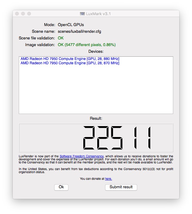

I believe the RX480 can do much better. If only 22K, my 7950s can also deliver that without any issue. 28K is faster, but isn't the RX480 have ~2x processing power of the 7950? Anyway, it's good to hear that the XFX card can work on your cMP.
V3 10.11.4 b5 50:50.jpg
A single R9 Fury does about 19000. I wouldn't expect two to be twice as fast, and understand that the RX 480 is a slower chip with a focus on performance per watt rather than overall grunt. 28800 doesn't seem bad at all in that perspective!
