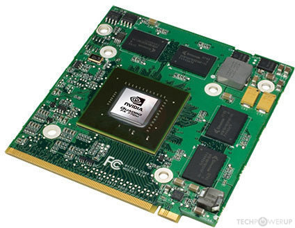

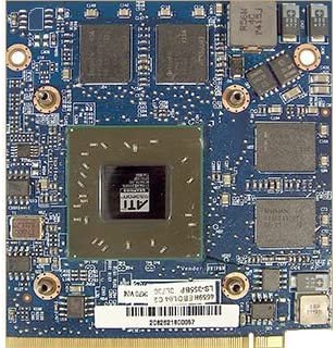

Are you sure? There are macOS drivers for this card, and it uses the same MXM III (HE) form factor, and the way the pins are arranged are the exact same. The RAM chips are also aligned exactly like the 2600. It also uses the same G96 CPU that the 9600M GT uses, except this one doesn't fail.
Below is an image of both the cards, except the particular card I'm looking at has a slightly different layout as the RAM chips are rotated 90 degrees to match the layout of the 2600.

If you don't believe, just buy some cards and try it yourself. You may open a new approach for upgrading Core 2 Duo iMac, whether or not they are worth upgrading.

If you did try this, please report back with the results, positive or negative. Having recently acquired an early 2008 iMac8,1 myself (given away because of one single column of dead pixels), I am also looking for ways to make it more useful.
