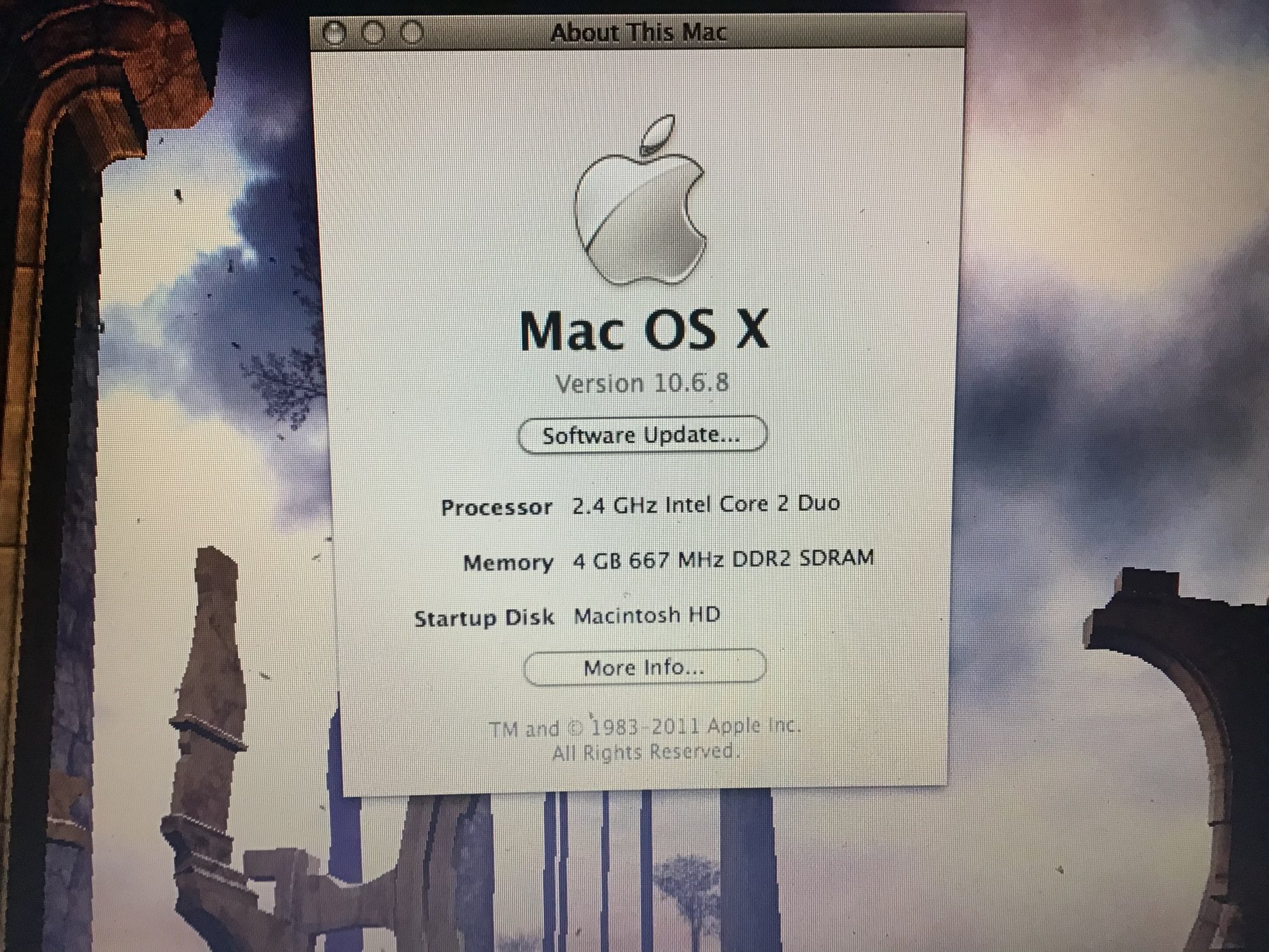

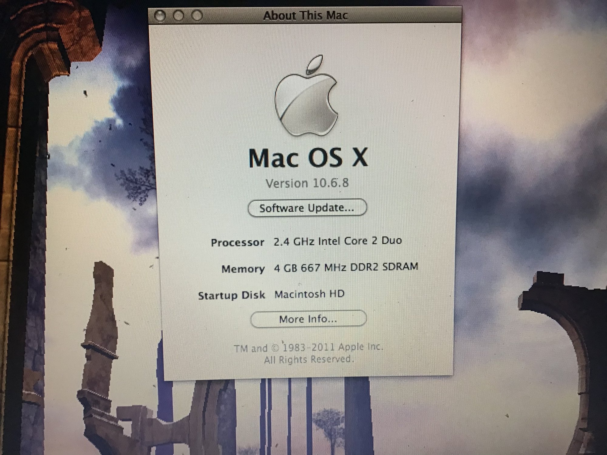

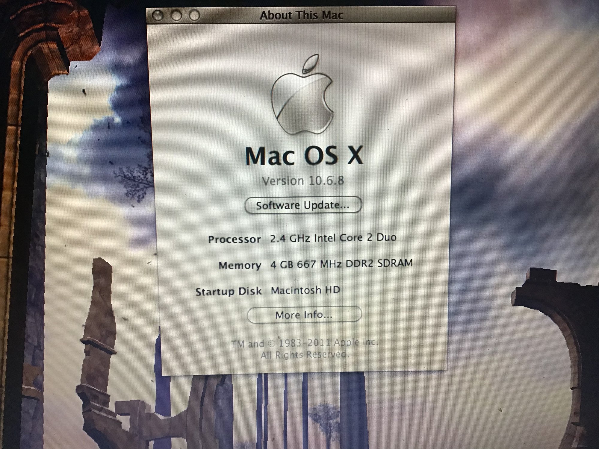

So I just checked, because I figured I bought the multi-pack version of SL for a reason. My ancient 2008 black MBP is, in fact, running SL 10.6.8 :rolleyes:😂. So now I'm looking into what options are available to me from that end. Stay tuned, or jump in if anyone has fresh ideas!
Connect the 2011 MBP to the 2008 MBP via FireWire, put the 2011 MBP in Target Disk Mode and clone the 2008's Snow Leopard installation to the 2011 MBP using e.g. Carbon Copy Cloner, SuperDuper! or even Disk Utility's "Restore" function (but IIRC the latter only works if the target drive is at least as big as the source drive).
