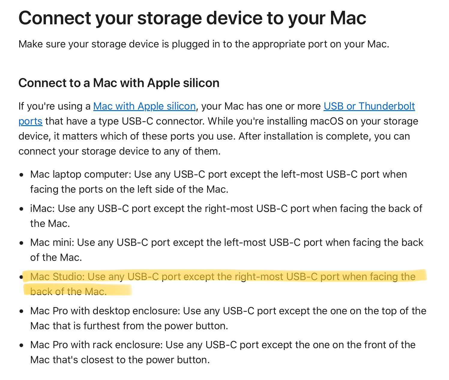

Does anyone know why the 4th USB-C port (right hand) should not be used for a boot drive...?
I currently have my Lacie SSD connected (which is data only), with no issues.
This also shows up as a destination to install MacOS from Recovery screen if desired......🤔
Fishrrman
macrumors Penryn
Feb 20, 2009
28,448
12,566
OP:
I believe the information you've posted in reply 13 above pertains ONLY to the use of Apple Configurator 2.
AC2 requires that "the target Mac" be connected to by way of specific ports (i.e., you can use certain ones, but not others).
This doesn't have anything to do with booting the Mac from an external boot drive.
Reactions: b17777 and MarkC426
