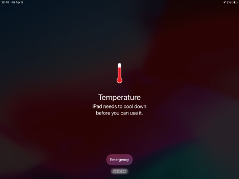

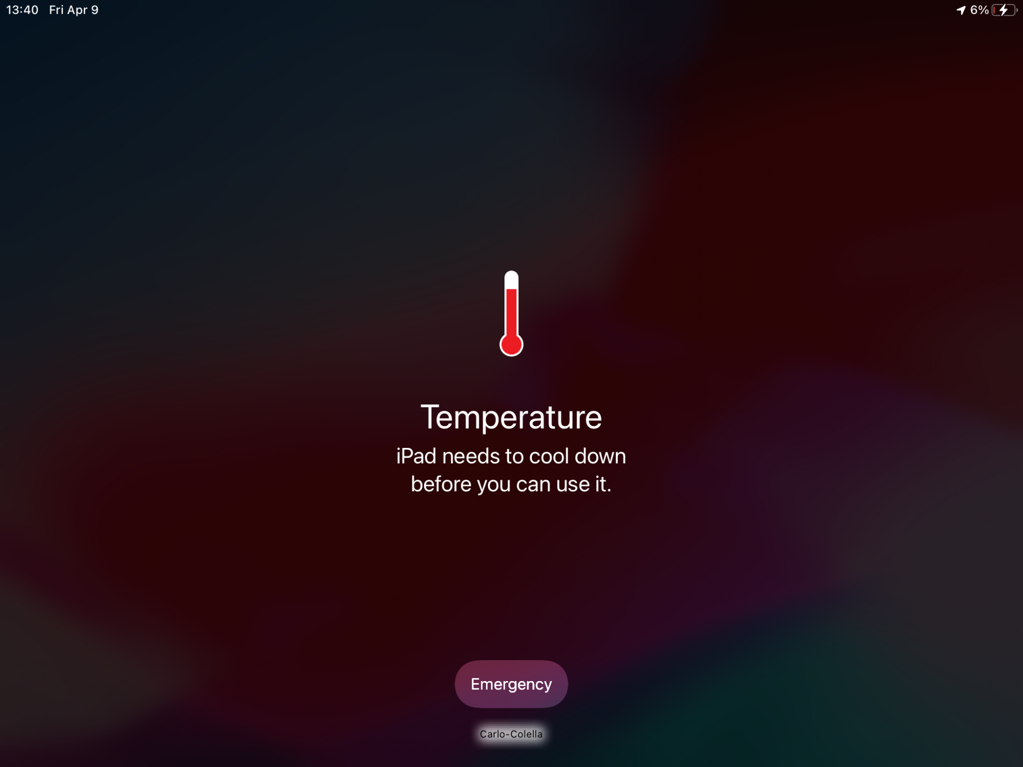

My iPad got to 43.8 degrees! I was playing a high-graphics game and had the brightness on max. It was also a 76 degree day with a UV index of 7
I guess. I even saw the overheating screen.
