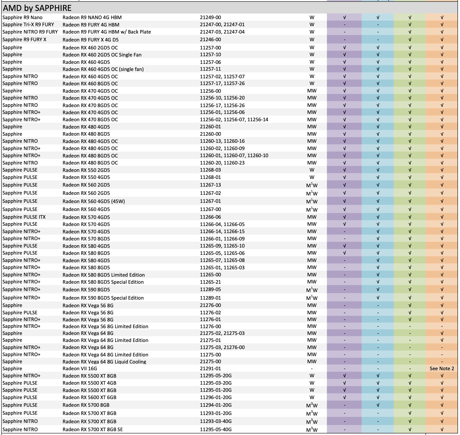

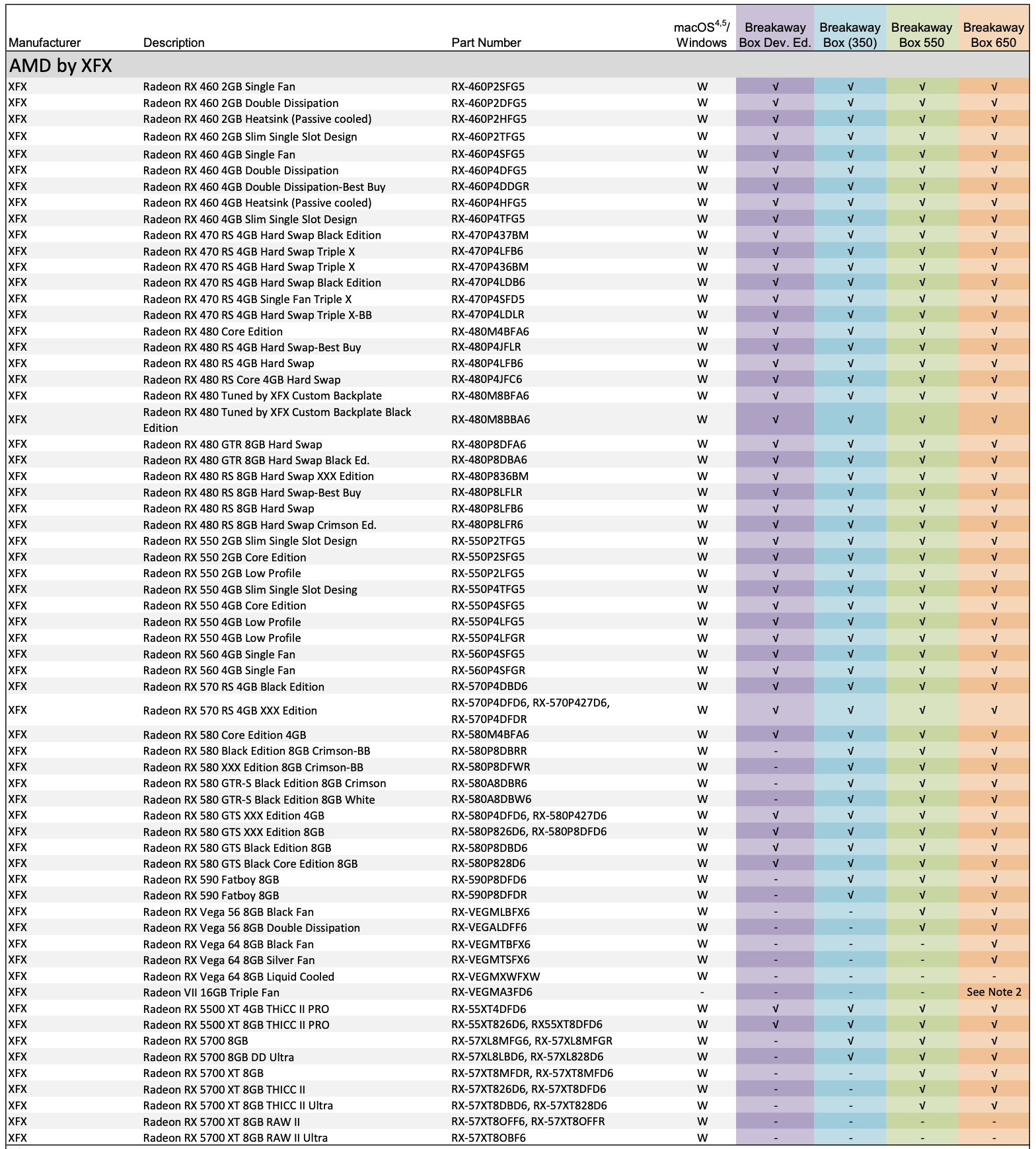

XFX GPUs have known issues with macOS and are NOT recommended over other manufacturers. That is the reason Sonnet will not certify ANY XFX GPU for use with their eGPUs in macOS. See page 7:
I looked at that chart and I can't figure out where you are getting your info about XFX and eGPU's.
I have two XFX Radeon VII's. There may be problems that I am not noticing, but they work.
PAGE 7.
Not a single XFX GPU is listed as MAC compatible. First column would have an M/W for Mac/Windows. All XFX are W only, aka Windows only. Then look at a vendor like Sapphire who nearly all their GPUs with Mac drivers are Mac compatible.
Again, these are for eGPU but the same applies to macOS across the board. It is an excellent reference for all Mac-based GPUs.

PAGE 7.
View attachment 894903View attachment 894904
Please read that Note 2 carefully, same for all Radeon VII regardless brand.
