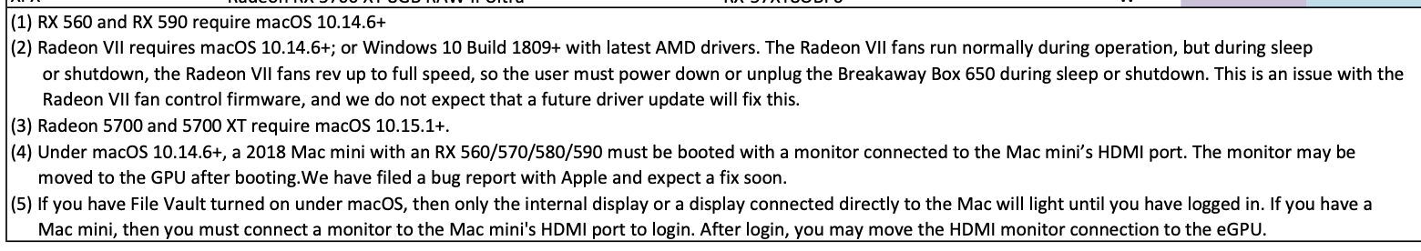

XFX cards ACROSS THE BOARD have compatibility issues with macOS. It's been well reported in this forum and many others. Radeon VII may be a different case (no manufacturer versions) but still would not recommend an XFX version over any other for macOS specific usage. As always, some people (yourself included) get XFX cards to work and others run into major issues.
Radeon VII has other issues and would personally not recommend using that particular GPU, especially if you're trying to troubleshoot an issue. The stock 580X config is where I'd start...
I have no objection about avoid XFX in general. However, OP was specifically asking about Radeon VII. I don't think we should make him has unnecessary confusion about "XFX Radeon VII may not work properly in macOS".
And that "other issues" is for that PCIe expander, not a general problem when use it on a cMP internally.
