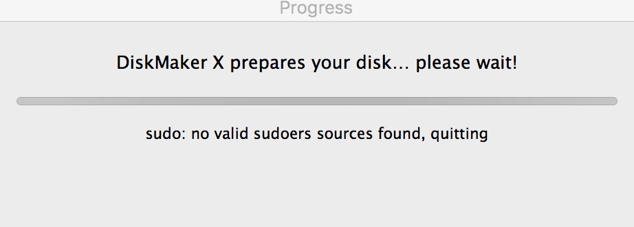

Can you please help me?
I use diskmakerx to make a bootable disk, I select the el capitan .app, but it seems to stuck and I do not know what is the problem.
Here is the error:

Re: sudo error: that's usually from a corrupt /etc/sudoers file (eg. syntax error in the file, or just totally messed up). Or, only admin account is in sudoers and you are running this from non-admin account? If editing the sudoers file, need to use the visudo command-line command. I would suggest to be VERY careful (read: know what you are doing) when messing with that file: might make a bad situation worse.
