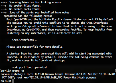

Could you please try building from https://github.com/barracuda156/macports-ports/commit/0a51b5c4b7ce0e0418455421b57b94abb7450b32
Or otherwise manually add these lines: https://github.com/OpenSMTPD/OpenSMTPD/pull/1247/files
UPD. It will be actually helpful to know if that works.
Thank you.
It built successfully on the G3:
Does it actually work btw?
I can verify the port load opensmtpd command completed successfully.
At the moment, that G3 is not set up to receive or send email, whether by a pine-like client or horde, or a GUI client like GyazMail, so beyond verifying it compiled/installed and loaded as a daemon with launchd, I haven’t test-driven its functionality as a server.

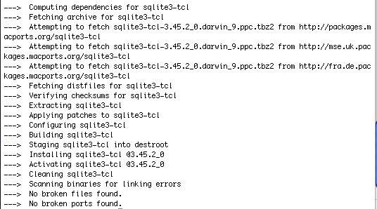

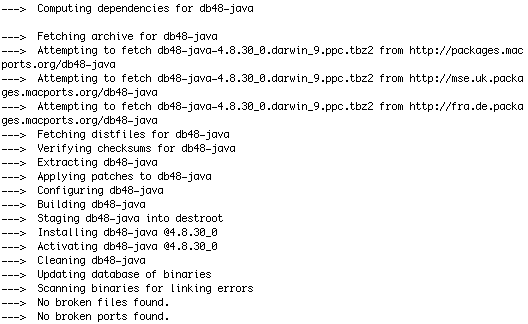

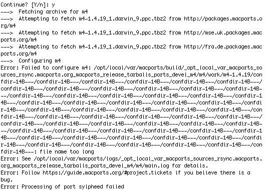

Has anyone tried this one?
Tried it once, and it failed:

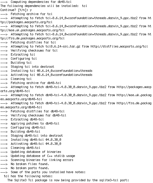

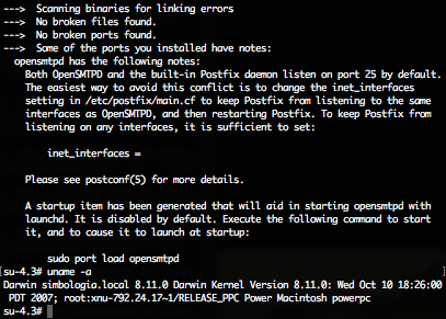

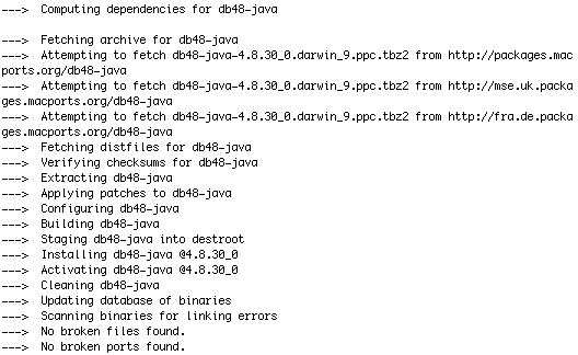

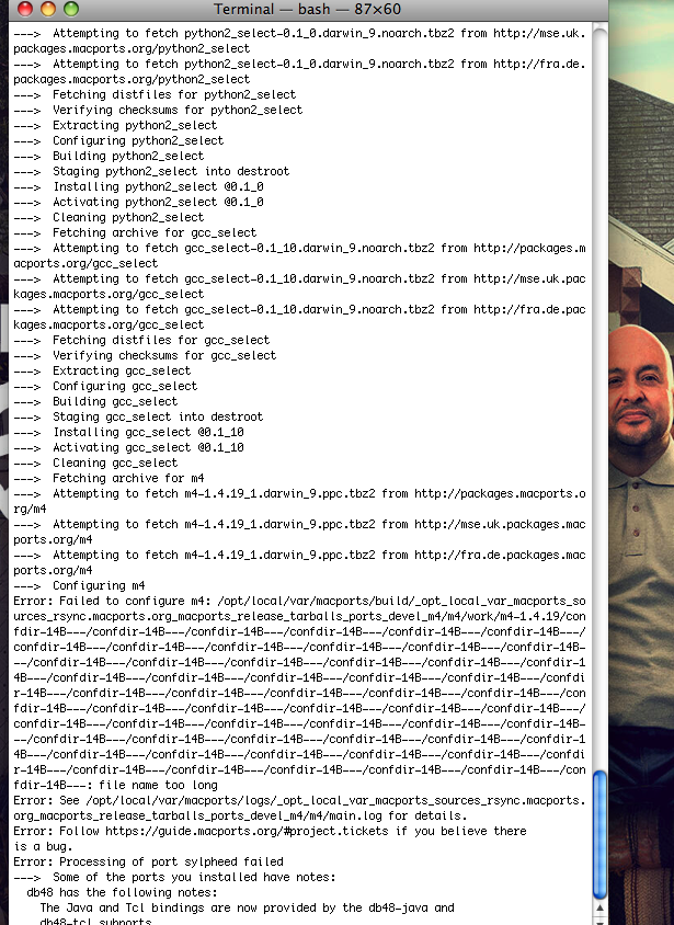

Then, I installed the suggestions:

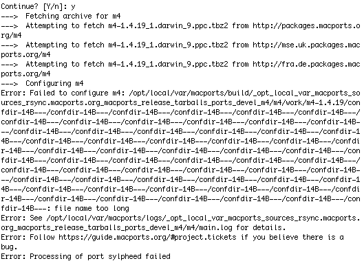

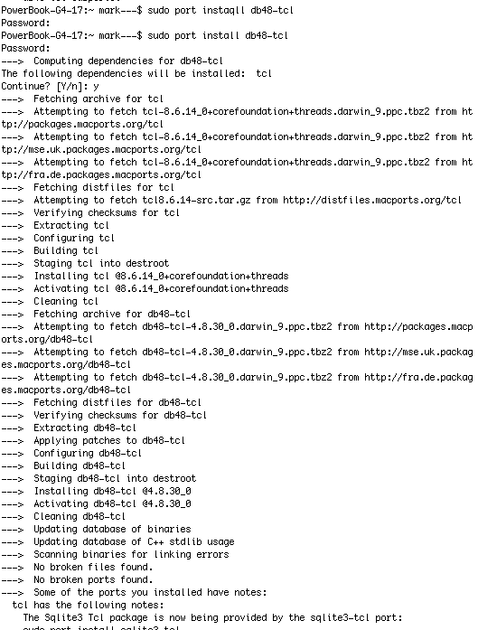

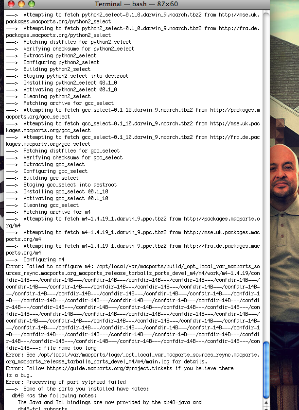

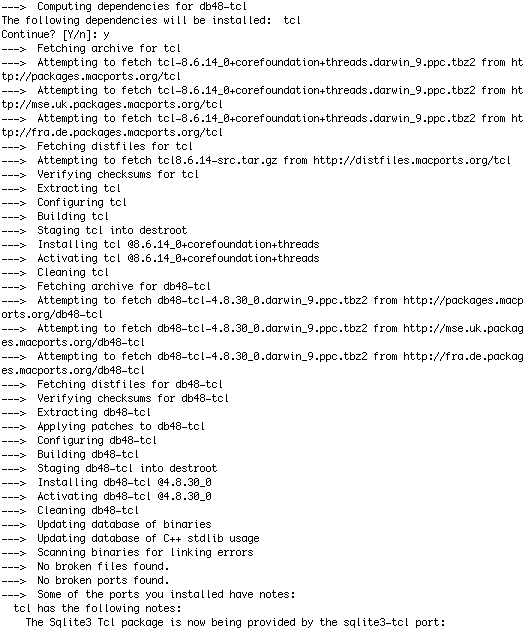

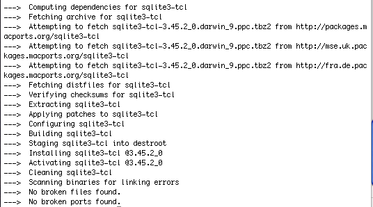

Then I went back to try and install it, and it didn't work again:

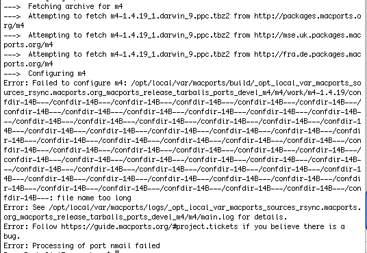

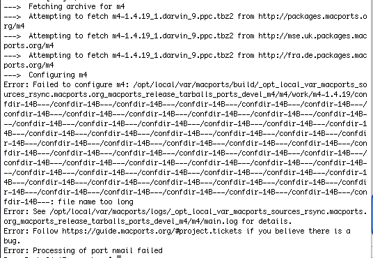

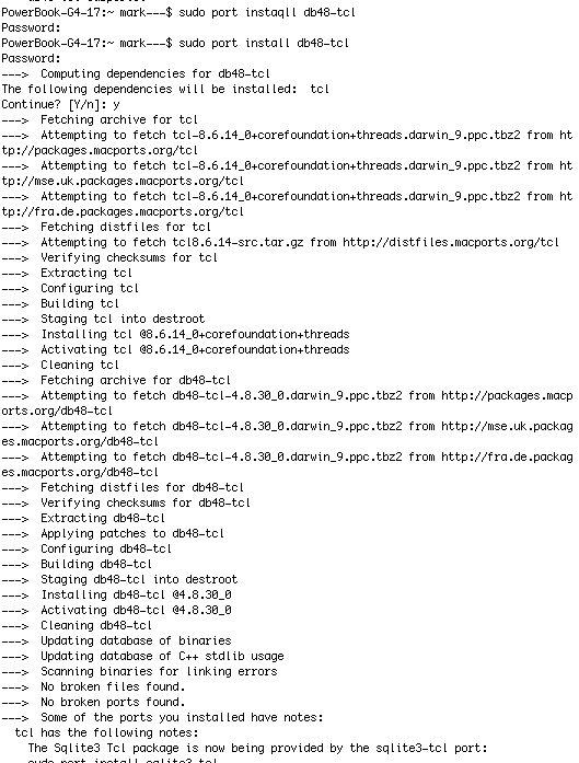

I also tried nmail again and it didn't work.
It seems like the "m4" port is the recurring issue in both builds failing. Do you have any ideas on how to solve this/any altnernative links/builds for it?

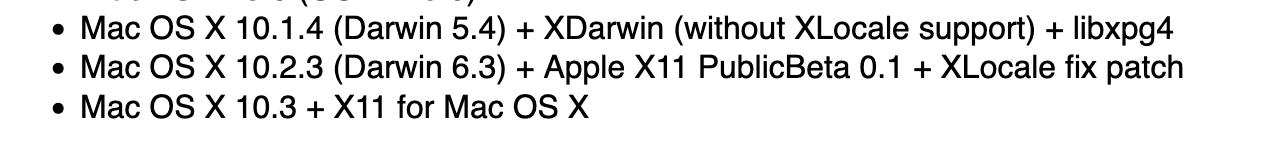

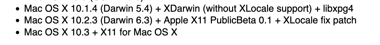

This is running on 10.5.8 on a 1.33 GHz Powerbook G4 17" with 2GB of RAM, but I looked at the "confirmed plaforms" page and it seems to have been running on older OS X versions:
But the page was last updated in November 2004. Is m4 out of date, or something? I'm just wondering because it seems like it hasn't been worked on in a long time. Thanks.

Could you please try the following: https://trac.macports.org/ticket/62994#comment:96
P. S. We are aware of the issue, just no one submits the patch…

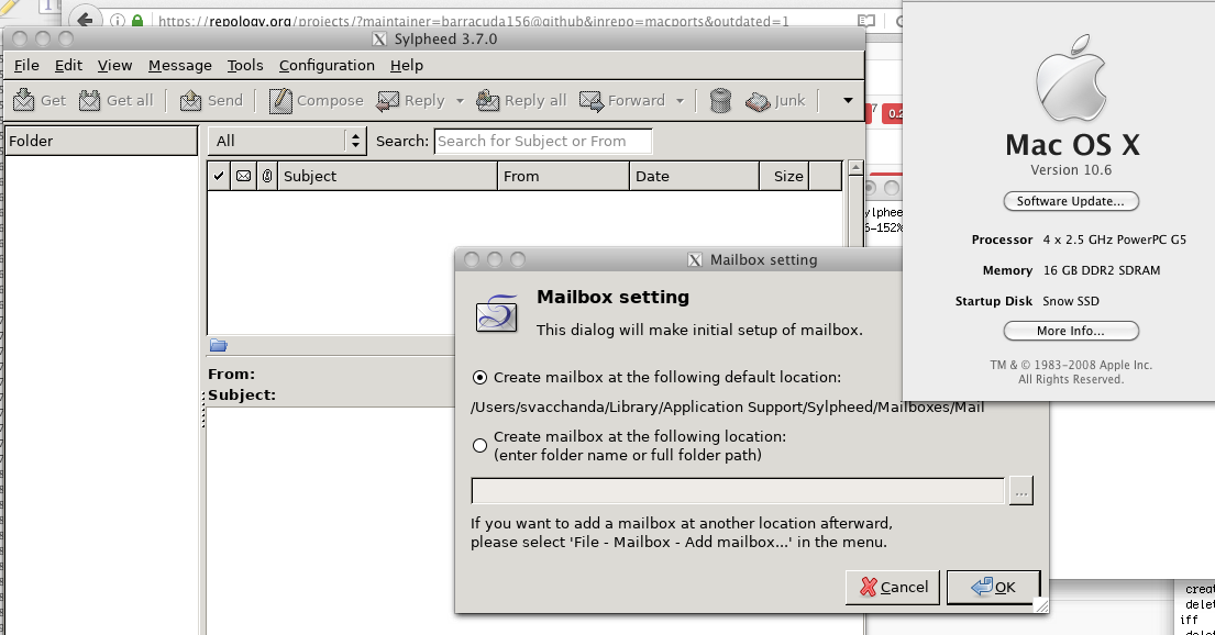

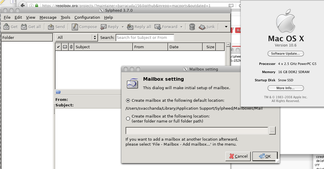

Excuse me.
Sylpheed builds, runs and crashes after launch with "extension randr missing on display" message in terminal. It shows 'create mailbox' dialog at this moment.
But there is a trick. Ports has xorg. After running it and placing in dock "applications" submenu appers. Sylpheed can be run from there.
I've noticed "rebuild folder tree" is necessary for imap, otherwise it doesn't get mail.
Ports xorg is 1.20.10. Sorbet xorg = 1.4.2-apple33.
Sylpheed builds from author's source via autogen.sh (libtoolize->glibtoolize), behaviour the same.
