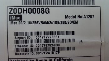

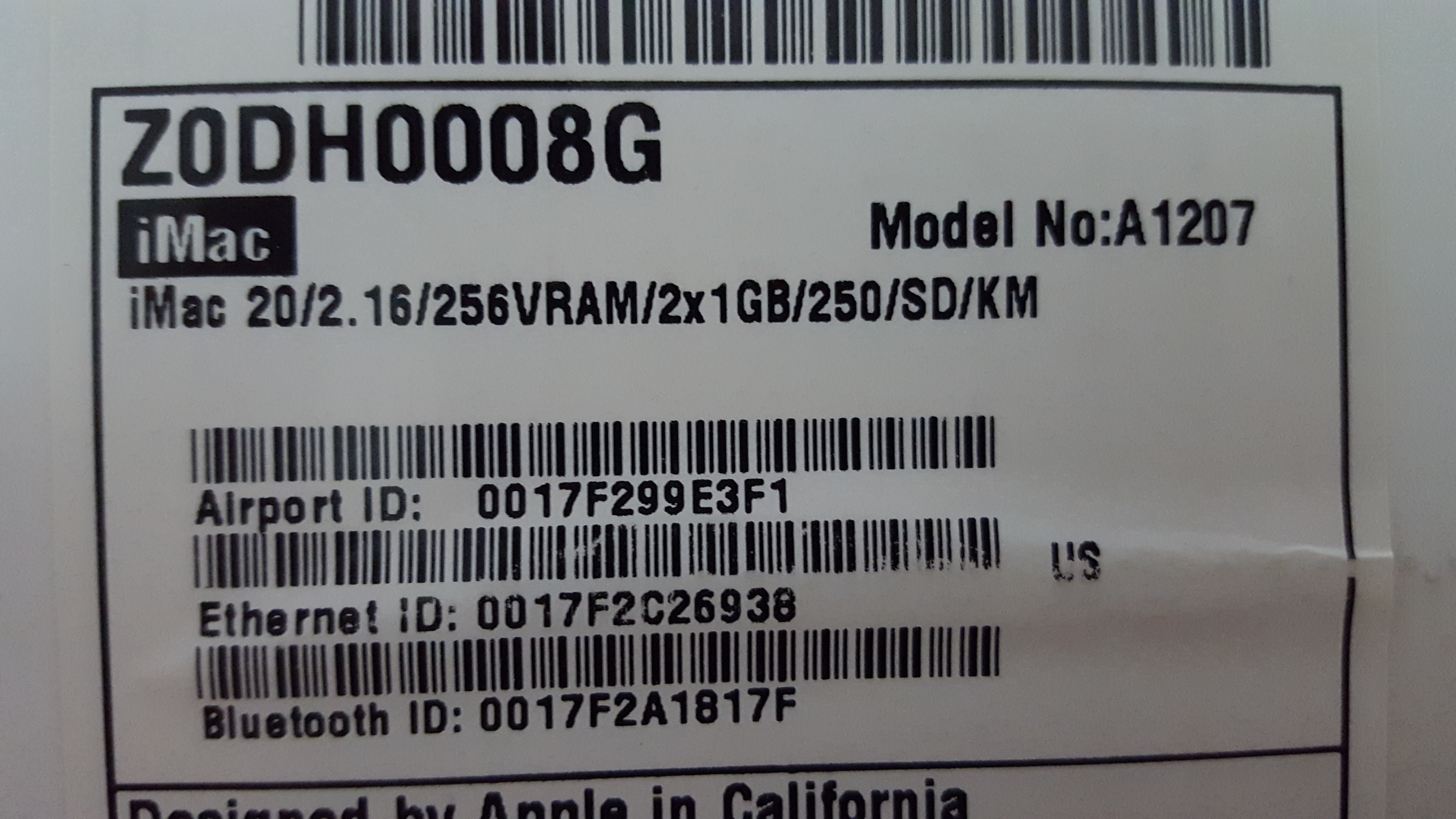

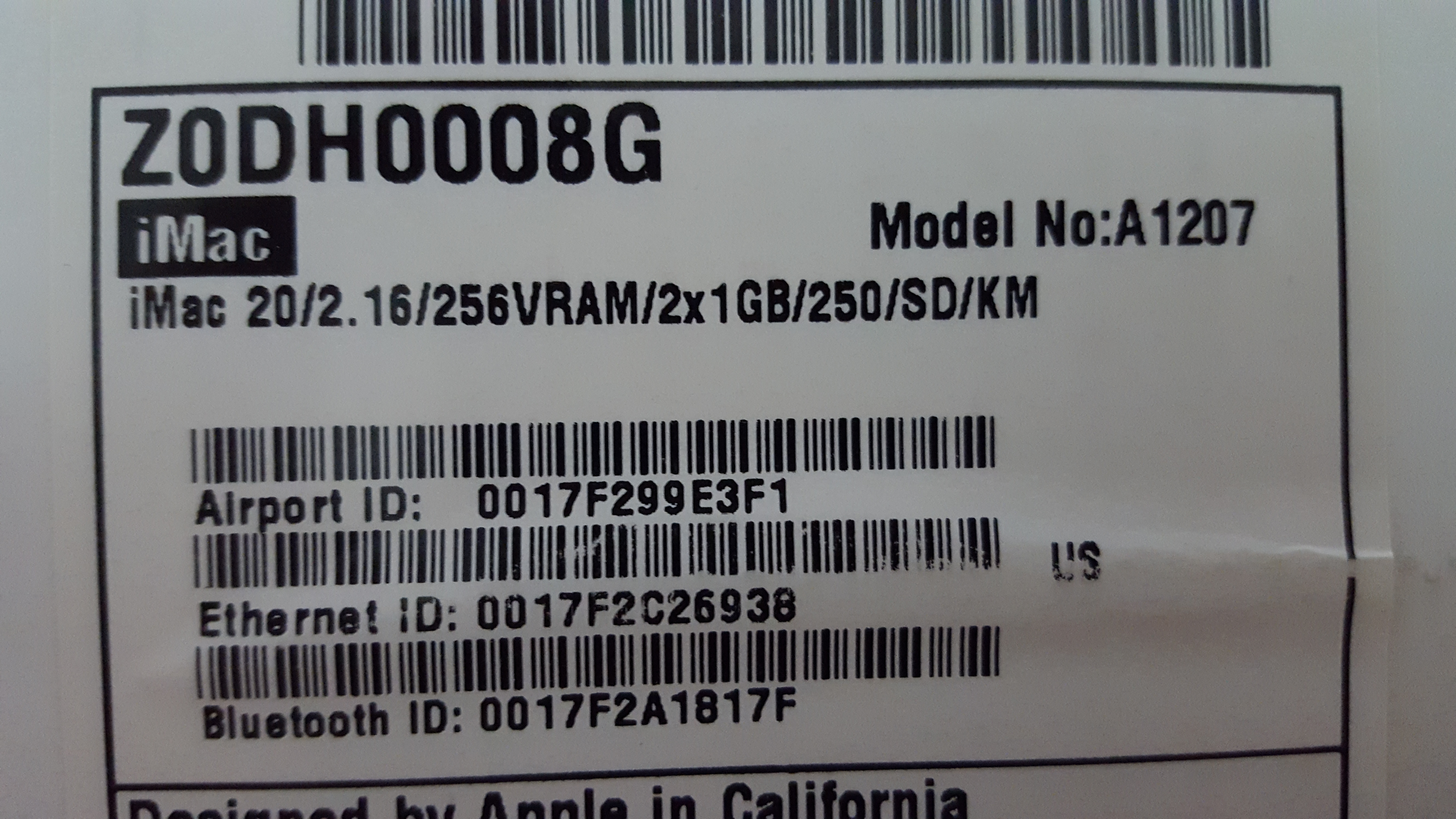

Some of those questions i cant answer, because my brother gave it to me, and he also received it as a gift before that, from a friend. It doesn't get used for much, i basically use it as video/movie watching pc for the kids, sometimes even for other easy/simple things. I took a picture of the box sticker, maybe that helps you. I dont know if im missing something from the installer usb. As i said, i downloaded it online (torrent) and wanted to start the pc up with it. Do i need anything else?

You have a Late 2006 20" iMac. You can use OS 10.4.8 through 10.7.5.
The maximum OS it can use is Lion (10.7.5). You can still purchase Lion from Apple, they will email you a code that will allow you download the installer app from the Apple App Store. You will need a Apple ID, access to another Mac to download the Lion installer app ("Install OS X Lion" app to the Applications folder), and to create a bootable USB Lion installer.
A simpler solution might be to purchase a bootable USB Lion installer from Amazon or eBay.
Another alternative OS is to install Snow Leopard (10.6). It can be purchased from Apple. Apple will ship you a bootable install DVD (you will need a working internal DVD drive). You can boot from the DVD and install Snow Leopard (10.6.3 on DVD, can be updated to 10.6.8 after the install). Once you have a working iMac, you can purchase and install Lion from Apple if you want.
