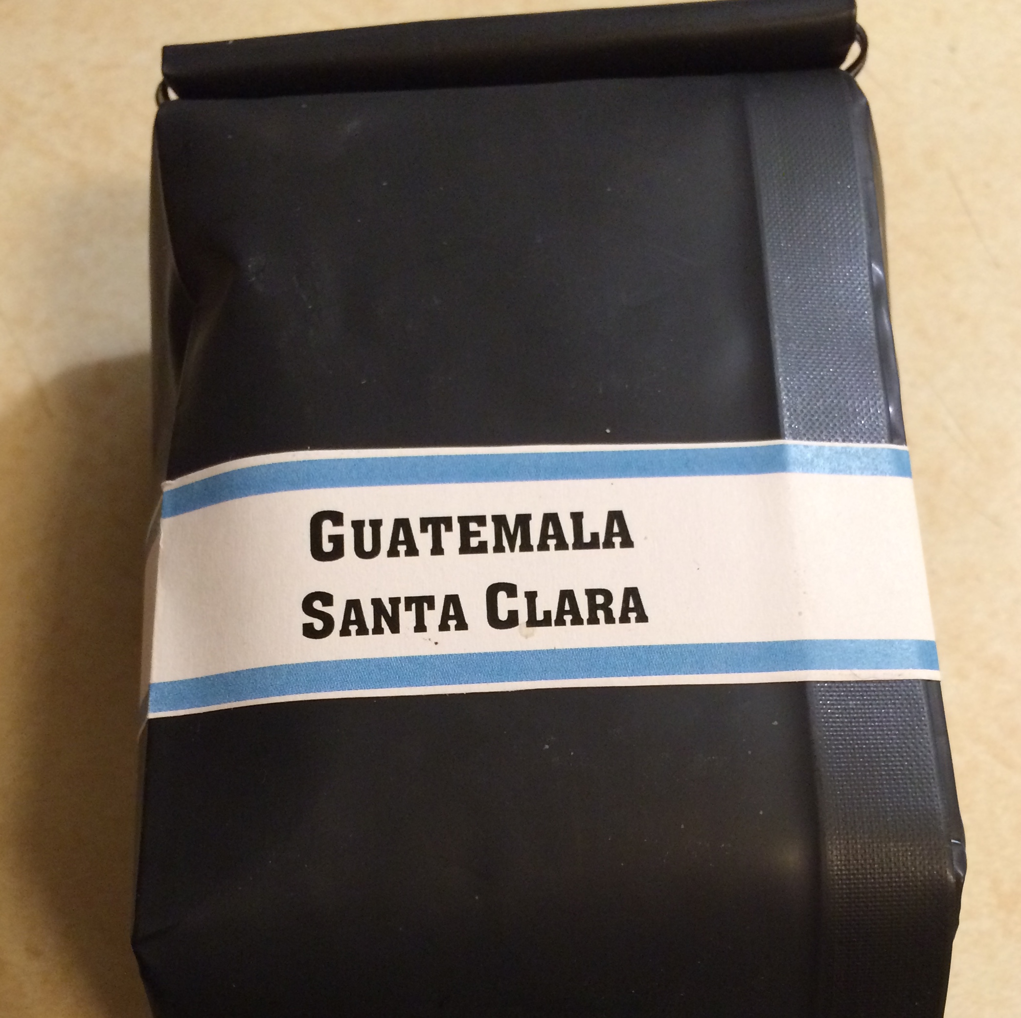

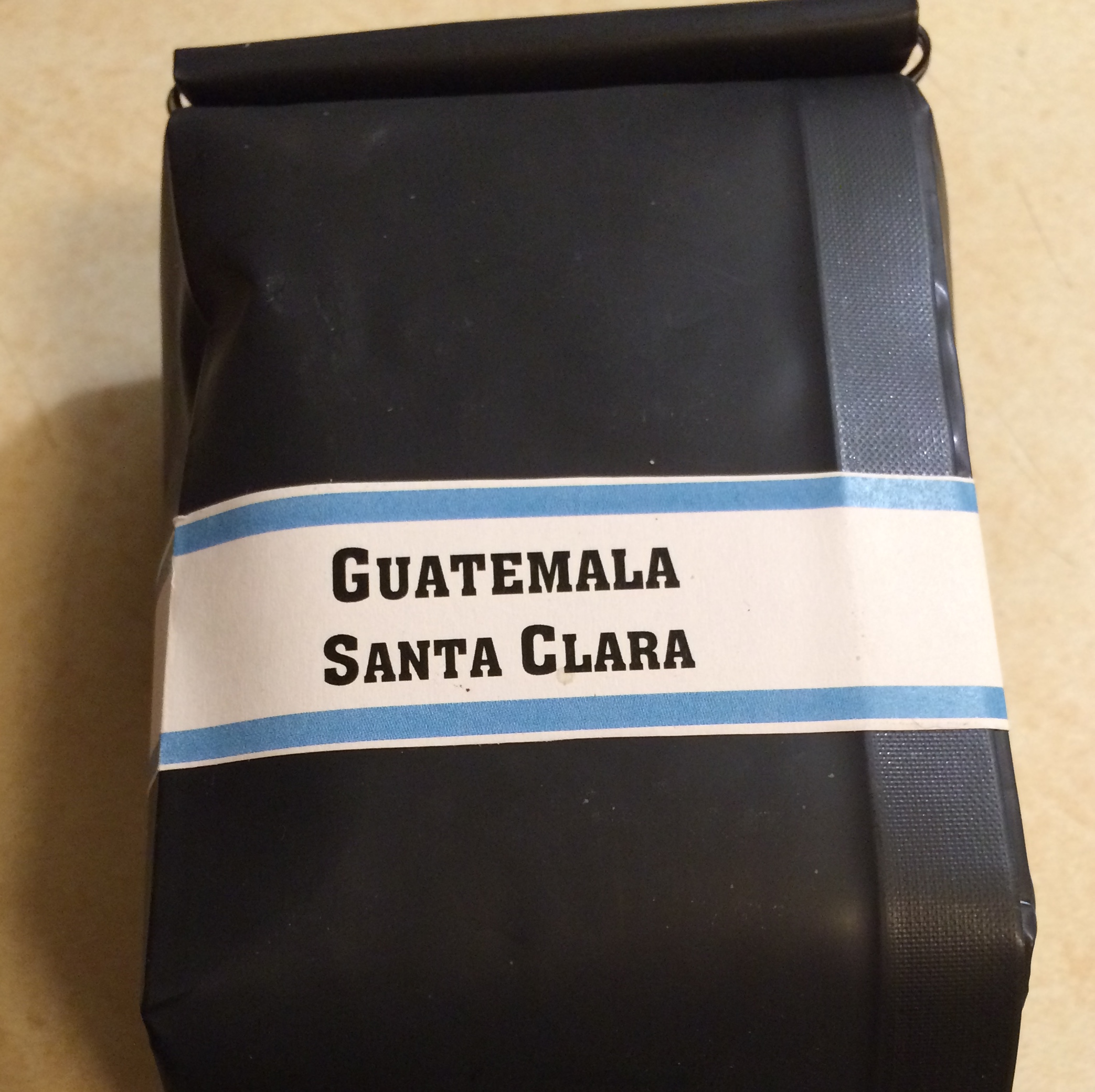

I made another trip to my local coffee roaster today for a fresh batch of beans and a cafe mocha while there.
They have three different kinds of SO beans and this is the second one I've tried now. It smells and tastes terrific with a nutty/chocolatey taste. Very good.
