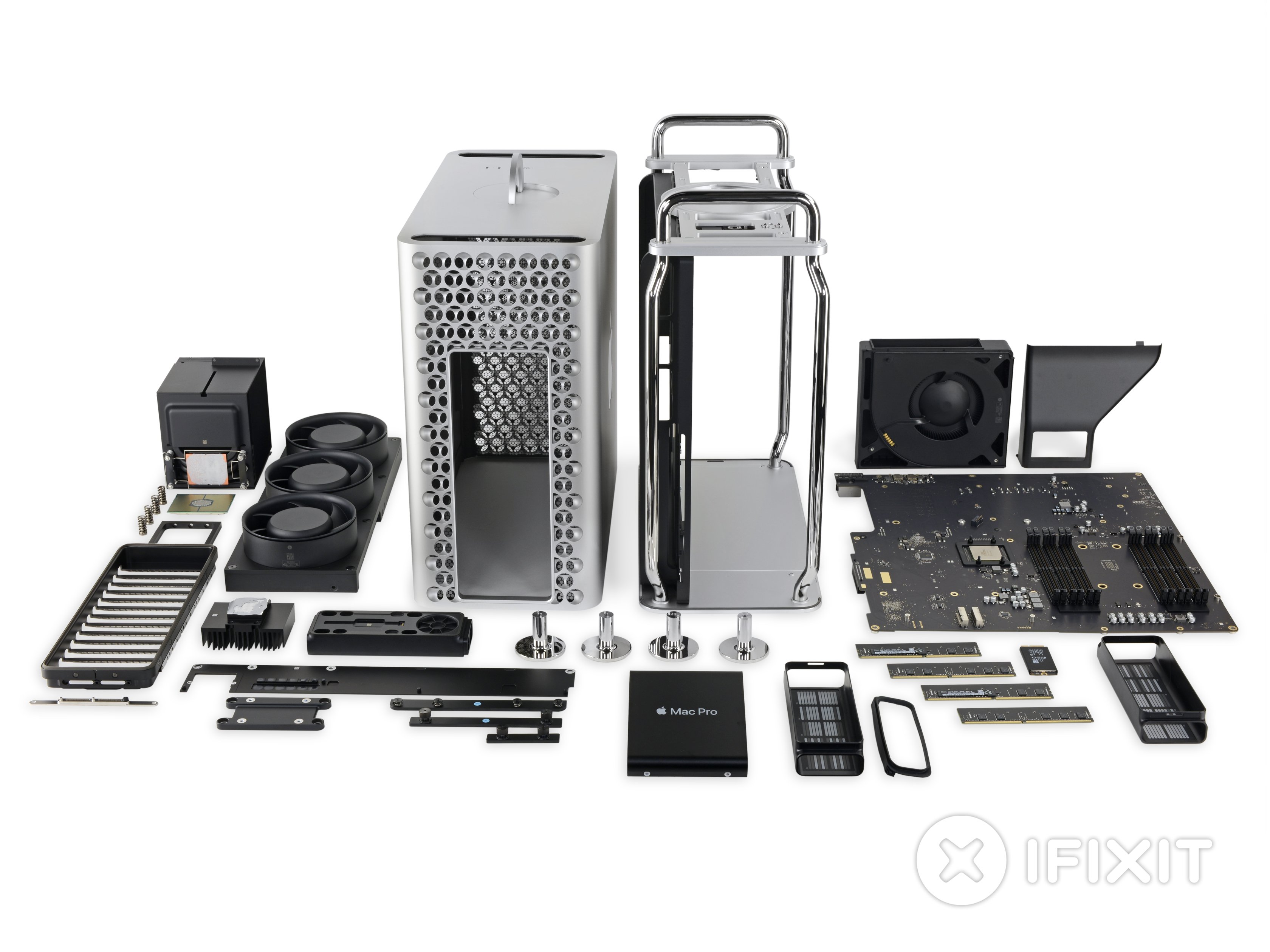

in fact, the NICs in the 2019 Mac Pro are similar to the one in Mac mini 2018. according to the ifixit teardown Apple uses 2x aQuantia AQtion AQC107-B1-C multi-gigabit ethernet controllers. maybe Apple uses a newer revision of the controller. I'd expect that the latest AQC107 drivers from Aquantia will support the NICs of Mac Pro 2019...
Ah, that's good to know. I knew there was a teardown but was on mobile and was going to look at the system later but figure a support bundle could be useful. If its AQC-based, then I think its worth giving the current driver a try @CNDCodewarrior. I know they've had a few updates since publishing.

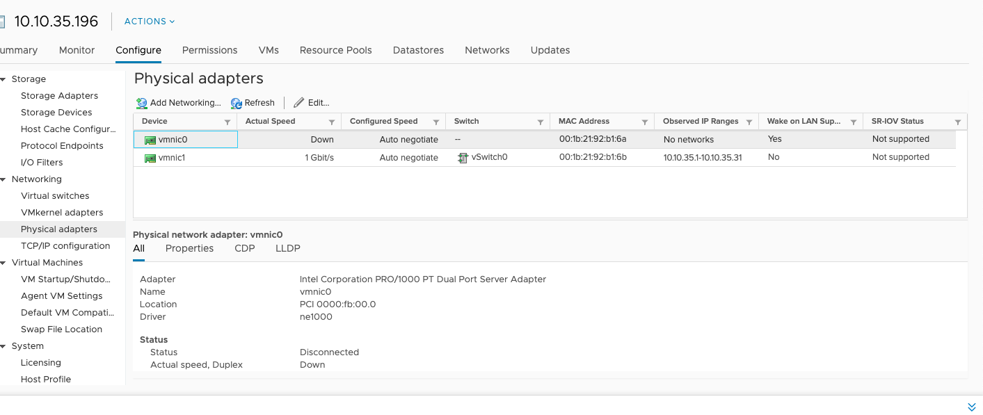

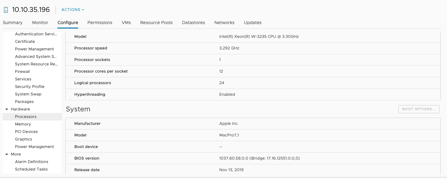

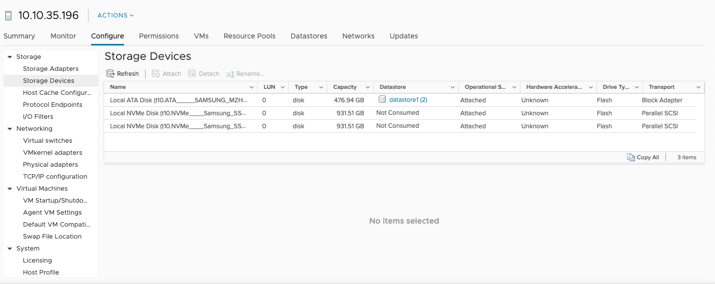

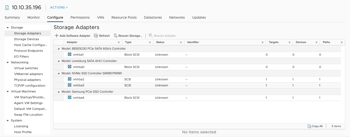

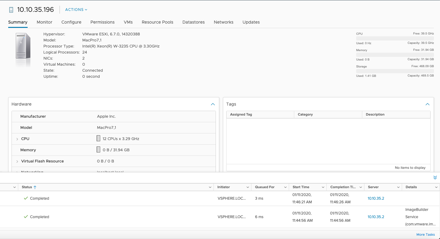

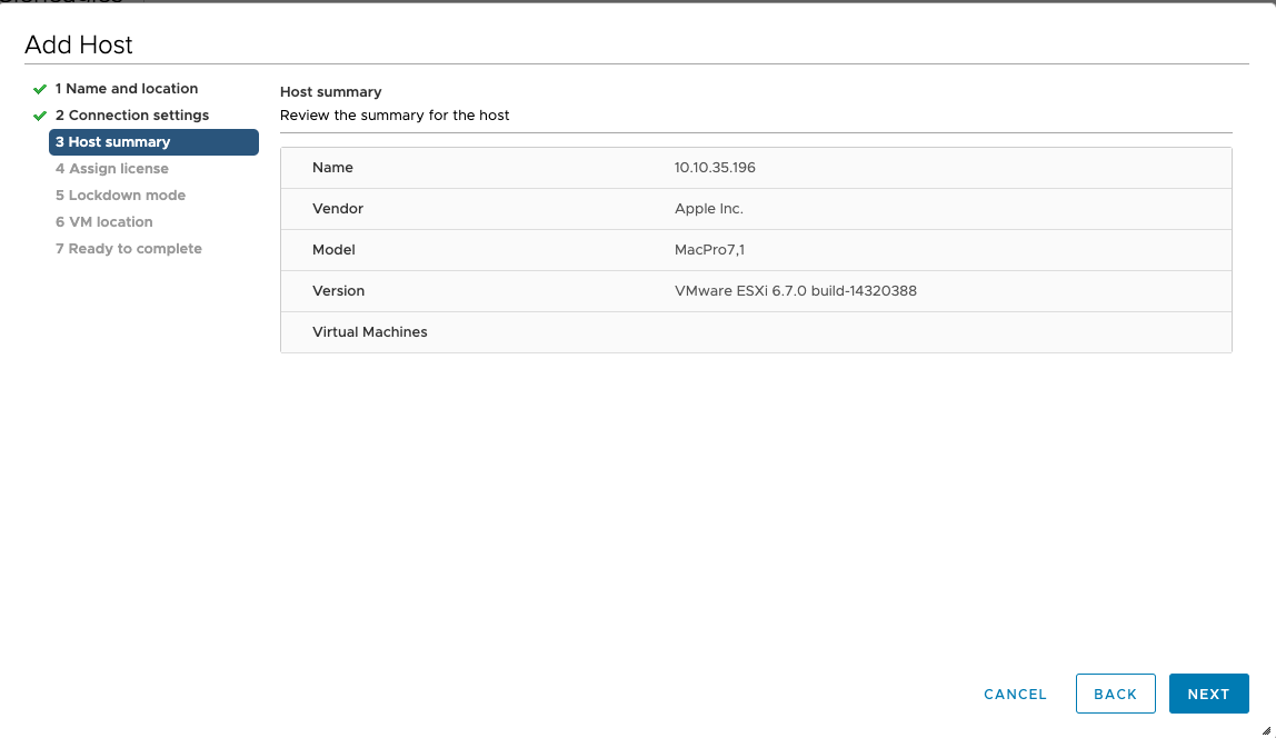

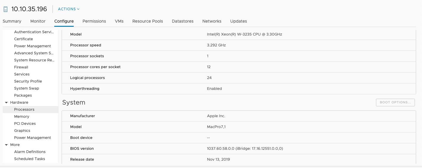

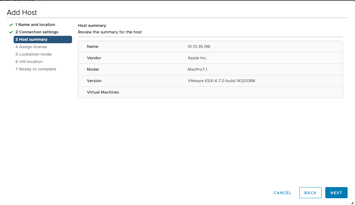

Ok so got ESXi 6.7 update 3 installed on the pro using an intel nic.
Install went normally, it saw one of my internal PCIE cards for the install and it saw the 2 cards on my highpoint raid card (Raid not supported)

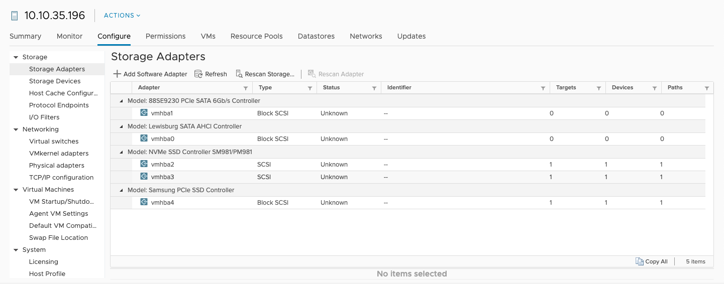

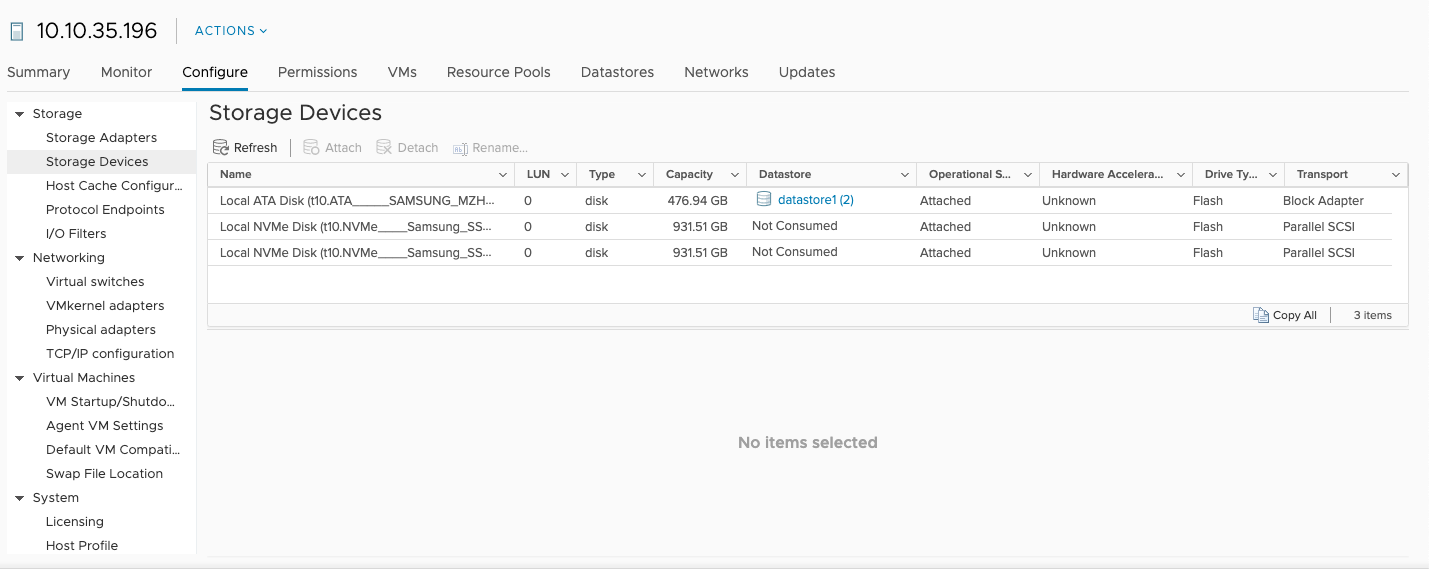

Here's the storage adaptors list

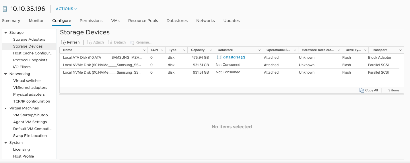

Local storage

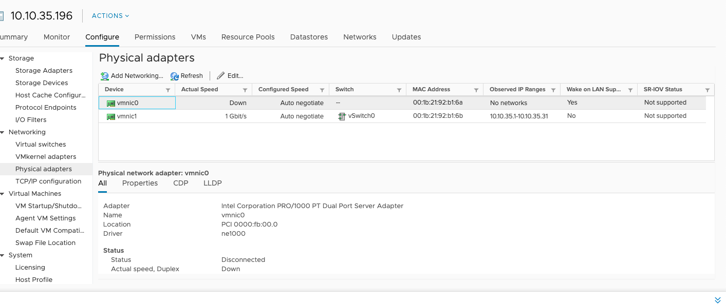

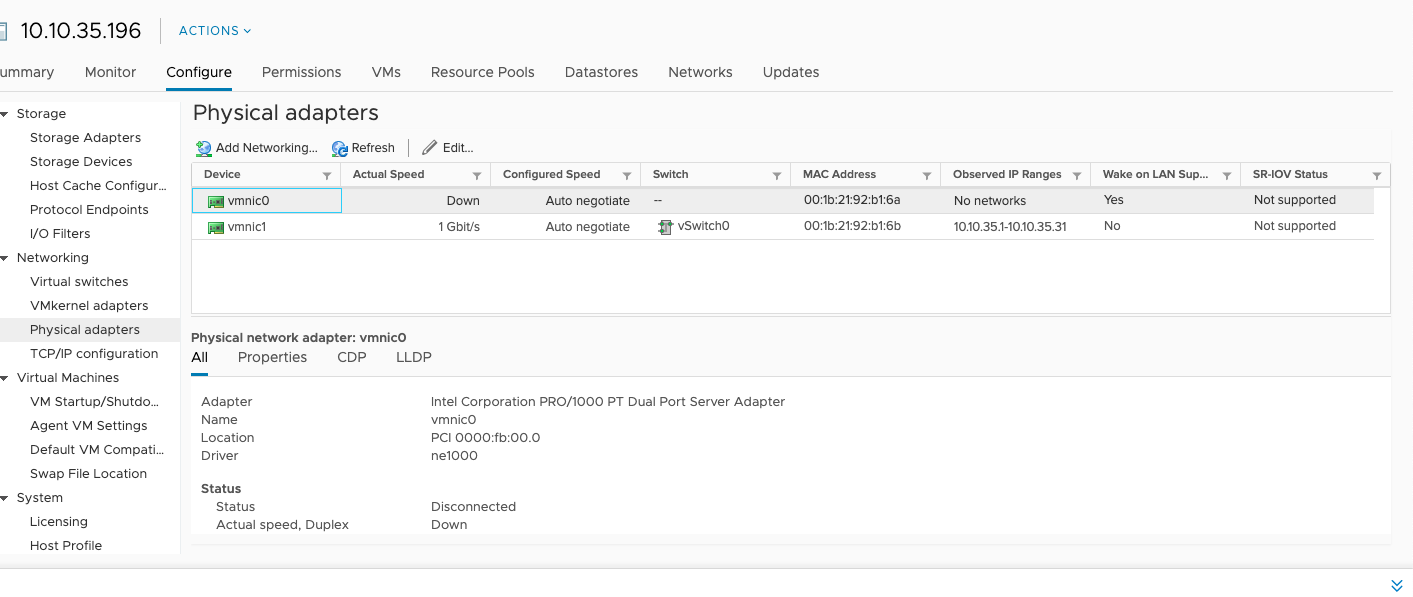

The intel nic's

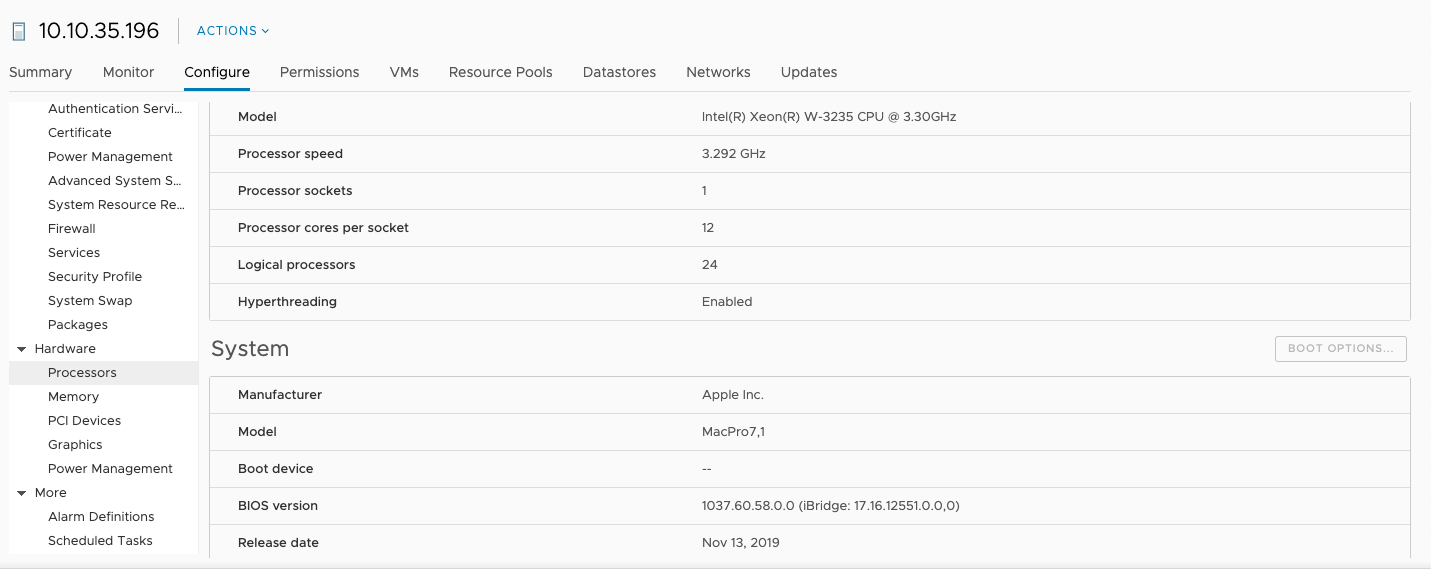

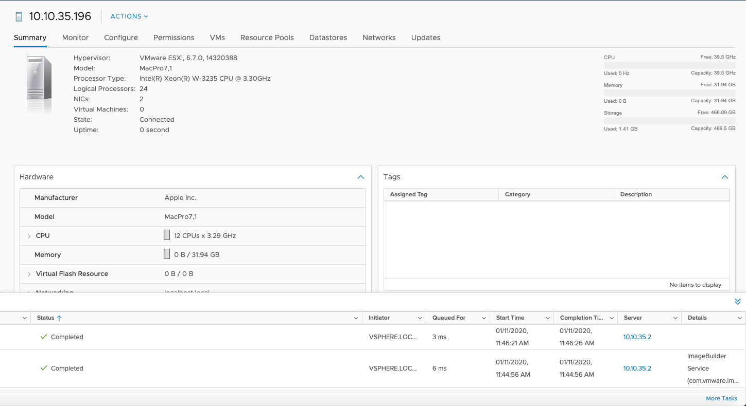

And just general info
So as expected no internal apple storage is visible, the built in nic's don't have drivers as expected. But if you have a storage card that is supported by vmware you will be able to install it and you would be able to install any NIC's you needed to get communications working.
Generated the support file and sent it to @lamw
Hope this helps folks!

Just a basic 2 port 1gig card, sorry don't have the exact model as it's still in the pro and the baby's sleeping right now so can't take it apart.
Type: Ethernet Controller
Bus: PCI
Vendor ID: 0x8086
Device ID: 0x105e
Subsystem Vendor ID: 0x8086
Subsystem ID: 0x115e
Revision ID: 0x0006
Link Width: x4
BSD name: en12
Kext name: AppleIntel8254XEthernet.kext
Location: /System/Library/Extensions/IONetworkingFamily.kext/Contents/PlugIns/AppleIntel8254XEthernet.kext
Version: 3.1.5
Drivers are loaded for it in OS X too.
But anything that has drivers for ESXi will work with it.

Thanks to @CNDCodewarrior and couple other customers, we found that the built-in NICs aren't automatically recognized by ESXi, however once you incorporate the Aquantia ESXi Driver (which you can search on my blog "Aquantia 10GbE ESXi Driver for Apple 2018 Mac Mini", then ESXi will pickup those NICs. I've shared these finding on my blog as several other customers have asked and will use that to maintain latest news/updates.
