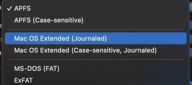

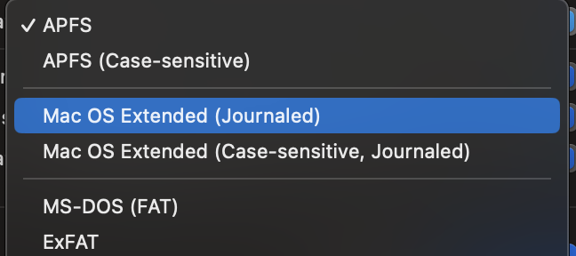

Is there still an option to format a HDD as HFS+? At least up to Monterey the boot SSD could be APFS and a second HDD could be HFS+. I'm not sure about Sequoia. My laptop is backed up to a Linux box and has no Time Machine drive.
Yes. Both GUI and command line Disk Utility support HFS+.
/System/Library/Filesystems/hfs.fs/Contents/Info.plist
Code:
<key>Case-sensitive HFS+</key>
<key>Case-sensitive Journaled HFS+</key>
<key>HFS</key>
<key>HFS+</key>
<key>Journaled HFS+</key>
ADD: what you can no longer do encrypt new HFS volumes.
