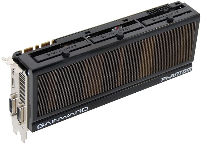

I have a GTX780 rom from the mac elite wiki.
I tried to flash it to a Phantom 780 card and it works in windows, but it will not boot properly on mac (bootscreen is ok, and loadingbar shows, but it gets stuck after about 2/3 of the booting bar).
Is there multiple 780 ROMS for different versions of the card?
How can i see what version of the chipset i have on the card?
I did many 680 and they all work perfect, never a problem.
thanks for any insight on this!
//GF

Try PRAM-reset, try vanilla (factory) rom, try card in pc to exclude a failing card.
If it works with factory rom, you should better use OC or modify the rom. To my knowledge, this EFI is based on nvidias GTX680-EFI and has no copy protection.

I tried multiple P-ram reset. And also the card works fine when booting into windows as i mention in first post.
However it will freeze when booted up into OSX.
I can run it with the Mac-Flash or with the PC-Flash, in windows bootcamp it runs perfect both ways.
However, as i said, wont boot properly into OSX for some reasom that i dont know.
Are there different GTX780 flashes floating around? Is there another "vanilla" rom?
I used the one in public download..
Anyone knows how to check what version of the card i have? and what version the Mac Roms supports?
My card is Phantom model.

Oh, not interested in OC. Just want a card that works perfect all the time with no OC or other software drivers and stuff. That is why i went with 780. Supposted to work as good as 680 but faster.
Maybe the Phantom is to different from reference design, thats why it wont run? I read PCB is bit different.
Flashed couple of 4Gb 680 cards from Phantom and that worked perfect. But 780 is another thing i guess.
//GF

I tried now 2 different GTX780 ROMS with same result.
They give bootscreen, and get stuck in middle of boot process 2/3 of bar in OSX.
They both work perfect in Windows 10 on same Mac Pro 5.1.
I think this is because i am running the Phantom GTX 780 model that is not 100% reference design, if anyone else managed to get this card working pls let me know. Until then i advice others not to use this card. I have flashed many cards, but this one i now tried 2 different ROMs, and different OSX versions, and none is working.
Card looks like this:
Thanks for your support guys!
And thanks for the ROMs i got.
