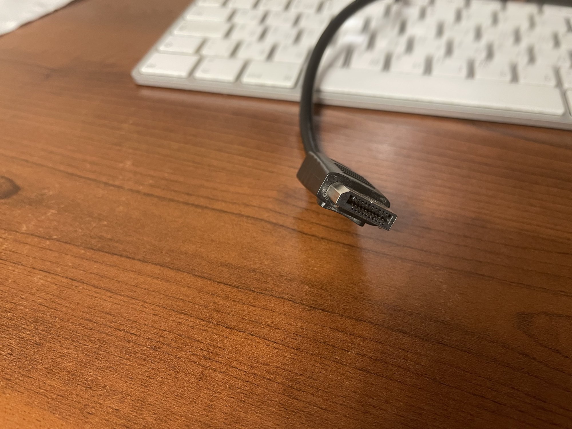

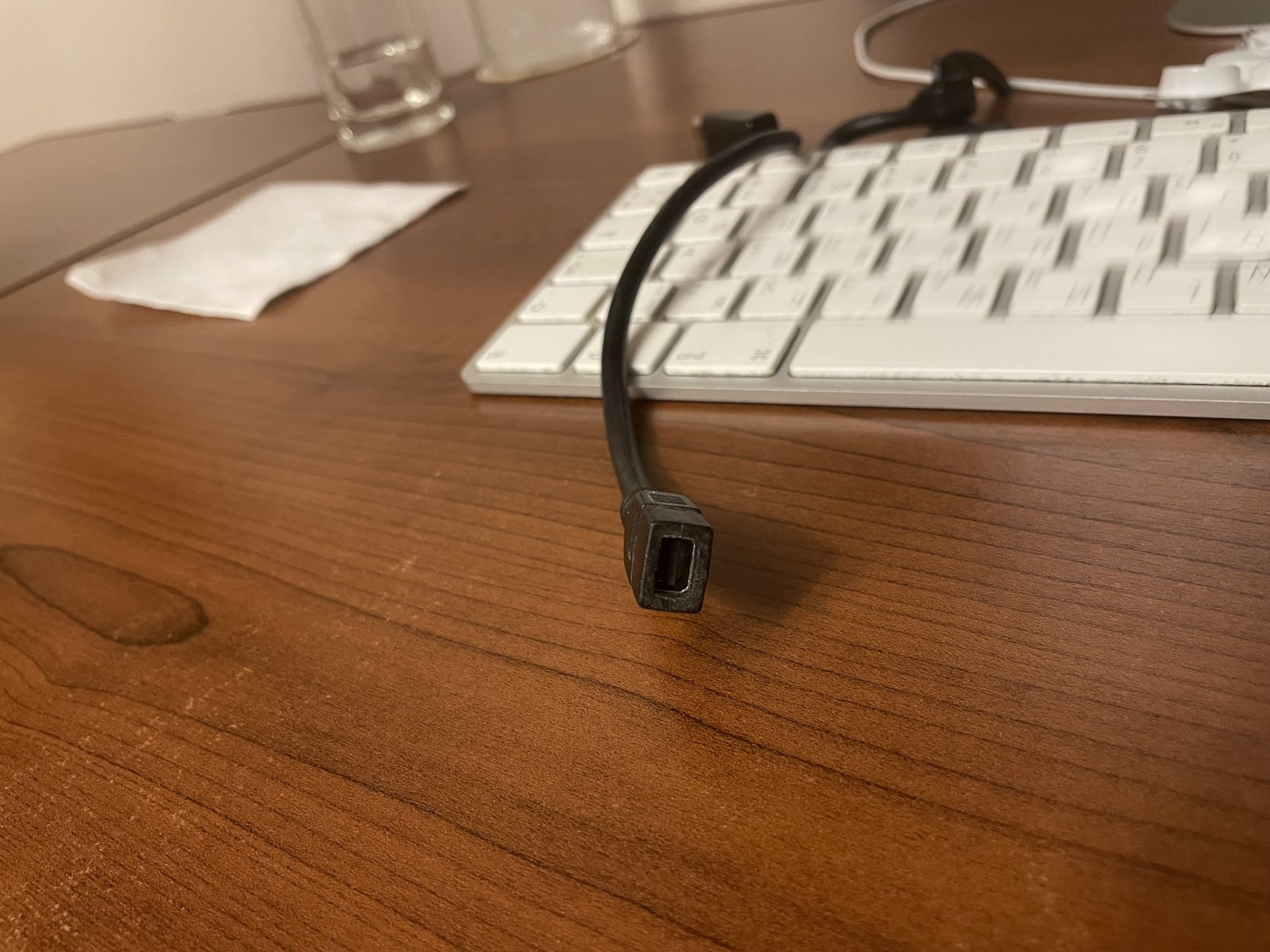

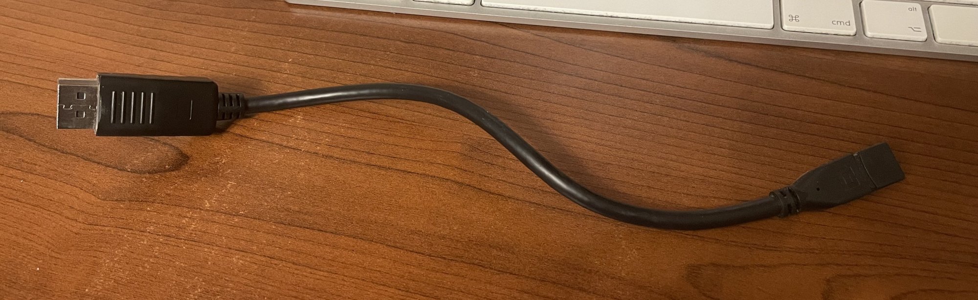

I have Apple LED Cinema Display 24 (clarification - mini DisplayPort 1.1 connector) without OSD. https://tim.id.au/laptops/apple/displays/led_cinema_display_24.pdf
So the DisplayPort 1.1 standard is used.
Connected like this:
Apple Cinema Display with built-in mini-DP1.1 cable -> mini-DP to DP adapter -> DP video card input.
The keyboard is connected to the monitor's USB hub, the USB cord from the monitor is connected to the motherboard's USB port. The keyboard works fine either way.

This setup (your adapter) could be the problem. Try holding ALT or Option key even on black screen.
There might be boot screen with black background just like on new Macs.
My response:
I tried everything on your advice. I've tried 30 reboots, tried removing all the expansion cards and drives, but no luck.
The mDP-DP adapter cannot affect the bootscreen display, because in all other cases it successfully performs its function. I have recorded a short video for you

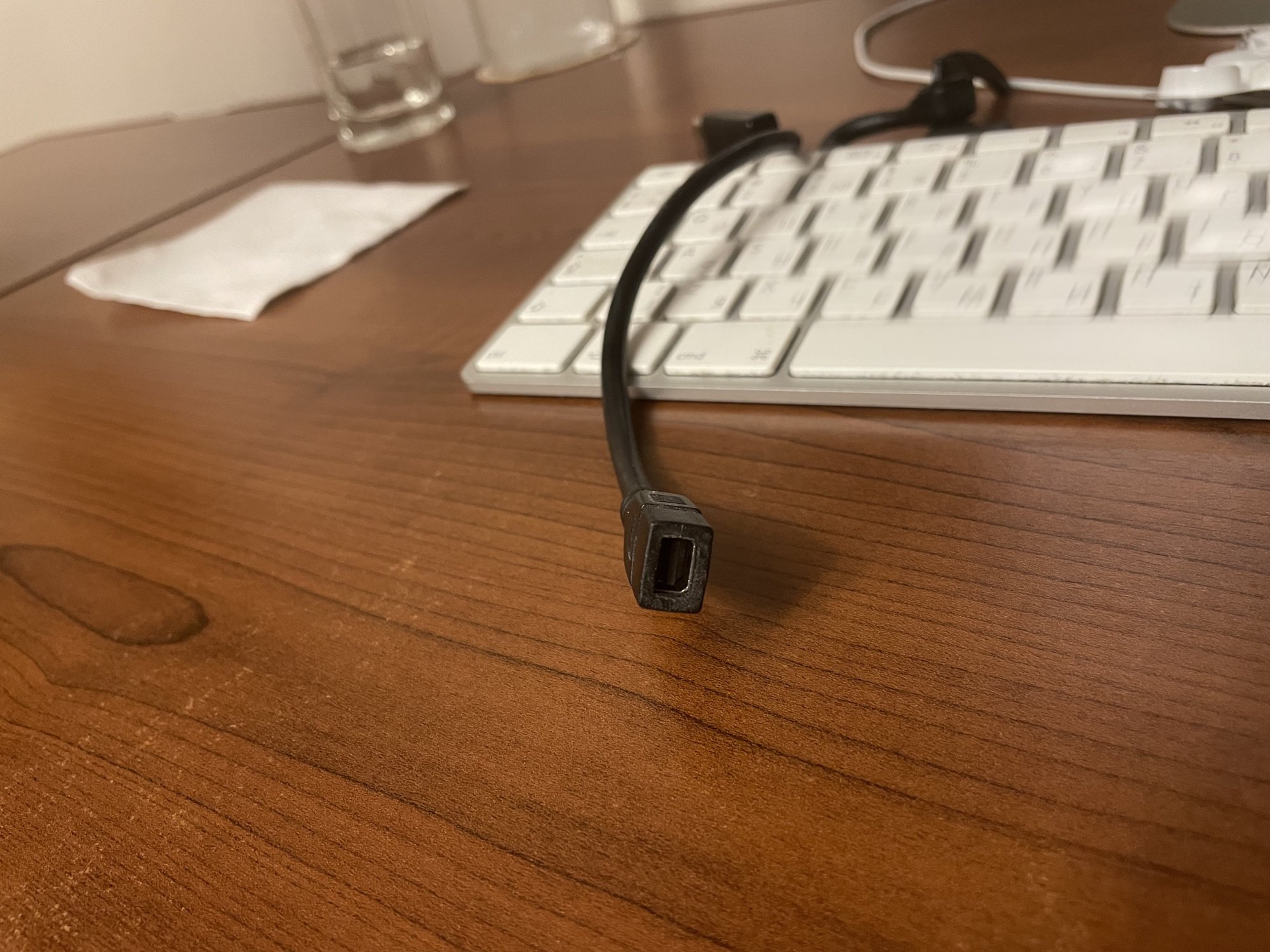

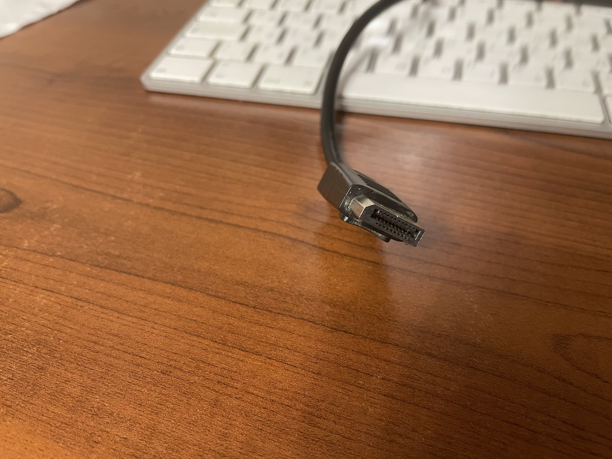

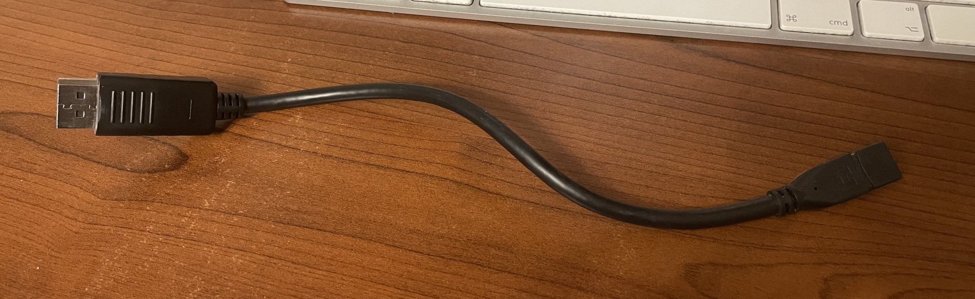

We've tested with Apple Cinema HD Display 23' with HDMI do DVI adapter, DP to DVI adapter (both active and passive) and native 4K display running HDMI 1.4/2.0 and DisplayPort 1.2 all showed boot screen properly.
What the model of this adapter?
My response:
The adapter is noname (or I don't remember the manufacturer name), I've been using it for 9 years. Here's a pictures (attached).
Questions arise:
- Why does the adapter work fine with the gtx680 ?
- Why does the adapter work fine with rx6600 after loading the OS video card drivers?
- How does the adapter can influence not displaying the bootscreen if it works fine after loading the OS video card drivers?
It's very strange... Is there anything I can do to help you get a debug file to investigate?
macvidcards-europe
To display EFI boot screen all components must be ready on boot (it should have some chip inside, then you would see firmware version of such adapter inside macOS). Probably it works inside macOS as soon driver is loaded.
I think GTX680 only supports old DisplayPort 1.1, while this card has DisplayPort 1.2/1.4 mode so adapter should also supports at least DisplayPort 1.2 on boot.
Startech DP2MDPMF3 oraz Club3D CAC-1120 would be best probably. Nobody reported such issues so far.

Marek, with all due respect, but according to the standard, all DisplayPort-to-DisplayPort cables and adapters do not have chips and are 20-pin, regardless of the connector version. The v.1.0 cable is exactly the same as the v.1.4 cable. That is, they are completely identical.
Do you insist on replacing the adapter? If yes, then after its replacement and with further incomplete performance of the video card, what will be our actions?
In general, this is the situation. According to Marek, I'm the first one to come in with this kind of issue, which makes it even weirder.
It seems to me that the behavior of the video card is very similar to the fact that it is stock (not flashed) - there is no bootscreen, but it works when loading Monterey 12.4. I note that the card does not work at all in Mojave 10.14.6, even at the base (low) resolution and without acceleration - just a black screen, although the OS loads normally (I hear it from the rustling of the HDD).
Has anyone encountered anything like this? Is the mDP-DP adapter really the source of the problem? I just couldn't google any similar cases of DisplayPort-DisplayPort cable incompatibility. I'm at a loss.
Very unlikely. mDP to DP cable is really just an adaptor (of form factor), no chip inside, but just some wires.
