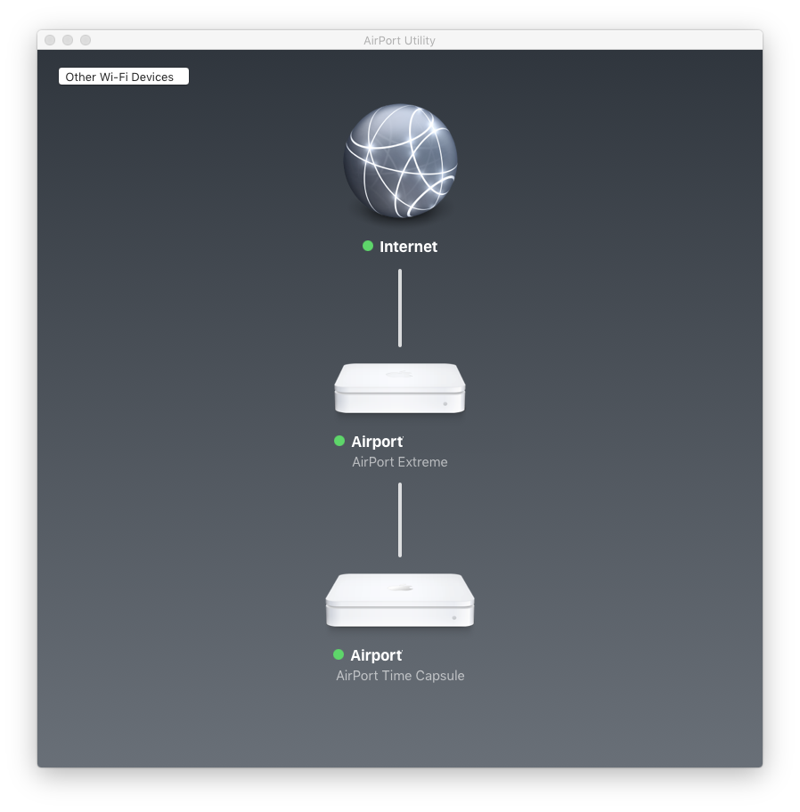

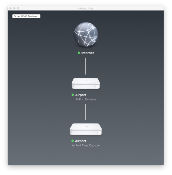

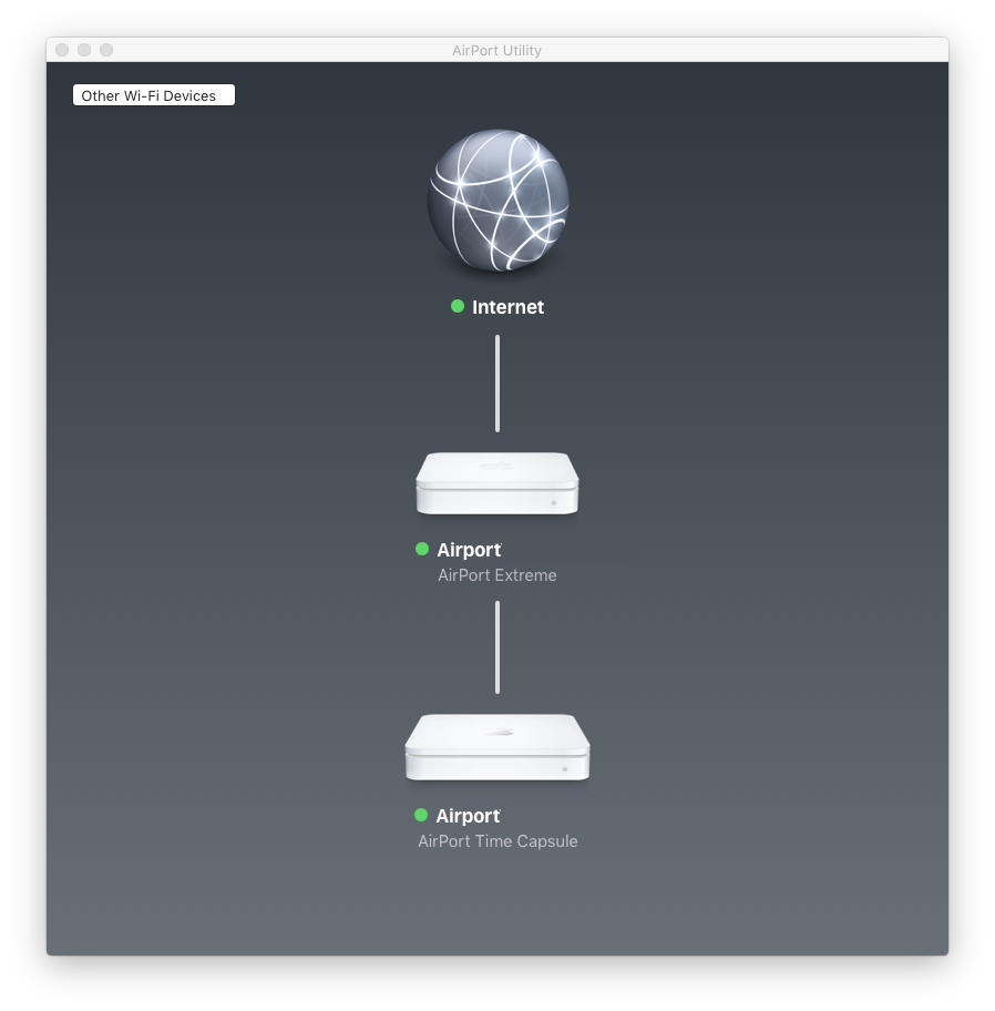

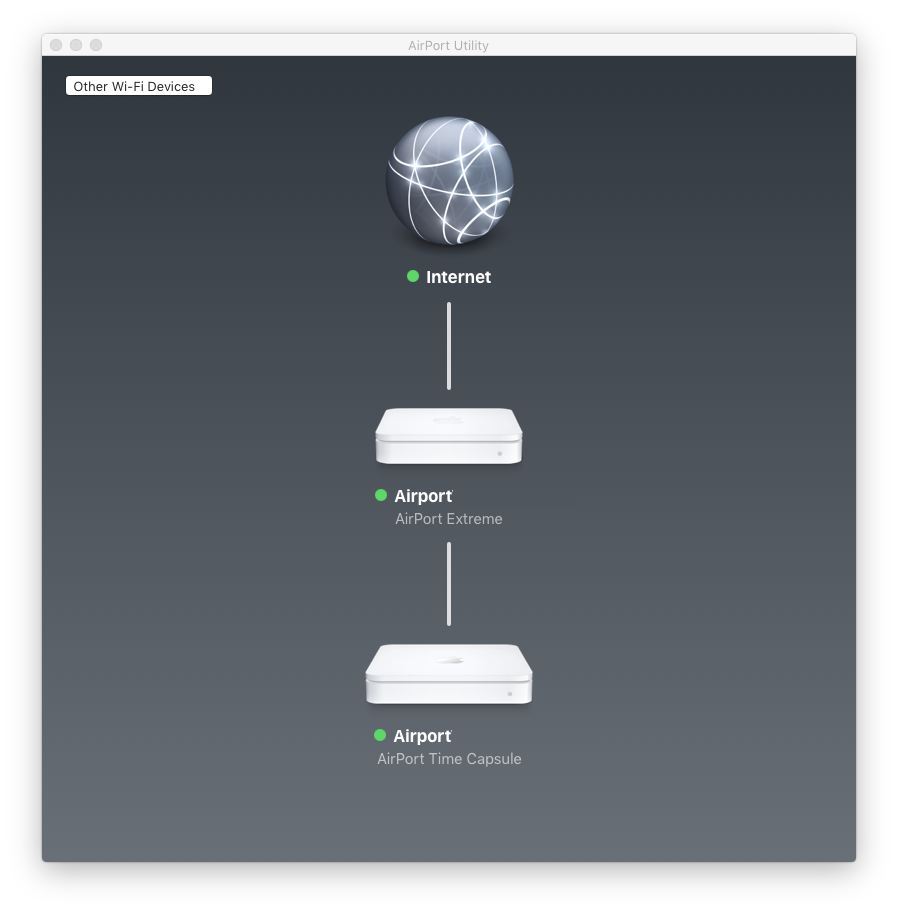

Im wanting to extend my airport extreme network with a airport express. I have them connected by cable and both set to create new wireless network which are both set to the same with the same password.
The diagram shows the routers as being in a line , is this correct from what i can see they should be side by side or is this just if you have multiple airport express
so the diagram shows airport extreme solid line then the airport express ?
To make you aware the Airport extreme handles the dchp but there is a modem from my isp that passes the internet to the extreme
That's for the old ones.
Set the Express to extend, not create a new network. Use the same ID and password and the devices will seamlesly roam for optimal results.
Isn't that for wireless extension? OP has wired connection between two AP-s and thus simple wifi roaming. I have the exact same setup and it works without problems. in AP Utility, they are displayed one under another, not on same level. Just one router can be sharing internet connection (aka NAT), the other should be in bridge mode.
PS Extending wirelessly is easier from the cabling setup point of view, but you will lose some of the wifi bandwidth that is consumed by the wireless extension protocol itself. There are no free meals in this world...
