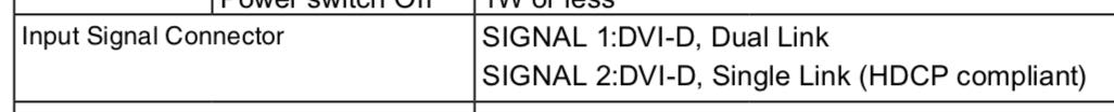

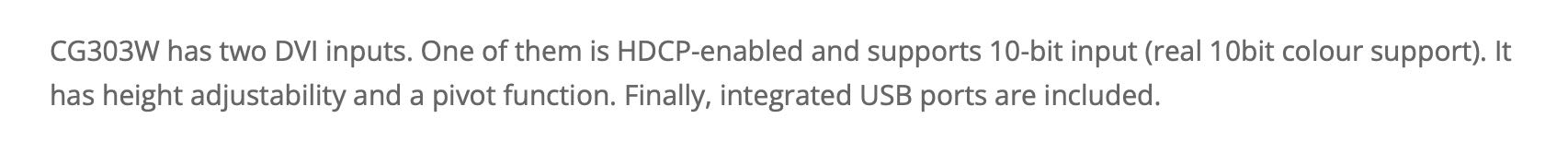

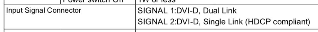

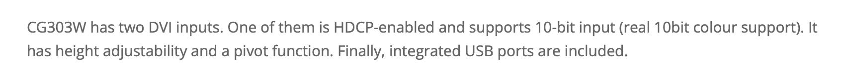

Thanks for clarifying !
Eizo CG303W specifications informs that one of the DVI-ports are HDCP, though that one seems to be the Single Link port.
For using the max resolution it will be needed to use the Dual Link port, and that one seems to have "HDCP off".
I will try the Club3D adaptor, it seems as the smoothest way to do it.
Will it be possible to use 2x of these Club3D adaptors, for running 2x Eizo CG303W displays + the internal MacBook Pro display simultaneously ?
Yep, have always used 2 of them plus internal
