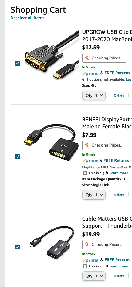

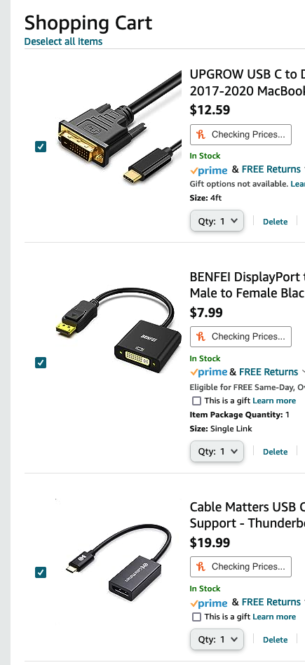

@lasyos - Lol you're gonna love what I'm about to try. I assume this will fail spectacularly.

Those conversion cables just change signal (wire) to pin assignments, they will do nothing to change the EDID. DVI carries all the same HDMI signals except CEC and HEC, which have nothing to do with this issue.
Aaaand cancelled. I was under the impression that jamming the signal through a DVI port would strip it of some info. I misunderstood.
Reading a DVI port gets a different EDID because the DVI EDID does not have the same extensions as HDMI ports. But using conversion cables do nothing but move the same signal lines to different pins on the different connector.
You would need an active device that reads the HDMI ports EDID and then strips out the extension to make it the same as a DVI port. You could do that yourself with a device that allows you to program a new EDID (they exist).
@mattlorimor thanks for the reply, your eagerness to try my stupid experiment, and sorry for the late reply. I had to step out for a bit 😅
I had checked out those EDID emulators @PianoPro told like this one but I haven't bought any yet. That may be the next step after trying to find a way to update Ventura.
I am sorry to hear that Ventura doesn't work for you but maybe one of those EDID devices can do the trick
