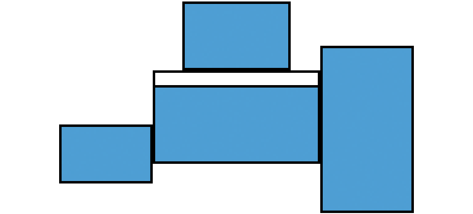

I'd love to have a fix since it's happening on my new Mac Studio (2 identical monitors that randomly swap as the main screen, and a 3rd different monitor).

I've been having this issue on my 2021 M1 Max MBP and found this thread. I may have FOUND A SOLUTION which has worked for me so far on my triple monitor setup in clamshell. I discovered it in this thread https://discussions.apple.com/thread/251850559. I appreciate if others also test to confirm it works.
Go to Apple > System Preferences > Mission Control > un-check "Automatically rearrange spaces" and "Displays have separate spaces" to see if that helps.

I already use Stay app and can confirm it does not remedy the issue of monitors switching. Try this:

@Dbrink329 I tried your idea, but that prevents me from independently swapping between full-screen content on each monitor separately.
@Dbrink329 I also tried your idea and ran into an issue similar to the one described by @dadude999. So I tried rechecking "Display have separate spaces" while leaving unchecked "Automatically rearrange spaces based on most recent use." And it's working! No issues for nearly 48 hours. We'll see if it holds.
Same issue - M1 Max Mac Studio. Two same build monitors keep flipping between right and left. Thunderbolt daisy chained.
I'll repeat what's working for me: Go to System Preferences > Mission Control > uncheck "Automatically rearrange Spaces based on most recent use." Five great days and counting of no display swaps, not once.

This is the option I used to fix this issue on both my Monterey MacBook Pros and it has worked great. Seems macOS treats monitors as "Spaces".
Partial "fix" so far:
Go to System Preferences > Mission Control > uncheck "Automatically rearrange Spaces based on most recent use"
For me this is working to some degree for about 5 days. Sometimes it works perfectly. And sometimes it doesn't. BUT, when it fails, all I have to do is unplug and replug the external monitor cable from the Mac. This is still annoying.. but much much less annoying then having to open display preferences and rearranging them again.

I don't believe "Automatically rearrange Spaces based on most recent use" will do anything to fix the problem. Identical monitors will still be assigned randomly on startup. I'm not sure what is happening if a Macbook screen and an external monitor are getting swapped, but it probably relates to not reading an HDMI EDID correctly (read on for similar problem with 2 identical external monitors).
If you uncheck "Display have separate Spaces" in Mission Control that should fix the problem (always has for me). But you may not want that particular functionality (I don't).
If you run 2 identical external monitors the only "fix" I know that works with "Displays have separate Spaces" checked is to get 2 identical monitors to use different input connections on the monitors. i.e. if both use HDMI inputs you can have the problem. If you switch one to a DVI input (the other to HDMI input) the problem will go away. (The problem is caused by Mac OS not correctly differentiating serial numbers in the monitors otherwise identical EDID's. Using a DVI connections will produce a much different EDID than an HDMI connection and the monitors will be differentiated.) I don't know if using an HDMI input on one monitor and a USB-C input on the other will solve the problem or not, but I would try that if you don't have an HDMI and DVI inputs.
BTW, this problem has existed in different Mac OS's going all the way back to when my 2010 Mac Pro was new. It currently exists on the Mac Studio (where I encountered it again after years without it) and MacBook Pro's. Probably anything running Monterey with an M1 chip, but I don't know that for certain.
