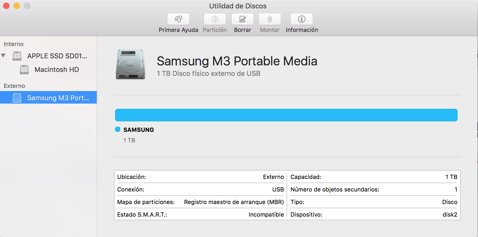

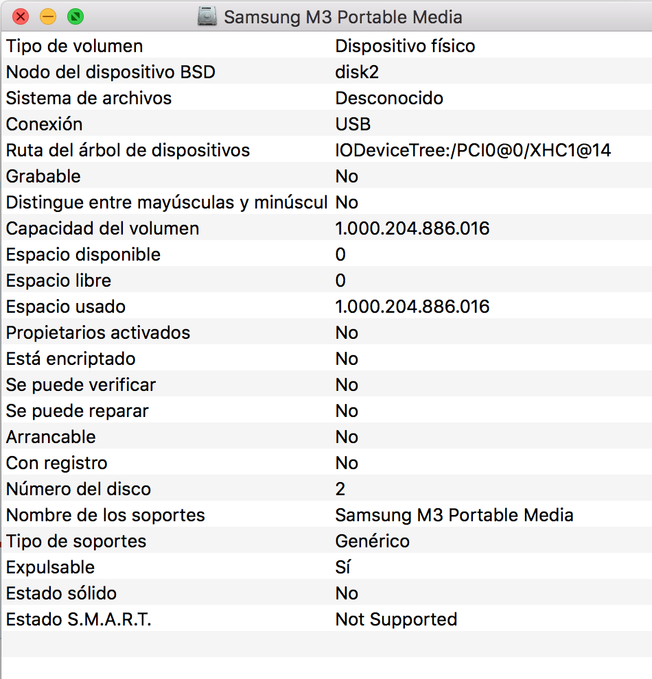

Hello,
I have the exactly same problem as you (saw your screenshot).
Did you solve this??
Thanks.
