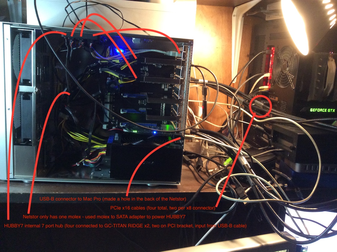

With the Netstor, I can use PCIe 3.0 x1, x2, x4, or x8 devices at full speed.
Below is a picture of a Netstor NA255A in front of a MacPro3,1. The Netstor has long 1.5m cables so I could have moved it elsewhere. The Netstor has four Thunderbolt 3 cards (two GC-TITAN RIDGE and two GC-ALPINE RIDGE - only the GC-TITAN RIDGE currently work - using warm boot from Windows 10). Thunderbolt traffic to a Samsung 950 Pro SSD has these AJA System Test Lite write/read (MB/s) results:
PCIe 1.0 x4: 768/743
PCIe 2.0 x4: 1018/1482
PCIe 3.0 x4: 1071/2423
You see PCIe 3.0x4 can give 1000 MB/s more for Thunderbolt devices. Of course, without using Thunderbolt, you could get up to 3500 MB/s from PCIe 3.0 x4 depending on the device while PCIe 2.0 x4 would remain around the 1500 MB/s range. Changing the x16 Mac Pro slot between PCIe 1.0 and PCIe 2.0 has no affect because PCIe 1.0 x16 >= PCI 3.0 x4. I should try this in a G5 but there's no NVMe driver for it. Maybe an AHCI device could work.
I use the "fast.sh" script to change the slot speeds and the "pcitree.sh" script to see the speed of all devices. I made a version of pciutils to work with both old and new MacOS versions. fast.sh with pciutils is the workaround I use on a MacPro3,1 to enable PCIe 2.0 for a PCIe 3.0 device that starts up as PCIe 1.0.
[doublepost=1558788657][/doublepost]The slot spacing in the Netstor is a little weird. The four slots accommodate double wide cards (graphics cards that use two PCIe back plates at 0.8" or 20.32 mm spacing).
The space between slot 1 (the target x16 adapter) and slot 2 is also a standard 1.6" (two slots).
The space between slot 2 and slot 3 (and also between slot 4 and slot 5) is slightly larger (by 4 mm?). The space between slot 3 and slot 4 is larger still (another 5 mm?).
That is good but I got the board+card+cable for 800$+power supply=150$ Total 950 (and salvaged case)
and the Netstor is 2400$... Otherwise, it seems much more flexible...

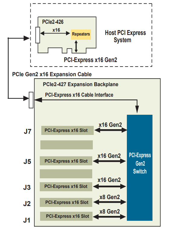

we have macpro 4.1 or 5.1
so with cyclone adapter we are gettin a true 16x gen2 link with a 96 lane pcie switch you can have 2 x16 gen 2 and 3 x8 gen 2 card at full speed.
my anfeltec squid runs a 4000mo/s read write on the cyclone with titanx next to it.
pcie x16 gen 2 is still faster than pciex4 gen3
the netstor is different because the uplink is x16 gen 3 but the slot link on the mobo are x8x4x4x4 gen3
as i say the small cyclone is x16 gen2 to x16x16x8x8x8 gen 2
the big one is x16 gen2 to x8x8x8x16x16x8x8x8
I have both.
on a gen 2 machine the cyclone is faster, on a gen 3 machine the netstor is faster.
and any how only nvme ssd can saturate gen2x16, gpu show no diferrence being on gen 2 vs gen3 slot
cyclone also have 16x gen3 model but way more expensive.
I have both.

The amfeltec (gen 3) works at full speed in the Cyclone because it has a gen 3 switch chip which makes it expensive. When speaking about gen 2 x16 RAID 0, the amfeltec will have the same speed in any of the Netstor's four slots (gen 3 x8), but only two of the Cyclone slots are gen 2 x16.
In the Netstor, you can get full speed from a gen 3 NVMe drive without a carrier card having a switch chip, unlike the Cyclone.
The Cyclone does not gain an advantage when hosted by a gen 2 machine because the Netstor can have gen 2 upstream with gen 3 downstream.
The Cyclone has these advantages:
1) price (a one-time advantage that doesn't exist after you buy a Netstor?)
2) number of slots (one or four more than the Netstor)
3) two or three full speed gen 2 x16 slots (all four of the Netstor slots are gen 3 x8). This is an advantage only if you have gen 1 or gen 2 x16 devices (old graphics cards? what's the opposite of future proofing?)
The Netstor has these advantages:
1) full build (power supply, case, cables, host and target cards, automatic-on when computer turns on) but this is a one-time advantage that doesn't exist after you've built a Cyclone machine.
2) four full speed gen 3 slots allowing full speed from gen 3 devices (up to x8) (not an advantage if you only have gen 2 devices but is future proofing)
3) more upstream bandwidth with a gen 3 x16 host (not an advantage for gen 2 hosts but is future proofing)
3) two full speed gen 2 x16 slots (all four of the Netstor slots are gen 3 x8). This is an advantage only if you have gen 1 or gen 2 x16 devices (old graphics cards? what's the opposite of future proofing?)

Thanks. Updated. That's the 5 slot system PCIe2-2707 using an 80 lane gen 2 switch x16x16x16x8x8.
yep the 8 slot have a 96 lane switch

With a lot of patience, I've found a Cyclone Microsystems PCIE2-427 backplane for less than 30$ :) , a Molex X16 PCIE cable (ridiculously short and rigid). I've just made a mistake to buy a PCIE2-426 card in low profile.
For less than 200$, it's a nice upgrade.
Do you know if I can buy just a full profile PCIE bracket, and a I/O shield for the 5 slots backplane?
