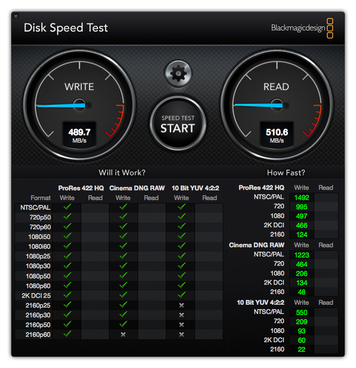

I have a 27" iMac with the fusion drive. I broke up the fusion drive so that I could use the internal SSD as the boot drive and the external SSD as my home folder drive. This works GREAT. I used this Plugable USB 3.1 Gen 2 USB-C to SATA Adapter Cable (https://www.amazon.com/gp/product/B01JK8KJSA/ref=oh_aui_detailpage_o09_s00?ie=UTF8&psc=1) with a Samsung 850 EVO. I get 489MB/s on the write and 510MB/s on the read speeds on the external drive. That's just as fast as an the same drive installed on the SATA connection. The iMac recognizes the drive as a USB 3.1 device with 10GB/s bandwidth. And of course the internal drive on it's own is incredibly fast. I've seen it peak out at about 3000MB/s read and 1100MB/s write, but it averages slower than that.
