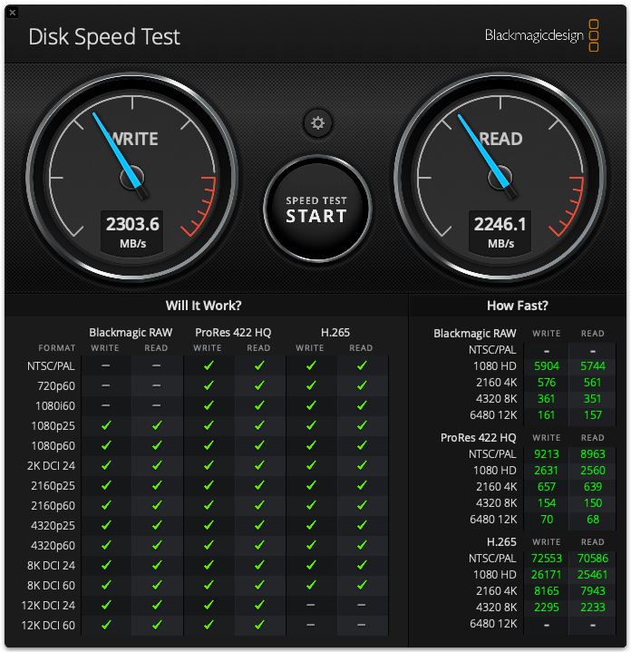

I used the new sandisk pro 4Tb for a week when it failed.... returned it and made my own. Acasis (TBU405) 40Gbps M.2 NVMe SSD Enclosure (fits up to 8TB) USB-C with a Samsung 980 Pro 2TB PCIe NVMe Gen 4 M.2 SSD (Tests in Blackmagic on a mini M2: steady at W:2800+ MB/s, R:2700+/- MB/s)
I have my Lightroom catalog and photos on it and it really does have all the speed I need.

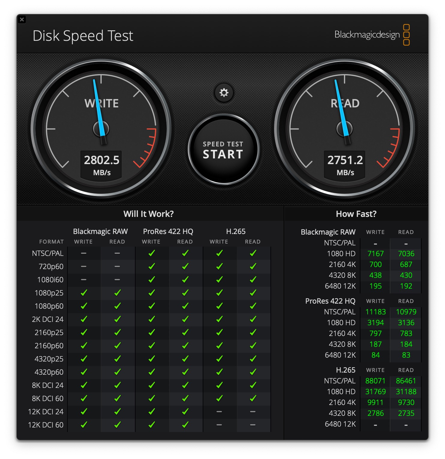

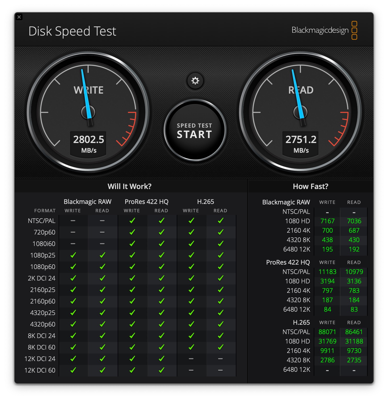

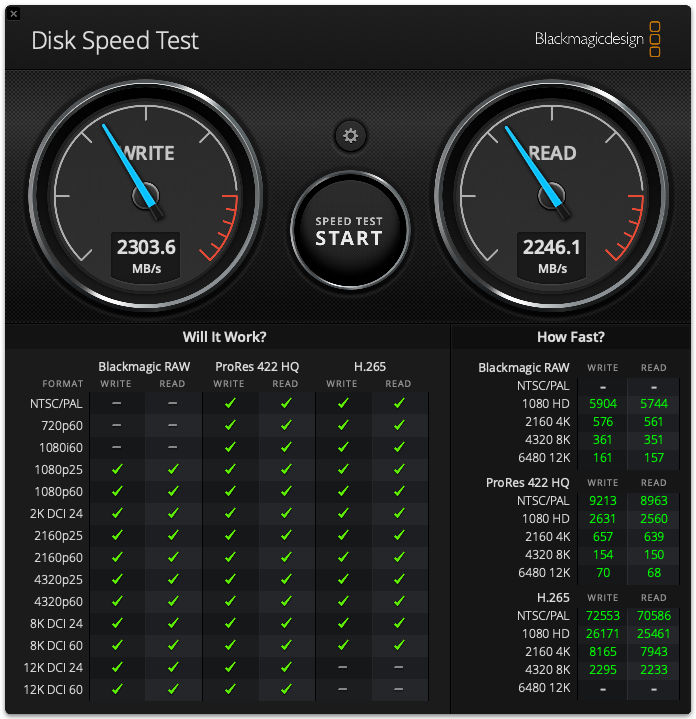

So my Acacis enclosure + 4TB Crucial P3 Plus SSD arrived today. All fit together nicely. Here are the speeds I am getting with my 2019 16" MBP. A little slower than expected, but not bad. I'll test it with my new MMP when it's delivered next week. Hopefully, we'll see it get up to around 2,700 MB/s.
Thanks for the update, speed looks pretty good to me.
