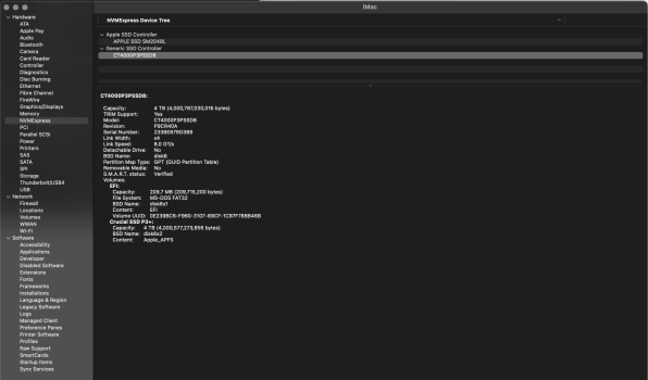

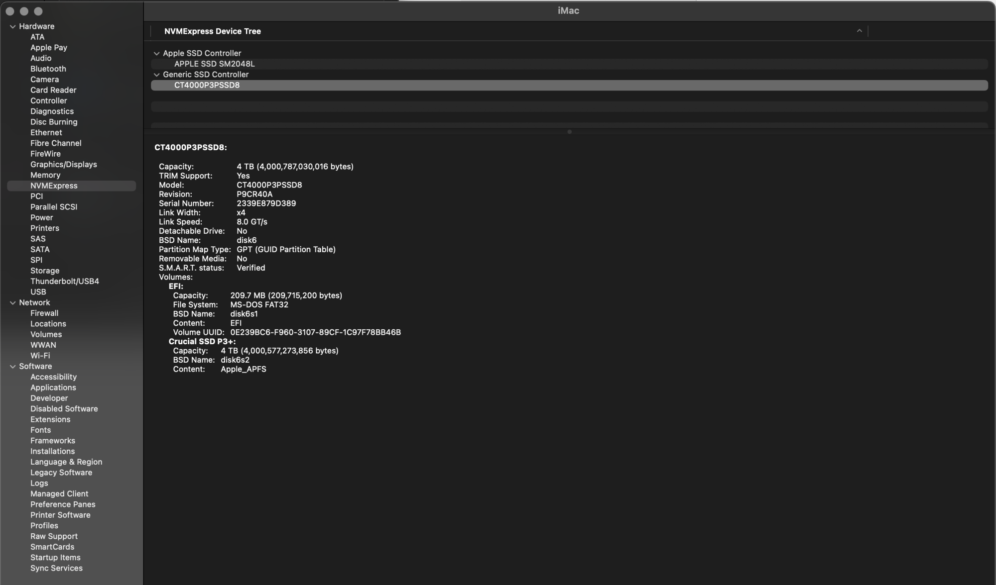

sorry for bothering. Received the SSD and noticed similar speed 2000+ but when writing the drive and testing it drops to 100. Did you enable trim on your Mac? I have a 2019 IMac 5K running Sonoma and trying to figure out how to enable trim on it. Hoping this helps it run better.

Did you check if trim was already enabled?

Don't know how to check If the Crucial P3 Plus has Trim enabled, been researching for a couple hours and don't know how to check on the Mac. I was transferring my photo library to the external and while transferring I ran a test at it gave me those results 100 MB/s but when it's not transferring/writing it shows 2000 MB/s both read and write, didn't know if that was normal.

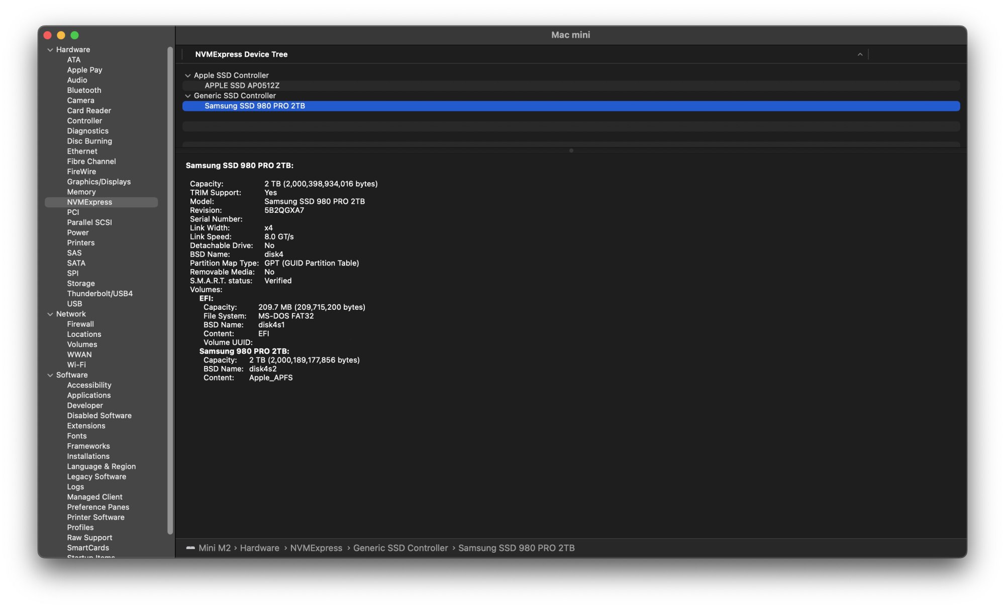

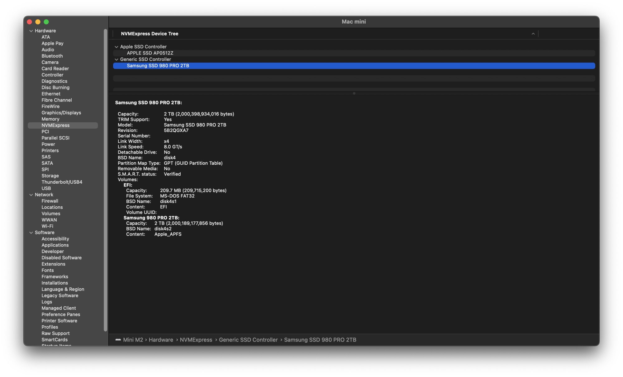

If you go to System Information and choose NVMExpress, choose your drive and if TRIM Support: YES it is on and if it shows NO it is off.

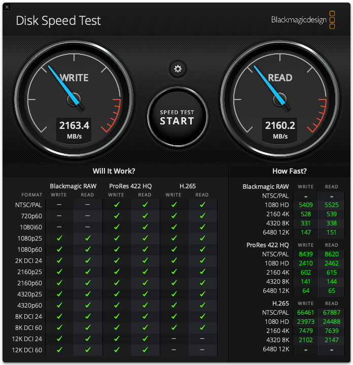

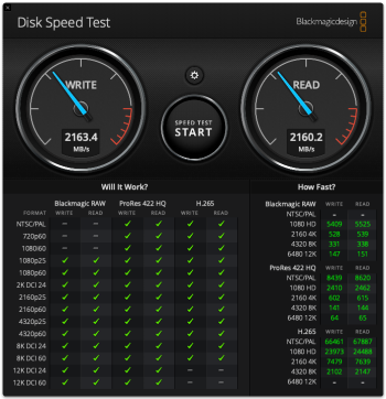

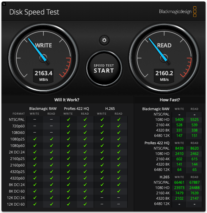

What exact enclosure and ssd did you get and what is the speed of the mac it is attached to (internal) and what connection does it have. I would love to see a ss of a test run.
Good morning and thank you for your help. I ended up getting the same one shared here the Acasis TBU405 and I bought the Crucial Crucial - P3 Plus 4TB Internal SSD PCIe Gen 4 x4 NVMe. The speed of the mac attached to is 2000 MB/s but was transferring from another external that only goes up to 600 MB/s (OWC Thunderbay 4) I am moving my photos and catalog from that external into this one to speed up lightroom. I have a 2019 iMac 27" but upgrading this year to Mac studio once the M3s come out. adding a ss of a test run just thought it took a very long time to transfer earlier and wanted to make sure I didn't do anything incorrectly, if there's a better SSD recommended I can still return this one to Best Buy and get the better one or even enclosure.

Ok, so the transfer was from external drive A to your new external drive B? If so than that is why it was slow.
I recently needed to transfer a 100GB file from my external HDD to my External SSD because I needed to work on it. It took a long time to transfer because the hdd's speed is around 130 MB/s...
I'm assuming that the speed test is from the new drive and not the old (OWC). I would not worry about it and simply use Lr with the new drive and see how things go and if you notice problems when using Lr with the new drive that is when you should look for a problem. I think everything is working as it should.
