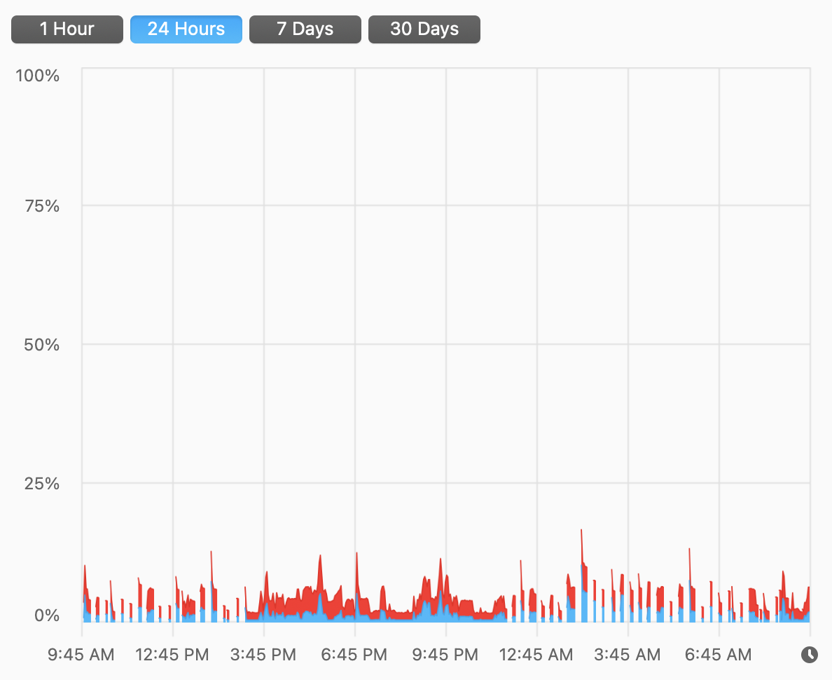

I have a 2023 Mac Pro and the external hard drive spinning up issue is present on that as well with the latest macOS. My Seagate drive spins up every 30 seconds then turns off again when the Mac Pro is sleeping with put hard disks to sleep being turned off. It's connected by USB-A as it's an older drive.
One thing that might be related is that I've noticed the Mac itself seems to wake up from sleep frequently through the night (but not every 30 seconds). I have "Wake for network access" off, which I believe is the old Power Nap setting, but macOS seems to wake up and go back to sleep all through the night even with this off every 10-20 minutes. See the attached graphic from iStat Menus of CPU usage through the night.
Edit: just tested and the spinning up/down every 30 seconds happens with my Lacie 2big connected by USB-C as well.
This is typical behavior for M series Macs. They wake ~4 an hour to do things. Disabling PowerNap on M series Macs is not advised as in some cases (seems dependent on hardware) this can actually cause the Mac to wake up 600 times a minute.
I have been exploring alternative options in the belly of the macOS to see if I can reduce the # of times the Mac wakes, I thought I had it, but after expanded testing, it seems more like for certain hardware running certain versions of the macOS :(
Hmm good to know. I guess the only solution is to leave my computer on 24/7. So they make super efficient CPUs, and then cripple the software to force us to leave them on 24/7? So much for the environmental impact.
