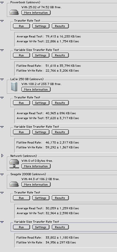

Alight, I ran the test again. You were right about the 86 MB/sec being too high. I was actually testing the interface bandwidth. So i ran the test again. Here are the results. (The tests run 20 times in a row and these are the averages).
Powerbook is the internal 4200 RPM Hitachi drive
250 LaCie is the external FW 800
Seagate 200 is the FW 400
Summary of Read Speeds:
Internal: 51 MB/sec
FW 800: 40 MB/sec
FW 400: 33 MB/sec
Summary of write speeds:
Internal: 22 MB.sec
FW 800: 57 MB/sec
FW 400: 34 MB/sec
