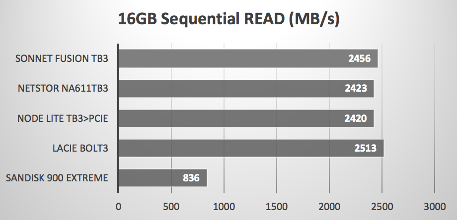

This Netstor case is one of the few that is using the same concept (but with only X2 speed) and delivered comparable performance to the internal NVMe storage.
Thanks. What are the others using such concept?
Look at the picture from „jerwin“. Every drive with more than 2000 MB/s has to use this concept. The Netstor case seems interesting because you can buy it empty and equip it yourself with NVMe‘s....

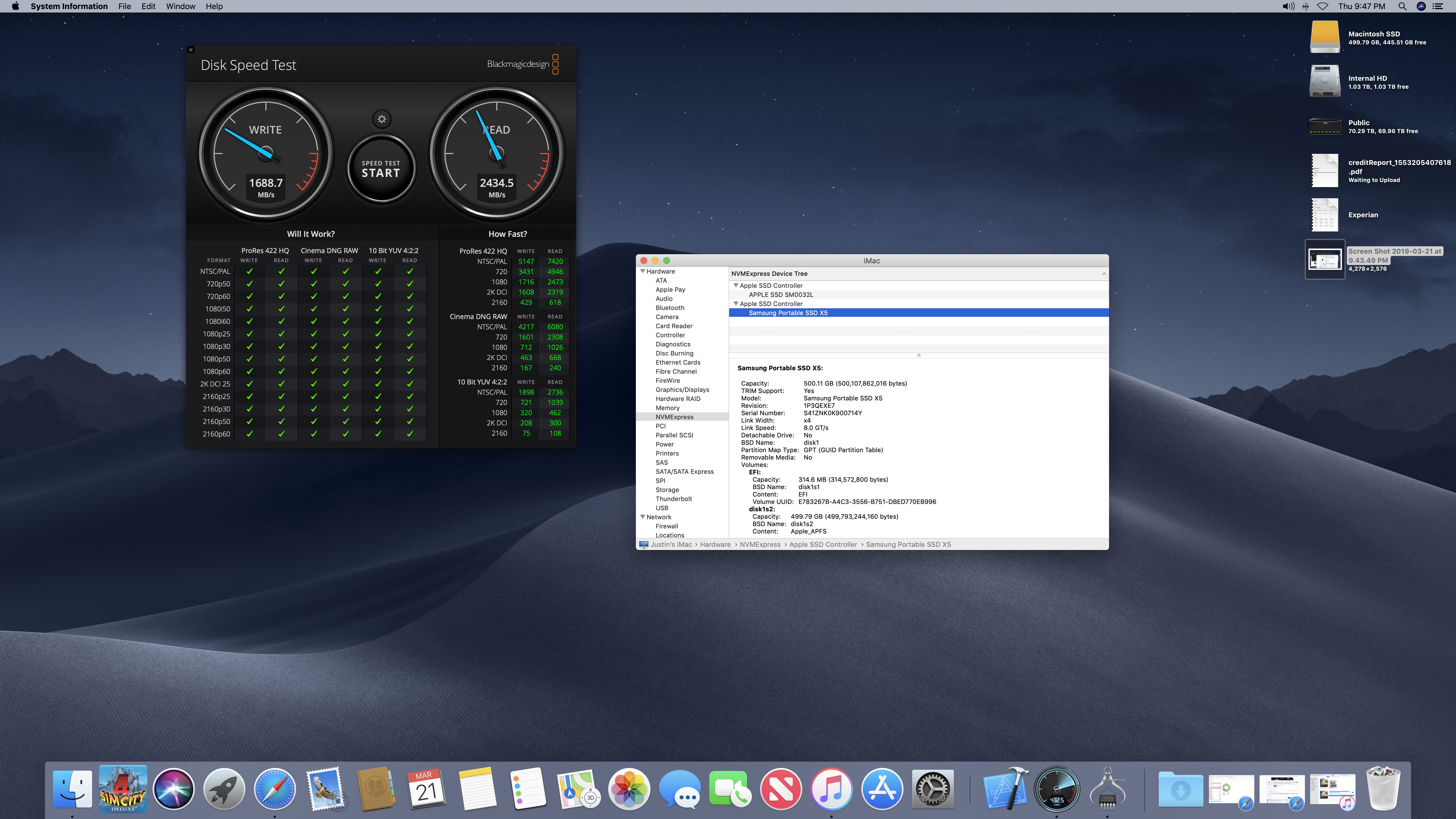

I have an iMac 2017 with an internal fusion drive. Fusion drive is slow, so I bought an external Samsung X5 500GB SSD (TB3), huge difference. Looks like 300 MB/s slower on Read / Write vs Internal Apple PCIe SSD, but still fast enough and cheaper and I have a 1TB scratch drive. TRIM is also supported natively.
Cool, are you booting the OS from that external drive?
Yes, I am using it as my boot drive. The internal 1TB is my scratch drive but currently sits empty.
