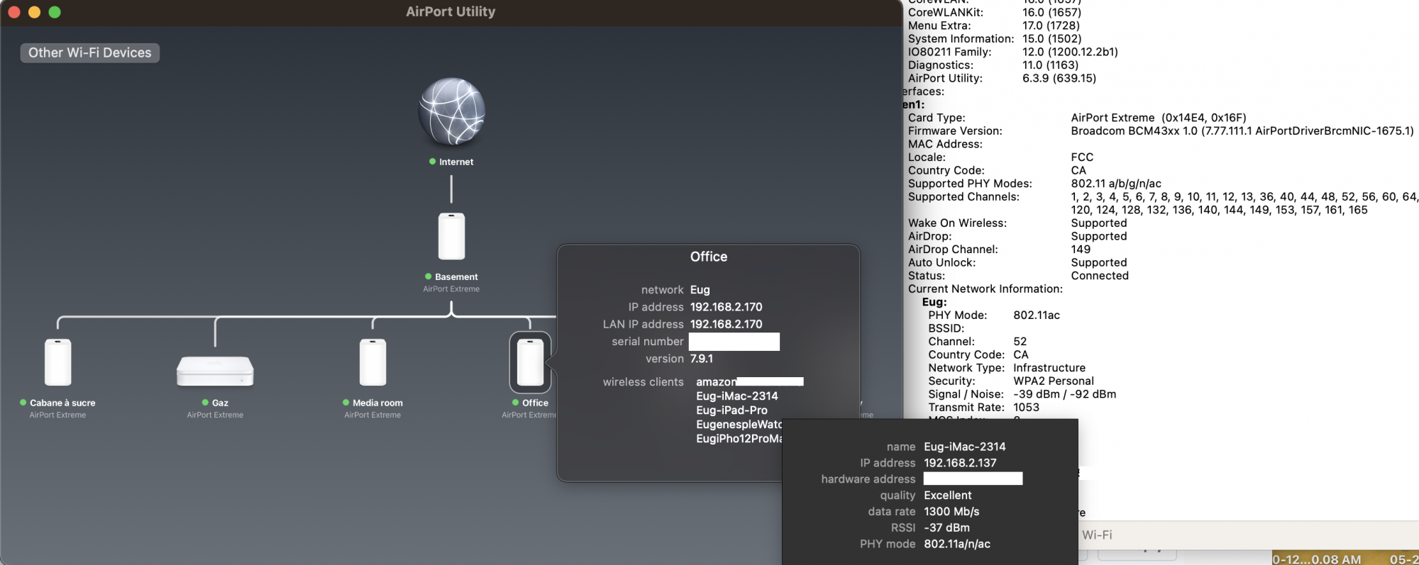

My wife has finally given in that I am a networking nerd.
I'm up to four 6th gen Extremes too now. :cool:

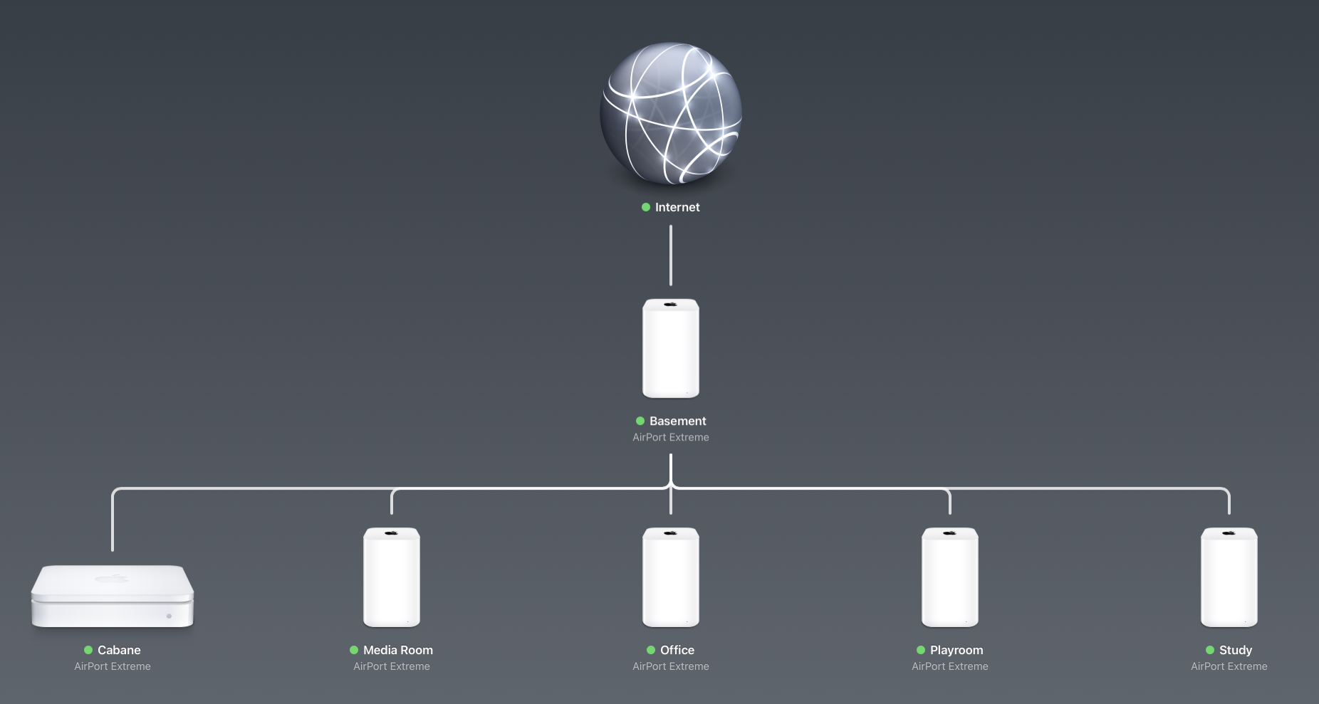

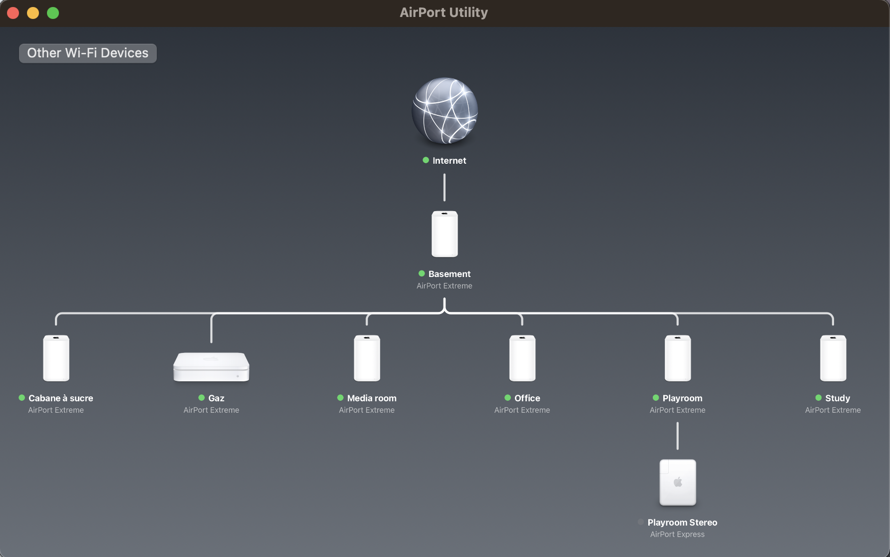

I picked up another inexpensive used 802.11ac 6th gen AirPort Extreme recently, making the 802.11n 5th gen AirPort Extreme superfluous. Now WiFi is moderately strong to very strong everywhere in the house, with no real weak spots anywhere. Specifically, for the kids’ rooms, they have very strong signal, perfect for their Covid-era online learning. The only deficiency after that was in the backyard. I have a large yard, and WiFi signal there just wasn’t very good. So I tried putting the 5th gen in the shed to extend the network wirelessly to the backyard. Unfortunately, it was unreliable, and even when it did work speeds often dropped down to as low as 2 Mbps or even lower.

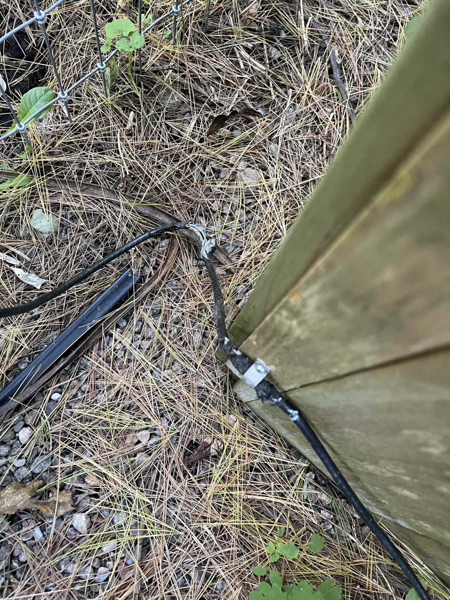

So, I bit the bullet and actually ran outdoor Ethernet cable to that shed outside. :) With the 5th gen in the shed now, WiFi now works pretty well in the backyard. So, why did I bother? So that we can have WiFi there for our Apple Watches without having to always have our iPhones with us. (We have cellular models, but haven’t paid for cellular data plans for the Watches.) I usually do keep my phone with me, but my wife constantly forgets it in the house.
BTW, it’s below freezing outside now, and the AirPort Extreme is working like a champ. Actually I’ve had a cheap TrendNet out in the gazebo for years which is actually partially exposed to the elements (not in an enclosed shed) and it’s survived all these years. However, it runs on its own, not as part of the above AirPort pseudo-mesh. Before that I had a cheap 802.11g model out there and it ran fine for years too, but finally ran into problems when an ant colony moved in. 😬

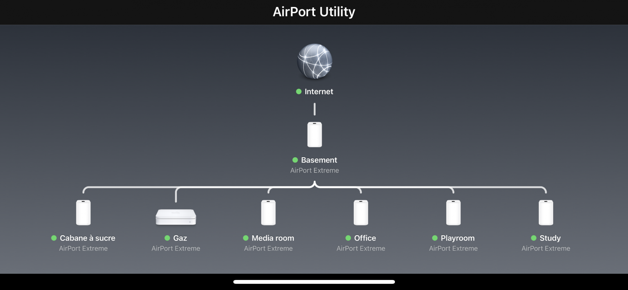

My home mesh is now complete, with basically everywhere in the house capable of streaming 4K, and also full coverage of my yard too with outdoor units.
Also, here is how I built the DIY mount for the 5th generation AirPort Extreme outside:

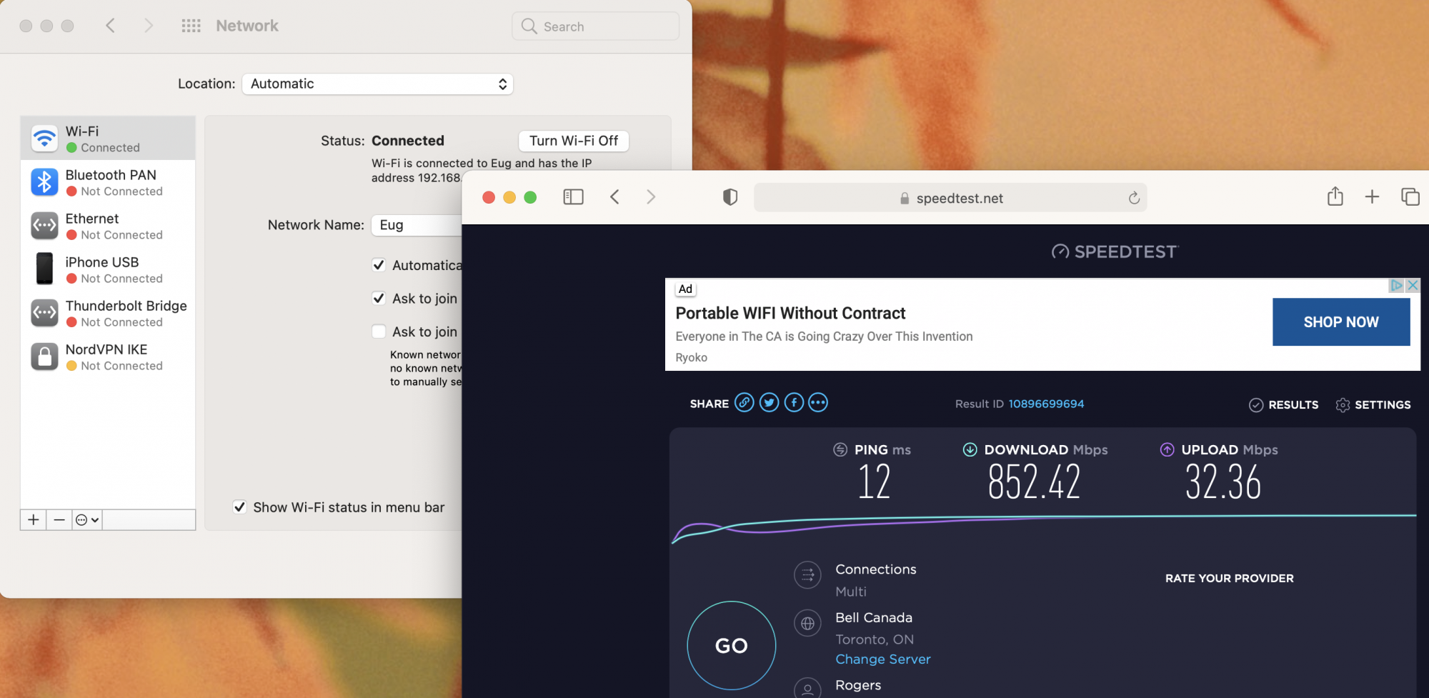

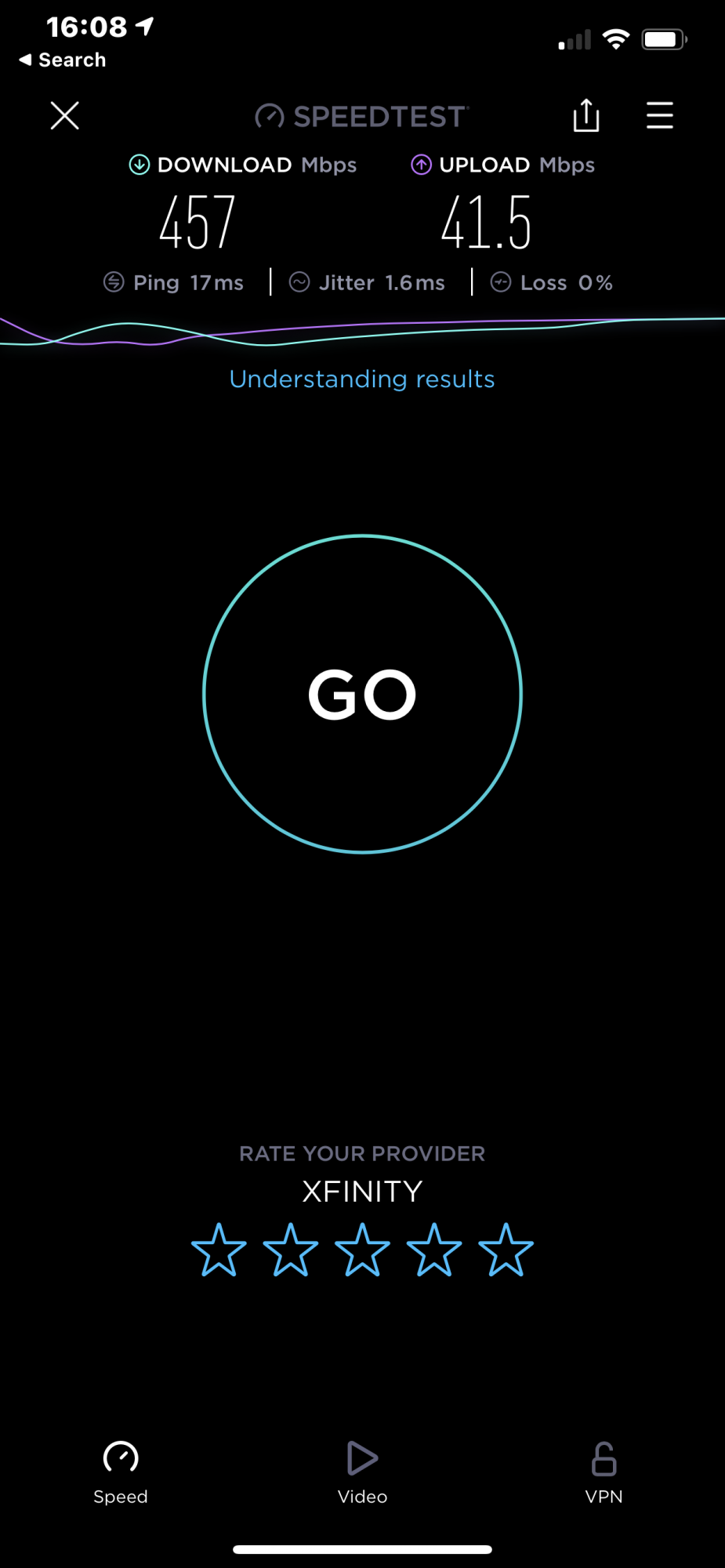

I was curious what the max speed I could get out of this AirPort Extreme 6th gen would be. To my surprise, using a 2017 iMac Core i5 I can get over 850 Mbps on WiFi. Here is the Speedtest result with Ethernet disconnected. (Wired is well over 900 Mbps.)
Note that the iMac is the only device in this house capable of this, as it has 1300 Mbps WiFi link with the AirPort Extreme. It's also sitting close to the AirPort Extreme on the same table. My 2017 MacBook Core m3 is more in the 500-600 Mbps range as you describe.

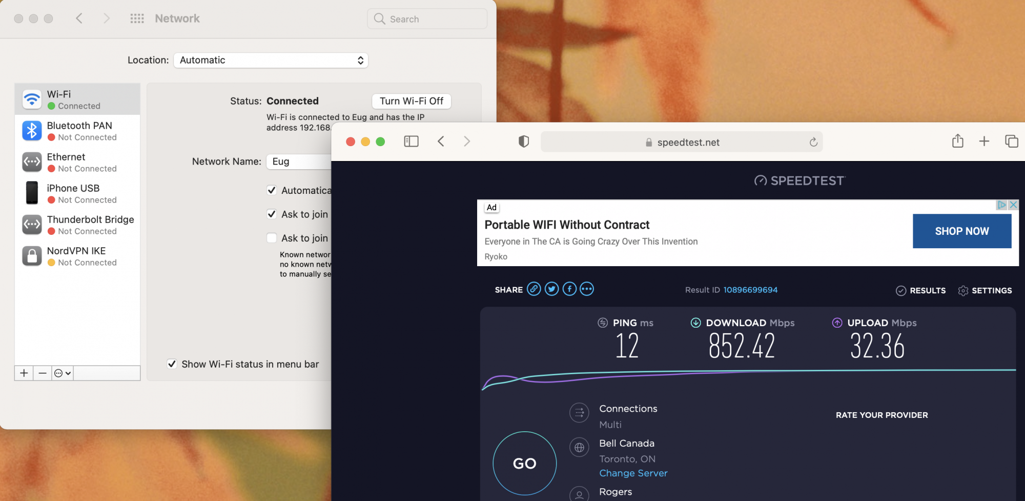

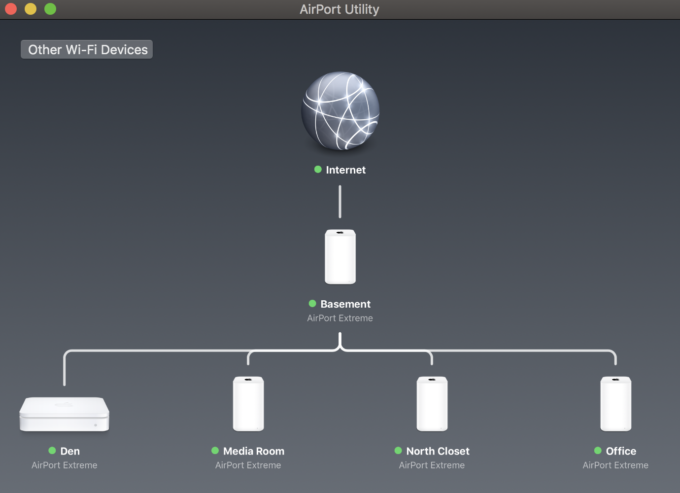

I had one 6th Gen AirPort Extreme set up as my router in the basement, a second one wired as an access point in the main floor master bedroom, and the third one wired as an access point upstairs in my son's bedroom on the other side of the house (staggered middle of house > south end > north end, from bottom to top) with all connected via ethernet Cat 5e cable pre-wired in the walls. The one in the basement was just below the main floor family room and dining room in the middle of the house, so most of the time we would connect to that one when we were home (front or back door).

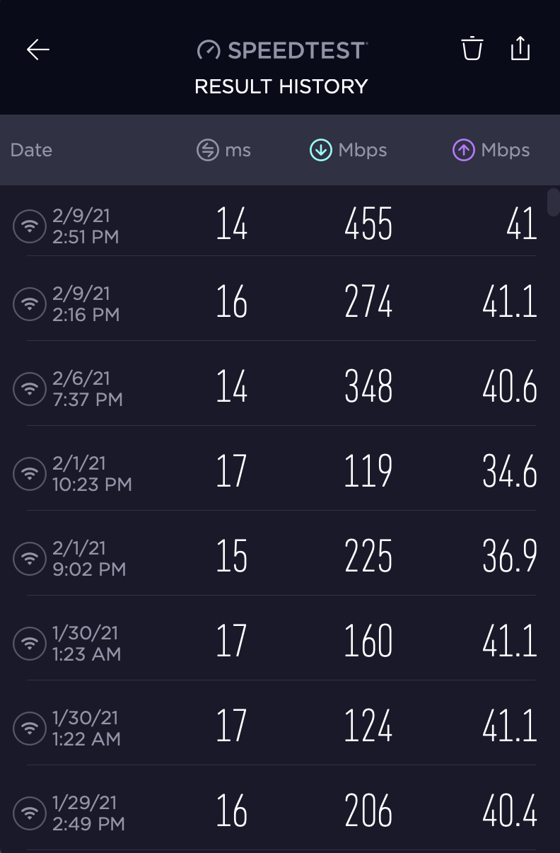

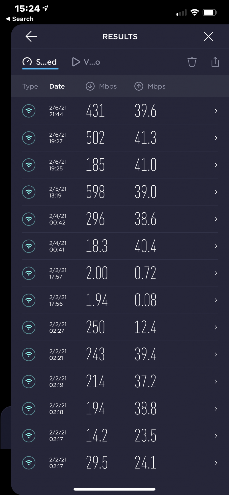

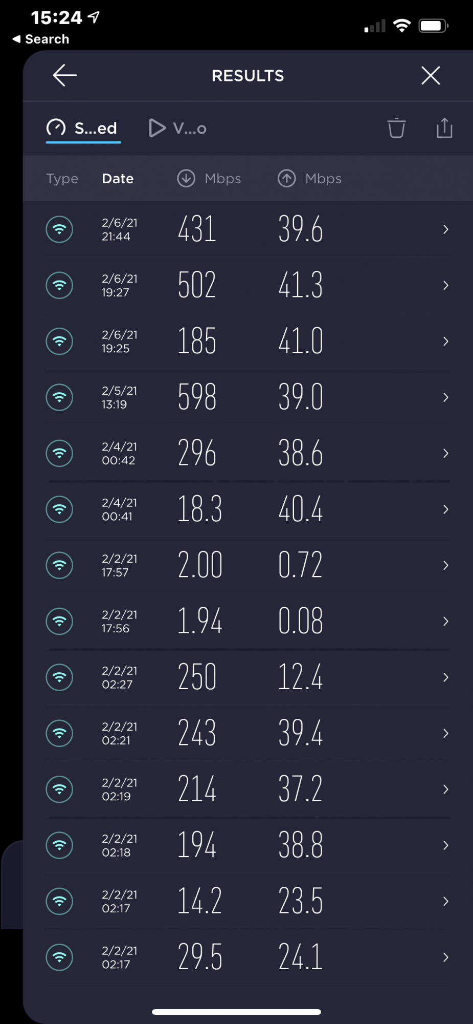

See Speedtest results below, with tests done before 2/6/21 being on the Apple network, and the most recent 3 MacBook Pro speed tests being on the Asus AiMesh network. I have done most of my speed testing in the family room spot with my iPhone and iPad, not the MacBook, but you'll see a similar trend with jumps in speed after the upgrade. The iPhone's slowest double digit speeds were done in the bathroom and single digit outside with the Apple Network prior to 2/4/21.
16" Macbook in family room before and after upgrade Feb 4th (6th Gen router in basement with access points in master bedroom on main and son's bedroom upstairs up until Feb 1st):
iPhone 11 Pro Max below, before and after upgrade middle of the night, Feb 4th:

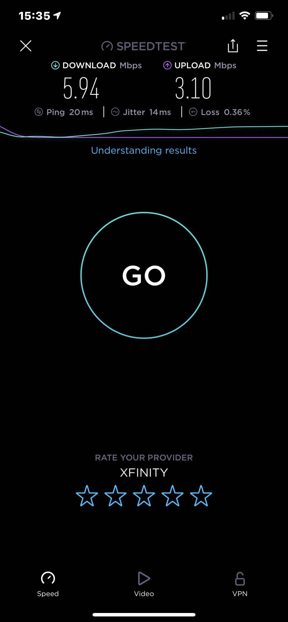

The two slowest single digit speed tests on 2/2/21 were done outside back to back.
The slower double digit speed tests (18-29 mbps) were done in the master bathroom on two different days.
I currently have the Asus network set to let it switch to a stronger node when the signal strength drops weaker than -68 dbm (default was -70 which would have on longer before switching - www.dongknows.com estimated the -70 is about 2 bars of WiFi strength on the Asus, whatever that means - different brand, different bars).

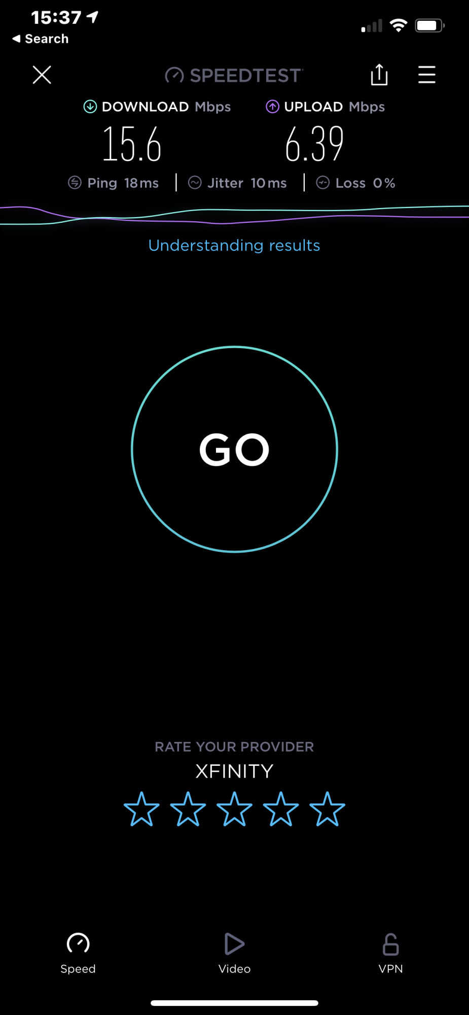

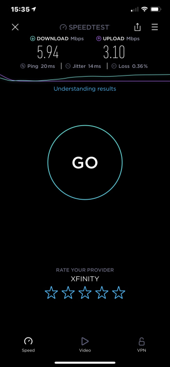

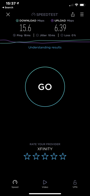

I had connected my iPhone 11 Pro Max to the old network SSID after that, when I started typing this post, and I just went outside and tested the speed in the back patio. I got 5.94 mbps down and 3.10 mbps up, with it having connected to the bedroom Apple 6th Gen access point automatically.

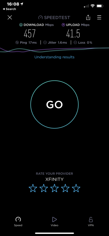

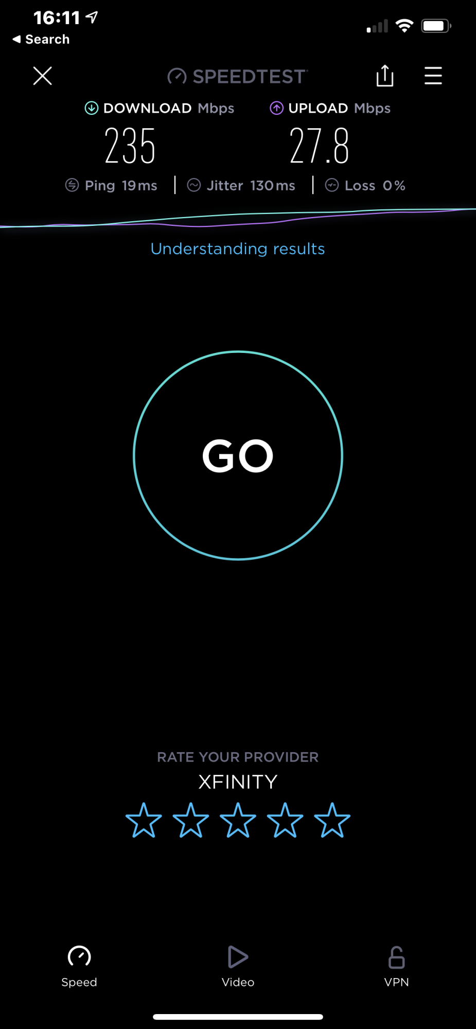

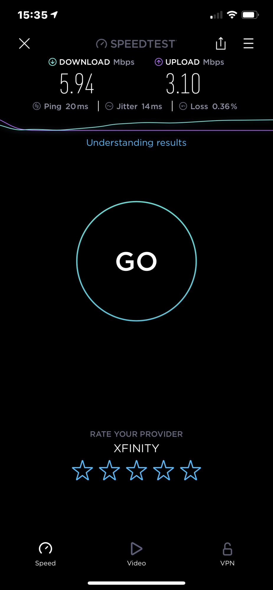

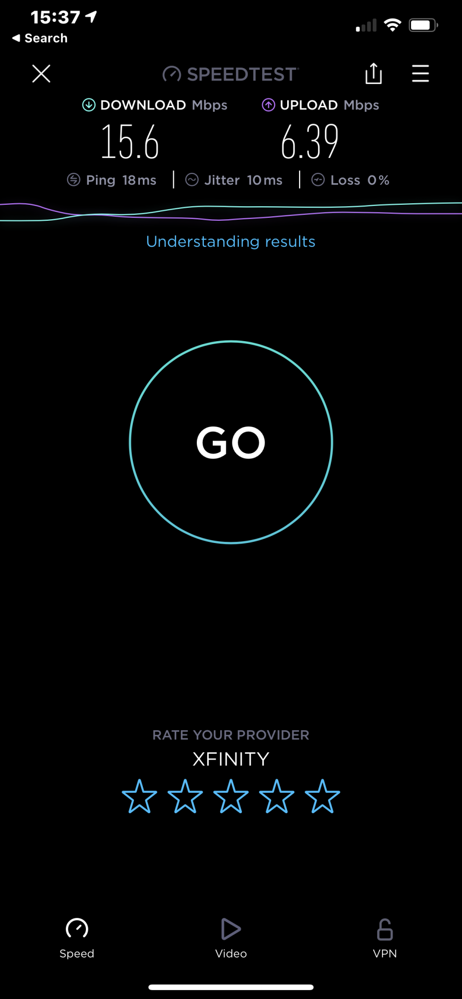

While on the patio I switched my iPhone to the Asus WiFi network SSID and I got 15.6 mbps down and 6.39 mbps up. So, the Asus is running 3x faster outside for download, and 2x faster with uploads. I didn't have a way to check which node I was connected to, but the most direct line of sight to the back porch was with the GT-AX11000 in the basement.

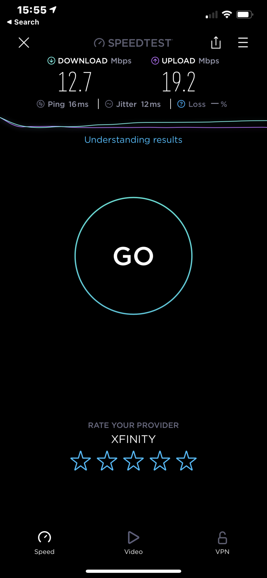

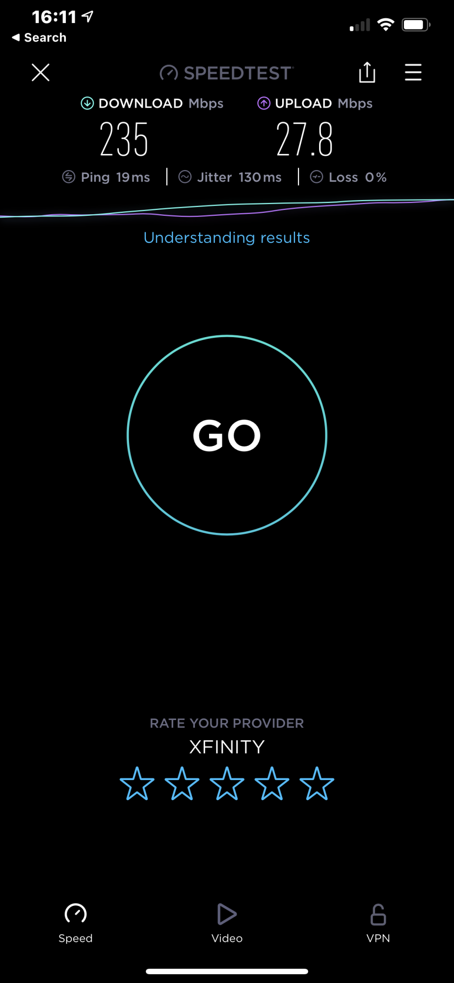

Apple 6th Gen network outside on back patio:
Asus AiMesh network outside on back patio:

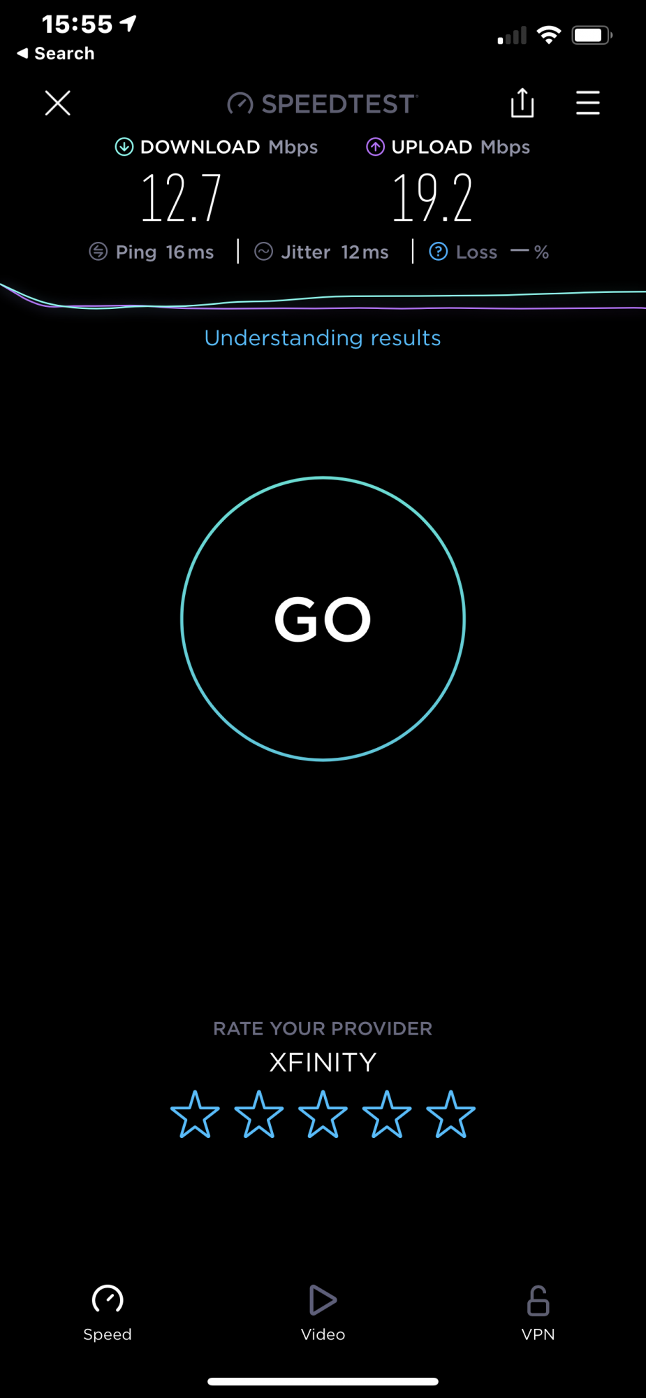

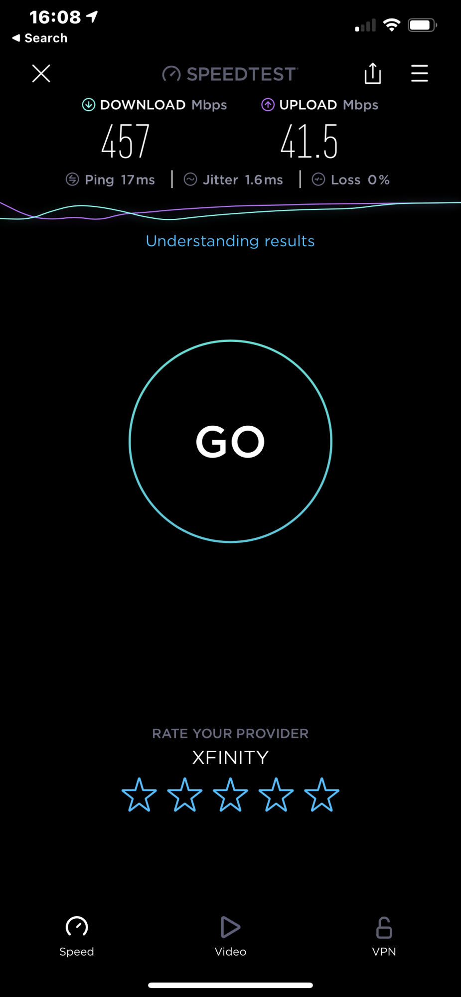

Then, while standing next to the 6th Gen in the kitchen I switched from the AX network back to the Apple network and tested the Apple network speed outside on the patio again. I got 12.7 mbps download and 19.2 mbps upload speed. I confirmed that the iPhone 11 Pro Max was connected to the kitchen 6th Gen AirPort Extreme. Note - the kitchen 6th Gen access point is closer, with 1-3 less walls or floors to penetrate, than the Asus AiMesh router and nodes in my basement, bedroom, or son's bedroom.
After testing the speed outside, I walked back into the family room while still on the Apple network and saw 210 mbps down and 40.9 up, still connected to the 6th Gen access point in the kitchen. A repeat test confirmed a stable 226 down and 41.6 up.
Switching to the AX network while in the family room, without moving the iPhone, gave me 457 mbps down and 41.5 mbps up! Visiting the router webpage says I'm connected to the family room mesh node now:
I walked outside and tested the speed again on the back patio, while still connected to the AX mesh network on the family room node, and got 235 mbps down and 27.8 mbps up!
So I have to assume with my first AiMesh test when I was on the patio and chose the mesh network, that the iPhone connected to the basement AX router but I should have checked before I started.
I had checked to see which 6th Gen I was connecting outside to because it's easy to check with Airport Utility, rather than logging into the router. So, point would go to Apple for ease of use when tied to the Apple ecosystem and having the airport utility on every device. But I just discovered the Asus app and turned on settings to allow me to access the router, and now I can remotely see what is connected to where on the Asus mesh network too.

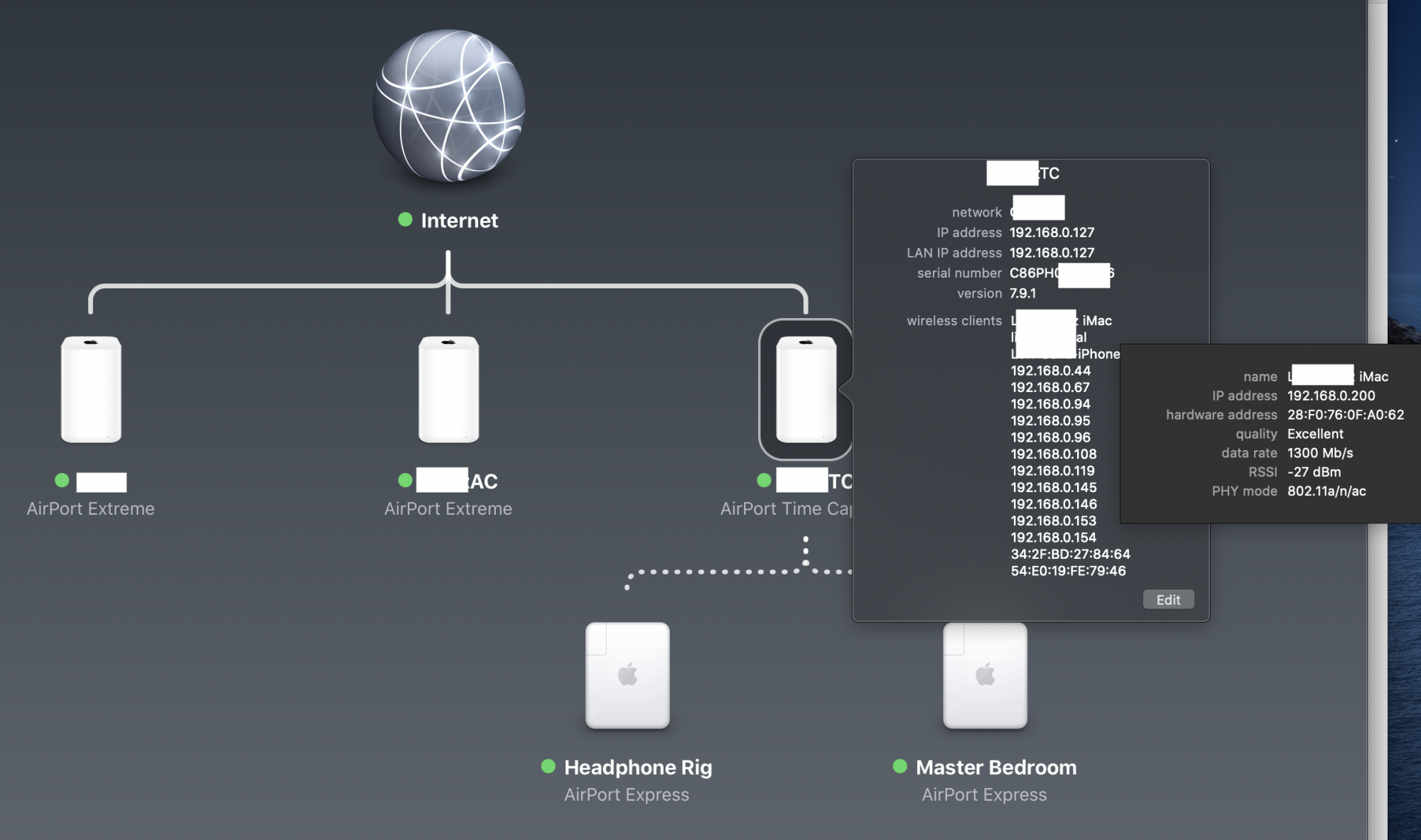

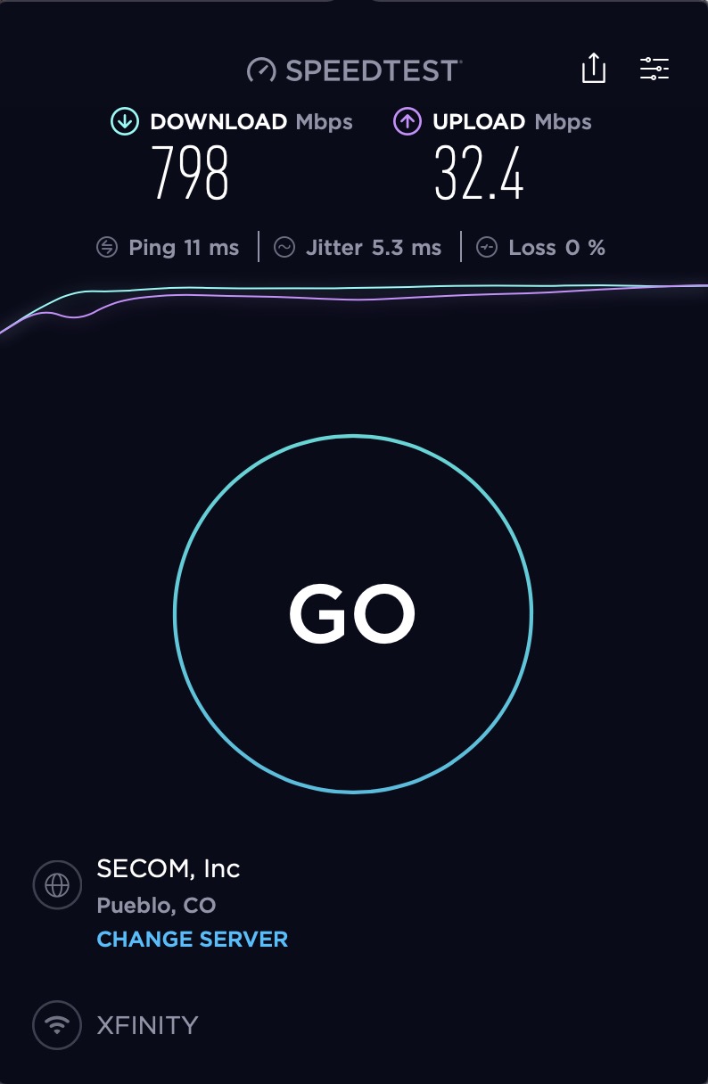

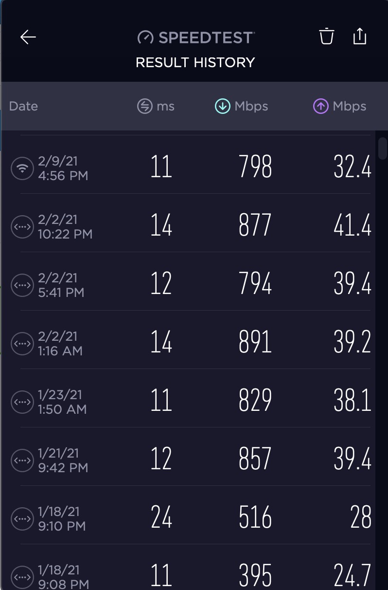

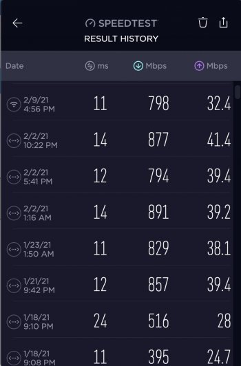

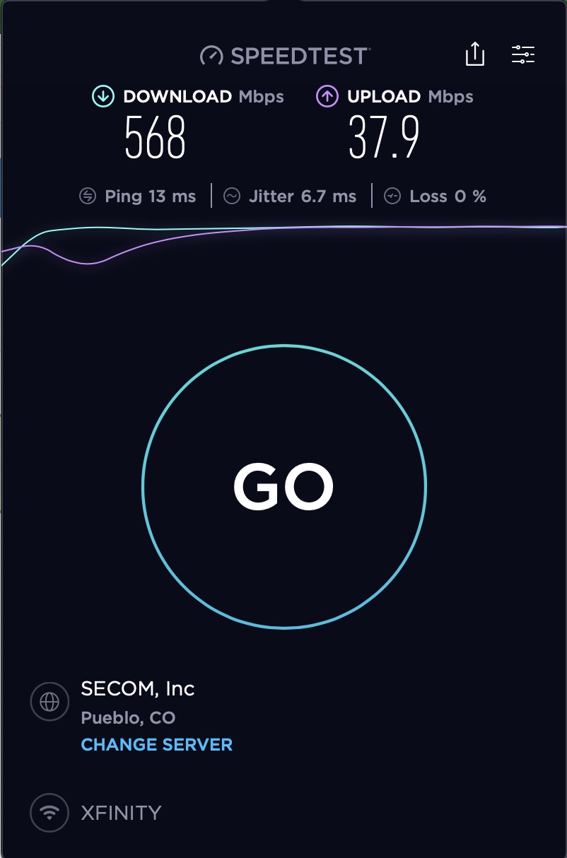

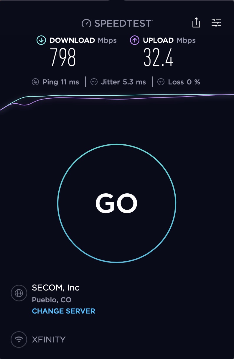

To follow up with your iMac test, I just ran speed test with my 2015 i5 iMac 32GB RAM/1TB fusion drive) that I wired into the 6th Gen Airport Extreme right behind the iMac. We used to have iMac directly wired to router downstairs with Cat 6 cable we'd had fished up the wall and into a jack. I just got 798 down and 32.4 up via wired ethernet with iMac plugged into the LAN on back of the 6th Gen AirPort Extreme, with 6th Gen WAN port connected by Cat 6 to the router in the basement:
Then, I unplugged ethernet and used WiFi to connect to the 6th Gen Airport Extreme behind the iMac:
The fastest speeds we see with the iMac is usually in the middle of the night, when we'll be almost 900 mbps. I know a while back we hit up to 940 from the jack behind the iMac and in the loft, and speed varies depending on neighborhood congestion, but we typically run in the 800's.
Reactions: EugW

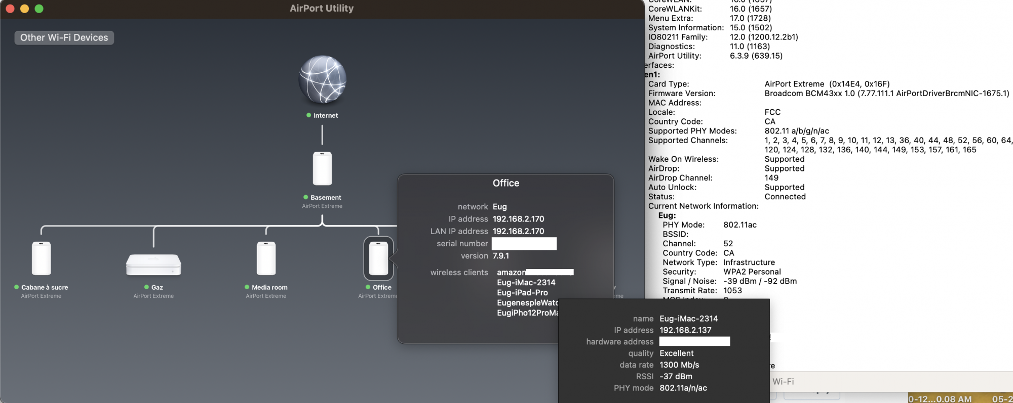

Interesting. Does it show it being connected at 1300 Mbps in the AirPort Utility summary or in System Information? My understanding is that the 2015 iMac is also supposed to support 3x3 1300 Mbps.
My 2017 iMac is showing 1300 Mbps and 1053 Mbps respectively, but is still benching at 850 Mbps on WiFi. That is, if I pick the right server. Weirdly enough if I choose Rogers as the server, I never hit 850 Mbps, despite the fact that Rogers is my ISP. However, if I choose the server from Bell, who is their direct competitor, I get 850 Mbps.

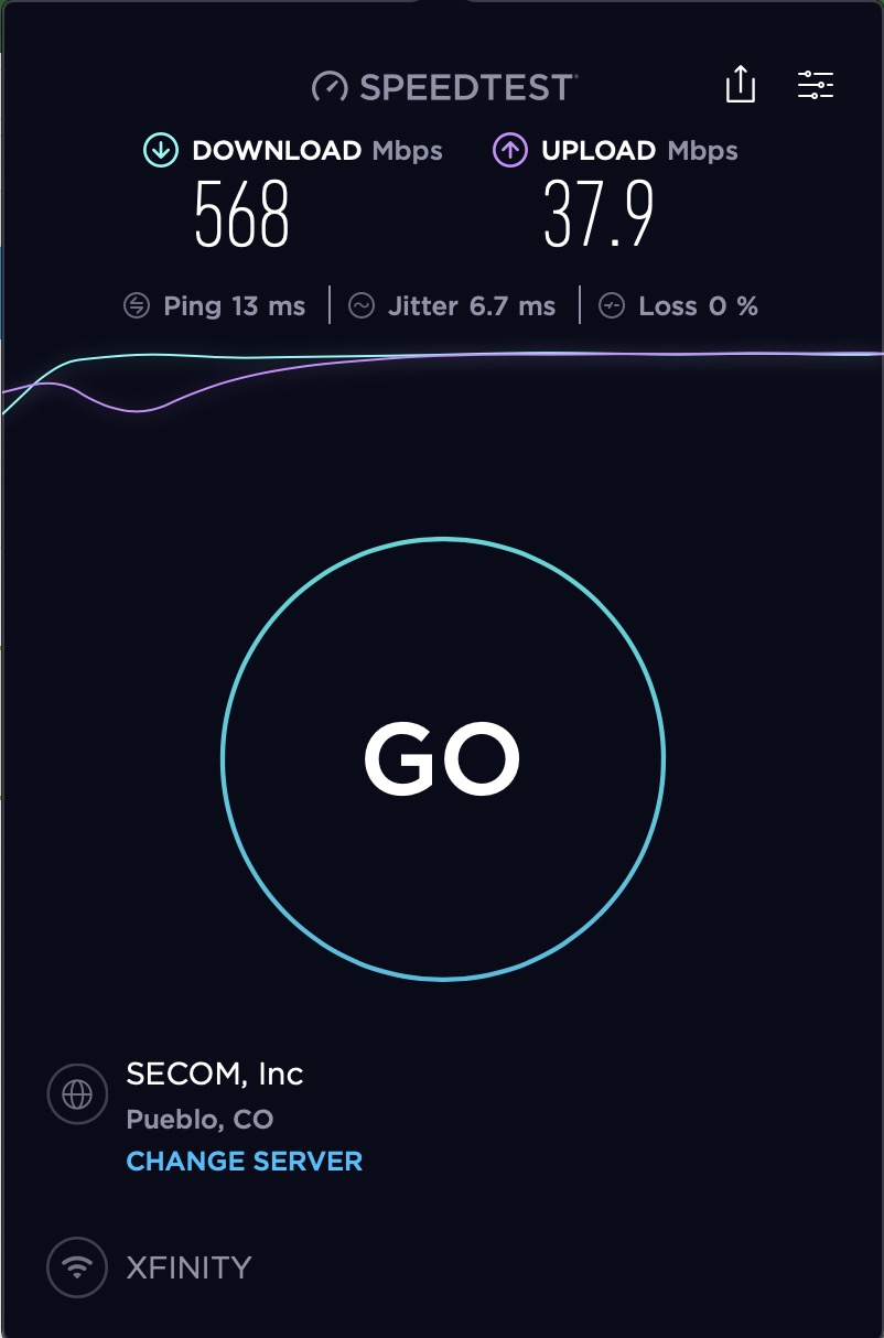

I have not run a Speedtest with a different server other than Xfinity. So I tried a few other than automatic with the wired iMac and Century Link gave me a speed of 90 mbps, PCI broadband was 230, StratusIQ was 333, Springs Hosting was 340, and "Automatic" chose SECOM and gave me 864 mbps! All servers were within 6 miles of me.

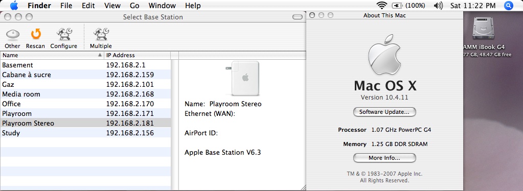

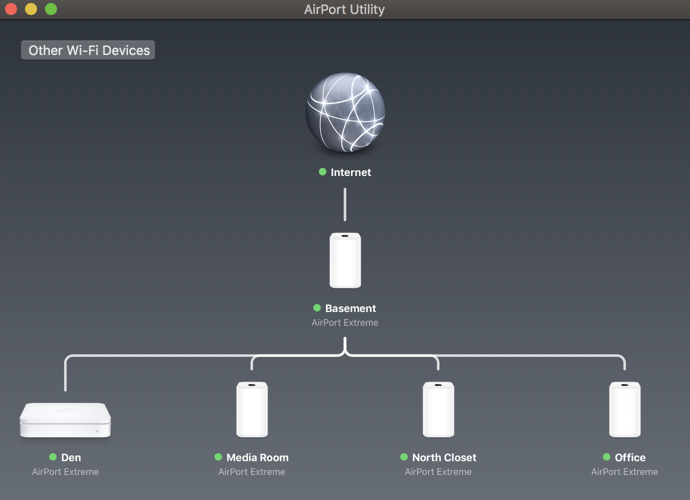

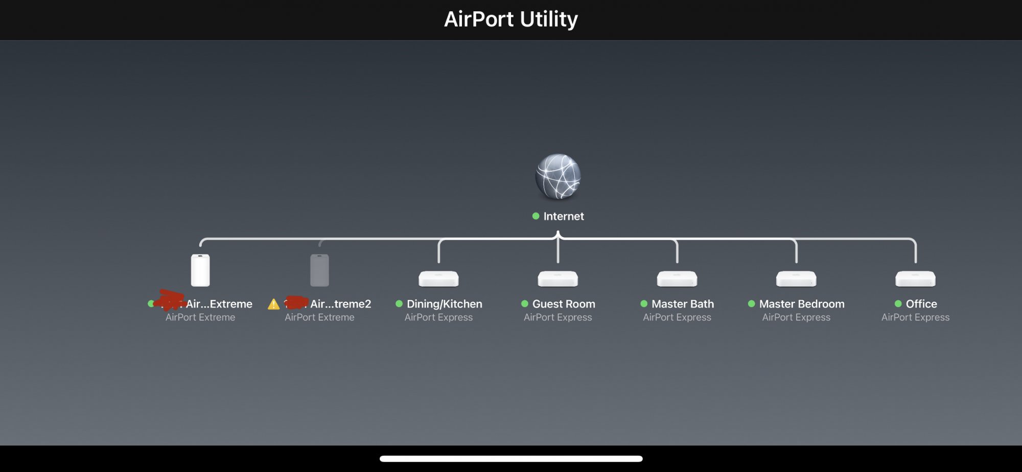

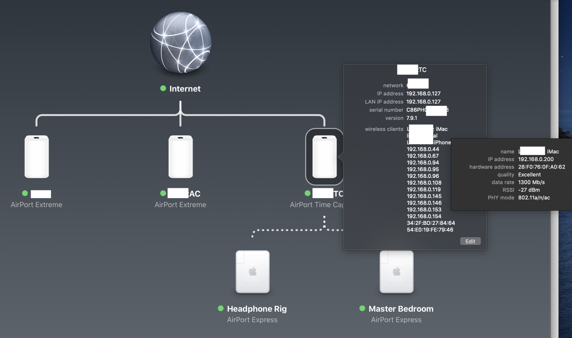

Partially inspired by @HeadphoneAddict above and others, I dusted off my old AirPort Express as an AirPlay 1 receiver, with WiFi turned off on the unit. However, since my AirPort Express is the ancient 1st gen 802.11g model, I couldn't configure it with the current version of AirPort Utility. I found out I can use my Windows 10 laptop, but it's really old and slow, and it turns out the old AirPort Admin Utility from 10.4 Tiger actually still works. o_O Strangely enough, that old iBook G4 actually feels pretty fast with that very light OS. Even more surprising to me is that AirPort Admin Utility recognized the other 6th gen AirPort Extreme models too.
And once configured, the 1st gen AirPort Express is recognized by the current AirPort Utility (although it's not configurable, nor is it listed as active).

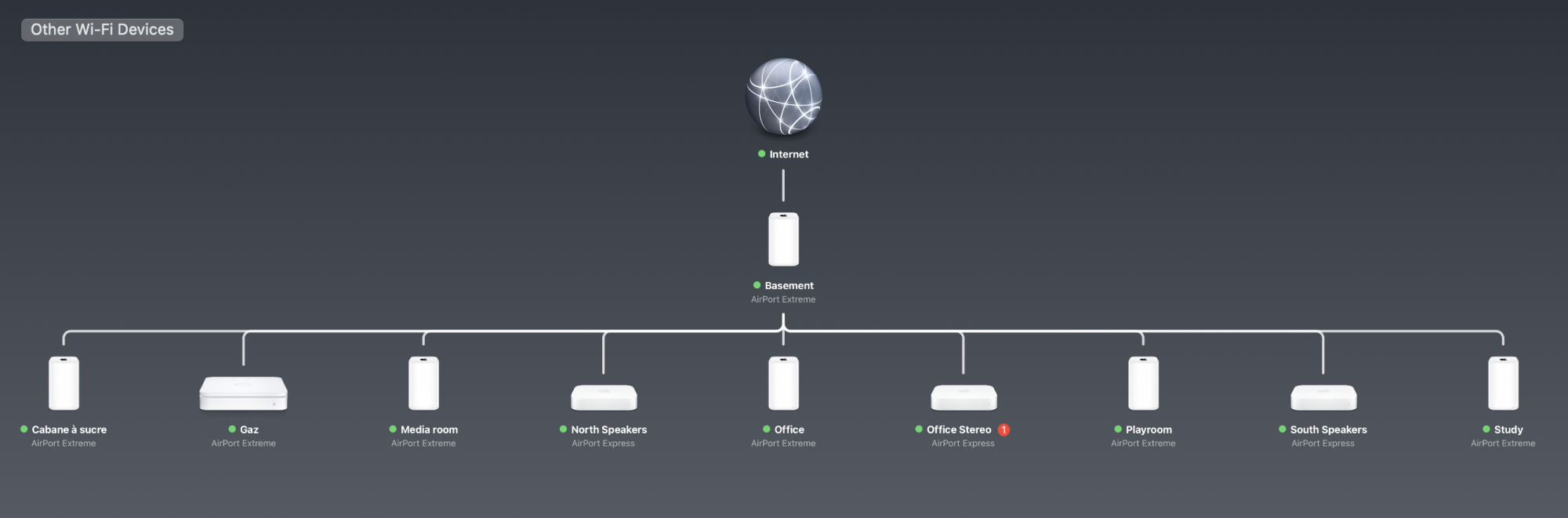

I am starting my on AirPort pseudo-mesh.
I have recently bought a new single-family home, which is larger than my current townhouse. To prepare, I have been buying cheap 6th gen AirPort Extremes. Well, I purchase two more, and I already have two.
Probably will keep adding on to it, as I have a set price in my head that I am willing to go up to, and if I see any on eBay for that price or less, I will get it.
Not sure how many I will get up to, but 10 sounds like a good number.
I have some older generations of AirPort Extremes, and a few AirPort Expresses, but probably just stick to the latest generation with the exception of using the audio port of the Expresses or making them a wireless access point for something wired.
After experiencing some problems on my single 6th gen AirPort Extreme, I decided to try an expensive, and highly rated tri-band mesh system a little over a year ago. Normally I would troubleshoot the AirPort, but everyone talks about how good the mesh systems are, so I figured it was time for a change.
The problem was, I had the same issues, and much, much more with mesh system. So, I started troubleshooting.
Living in my townhouse, I ended up having to split the 2.4Ghz and 5GHz band due to over crowding and congestion on the 2.4GHz band which led to slowdowns. I did this on my expensive mesh system, and things improved, but then I decided to do the same AirPort Extreme, and not only did the problems go away, but the AirPort Extreme was out performing the brand new mesh system.
I moved everything I could to the 5GHz band, and left the 2.4GHz band on for devices that couldn't connect to the 5GHz band. This greatly improved the performance of my AirPort Extreme.
I returned the expensive mesh system a day before my returned period ended and purchased another 6th gen AirPort Extreme to add to my network for a tiny fraction of the price of the mesh system.
So far, my AirPort network has been great, and think it will only improve at my new home with more nodes being added.
APExtreme X 2 (same name/“mesh” with Ethernet backbone) here, with X5 APExpresses wired to in-ceiling speakers.
One of the APExtremes stops showing up in Airport utility, but the device is definitely still working. If I restart, it shows up for a while, then drops off again. Have restarted, factory reset, to no avail. Has anyone seen this?

My wifi speed is normally around 100mb/s but when the signal drops by one bar it drops to a very slow 4mb/s
Ive reset the routers back to factory, changed the wifi password. Selected manual channels but this doesn’t seem to help.
Anyone else experiencing very slow speeds when the signal drops?
Stumbled upon this thread and was glad to see updated posts from 2021. I have also decided to build my own “mesh” system using Airport Extremes. I have three and a ATC which provide wifi across the house. Recently had a strange issue Im looking for help with.
Anyone else experiencing very slow speeds when the signal drops?View attachment 1903319

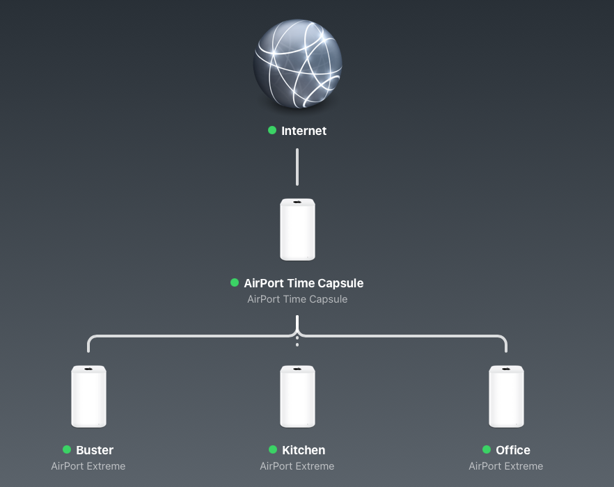

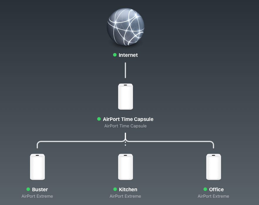

Kitchen is wirelessly extending ATC while Buster and Office are on Ethernet wire?
Buster, Kitchen, Office and ATC are using the same SSID / passphrase?
Correct, everything is hard wired except for the ATC in the Kitchen
All ATC are using same SSID and passphrase
I have questions!
  1. How does this differ from a typical mesh setup?
  2. If I have 3 Airport Extremes, with one as the base station and the other two directly connected wirelessly to the base station as an extension, do the two extensions not communicate with each other to help each other out with a better signal?
  3. Do connected devices to the network (like a laptop) only connect to ONE Airport Extreme at a time, automatically picking whichever one has the strongest signal?

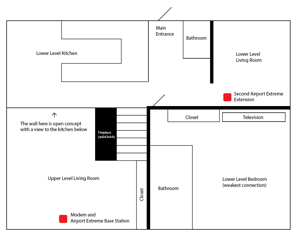

I recently setup a second Airport Extreme for my parents, their house is old and big with multilevel flooring and very dense walls. My dad's room has the worst connection, the walls in his room are REALLY dense and thick (the thick black lines are the ones with the thick walls in the photo below), so with just one Airport Extreme he's getting about 3mb/s. I put in a second Airport Extreme on the other side of his room and it's helped (drastically, about double the speed). However, would a third Airport Extreme make a difference? I could place it in the kitchen near the entrance to his room (though not ideal because the would be right next to it).
Sidenote; ethernet over powerline is not feasible, I tried a TP Link AV600 and the speeds were significantly worse.
