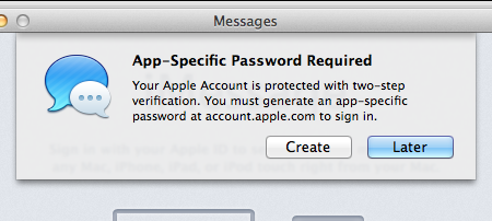

How did you get iMessage to work? I tried to log in with my apple ID, got the "error occurred during activation" message, and then I created an app specific password and tried logging in with that, and then I just got an error that.. told me to create an app-specific password, even though I already tried logging in with it.

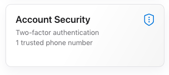

It says your account is at the "2-step verification" security tier. What if you upgrade it to 2FA? I suspect Wowfunhappy has tested against the latter. On a side note, regarding older iterations of iMessage, I wonder how new authentication methods impact some old accounts with no multifactor complexity, or with 2-step. I purposely left one of my accounts to keep using the uname-pass auth type when it was still possible (that is, six years ago).

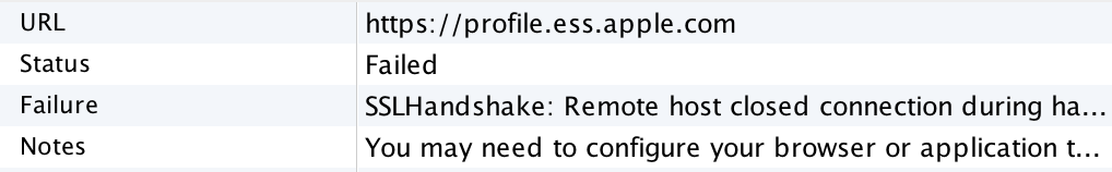

@iPodNano3 This is a great find!!! profile.ess.apple.com is one of the domains excluded from my proxy because apps connect to it using certificate pinning.
It stands to reason that if we can disable certificate pinning and actually proxy the connection, FaceTime might work again.
Oh wait, but this is with CharlesProxy?
That error is probably just be a sign of certificate pinning, not the cause of the underlying issue. It should still connect without a proxy, but if a proxy (such as CharlesProxy) is in place the connection won't work.
But something else is still wrong and it probably isn't fixable.
