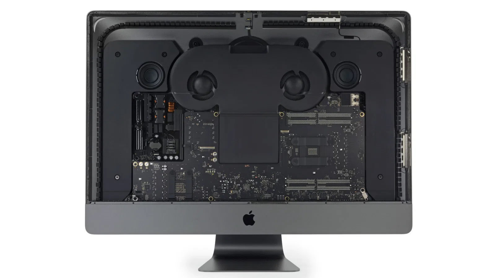

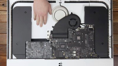

The iMac Pro features more and larger air intakes, 2 x larger fans, a large shroud that directs air from the intakes out to the exhaust, and a large exhaust port. It also features a massive copper heatsink, with shorter pipes between it and the GPU/CPU
The 'regular' iMac features smaller air intakes, just a single (smaller) fan, no shroud other than that which connects to the exhaust, and a smaller exhaust. The heat sink is smaller and the heat pipes travel longer to the GPU/CPU.
I'm not sure why people are so confused by all this as it's basic physics. The 5K iMac's thermal capacity is low in-so-much that you're willing to put up with fan noise.
