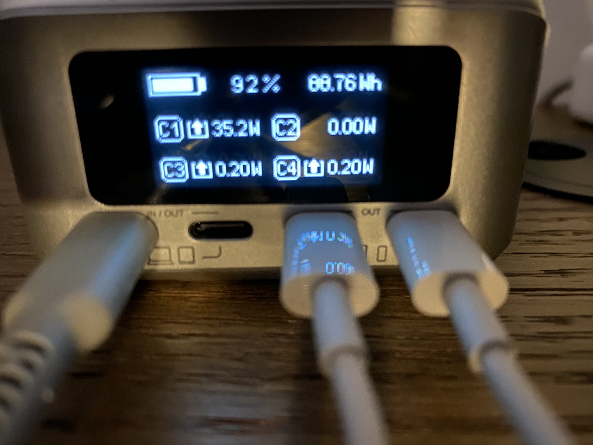

I have a Zendure Supertank Pro battery bank and it supports 100W via USB-C on a single port or 138W across ports. It supports the following 5V/3A, 9V/2A, 9V/3A, 12V/1.5A, 12V/3A, 15V/3A, 20V/3A, 20V/5A. I tried plugging my 12.9” M1 iPP in and it pulled 36W from the battery bank when the iPad was at 66% SOC. I’m not sure if it will pull more from a lower SOC but I’ll update if it does.
Wow, so the M1 iPad could definitely draw more than 30W! Would you mind testing whats the highest power draw could it be?
Same model, I got around 37~38 at 30% SOC. So I think it's limited under 40? I am using a 65W GAN charger.

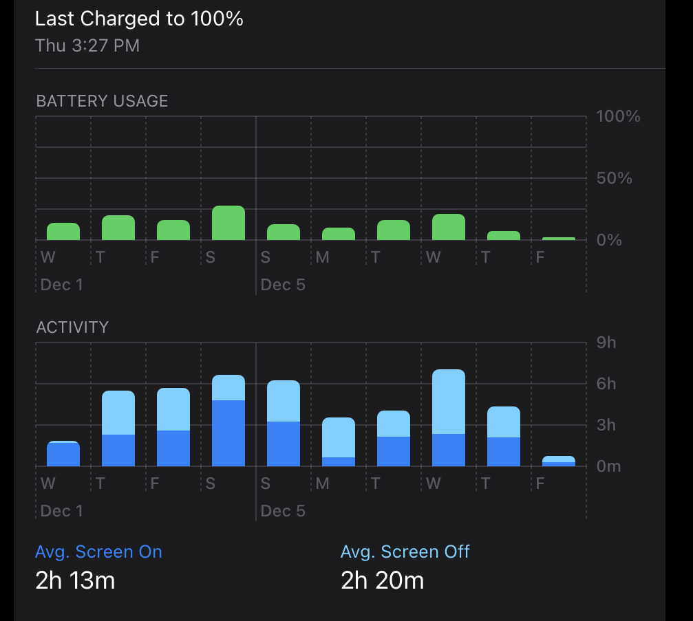

I am not a heavy user but I really like the rapid charging:
Charged to 100% yesterday cuz I accidentally left it on the charger (usually try to keep it 50-80%) - and it's still 95% this morning (8am Friday) - and I won't have to charge it again till Sunday/Monday easy.
Dang Apple News is taking up some serious screen off time....... despite background app data off.
