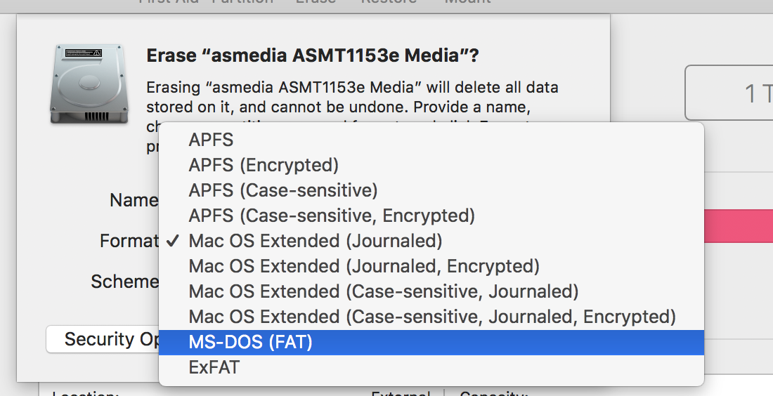

Just to clarify, if you pick that MS-DOS option others mentioned in Disk Utility, that is FAT32.

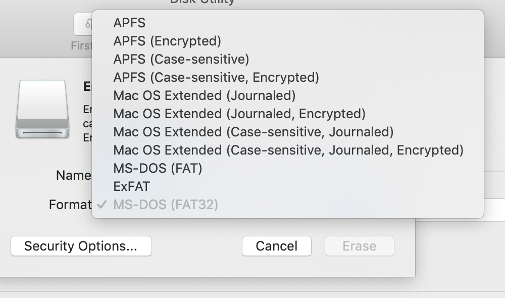

but why is FAT32 greyed out and not available? if MS-DOS FAT is fat32 then why there is a seperate FAT32 (greyed out) option?
I need to use a FAT32 formatted SD Card in another device and using regular MS-DOS FAT erase option on Mac doesnt seem to work.
My experience was until now
1) MS-DOS (FAT) was always FAT 32, although not indicated as such in Disk Utility.
2) Often there were 2 indications instead of one. For instance using a third part NTFS tool to access my BootCamp from my MacOS side like Tuxera NTFS, there appeared in Disk Utility 2 entries „Tuxera NTFS“.
I believe you should not worry about the greyed out position.
I never had when entring „MS-DOT (FAT)“ in Disk Utility :confused:FAT 16 but always FAT 32.

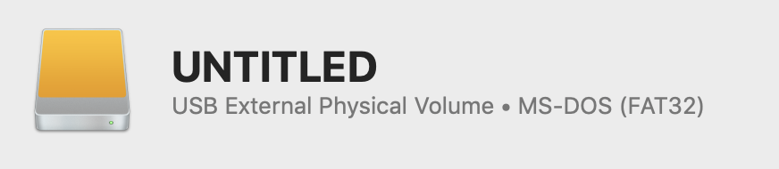

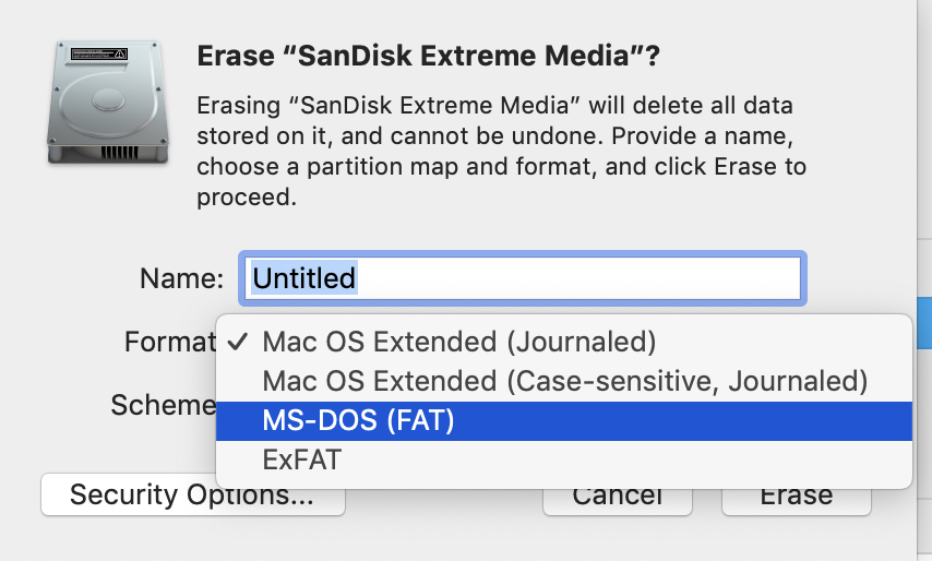

I'm pretty sure it is. Here is a USB key I formatted yesterday to copy some music to my car.
It may be you need to select Master Boot Record as the formatting scheme to get it to work with your device.
View attachment 867091 View attachment 867092
well in my case it was not the same.as I said,I needed a USB drive formatted with FAT32 specifically and using MS-DOS(FAT) the device wouldn't even detect it,until I used the SD Format App and specifically selected FAT32 then it worked.
Also,why are there both MS-DOS (FAT) and MS-DOS (FAT32) options in latest MAC OS (see screen shot I posted above) if MS-DOS (FAT) is the same as FAT32?? makes zero sense.so there must be a difference.
I suspect it’s because you have a 3rd party package installed with a filesystem extension that causes this.
