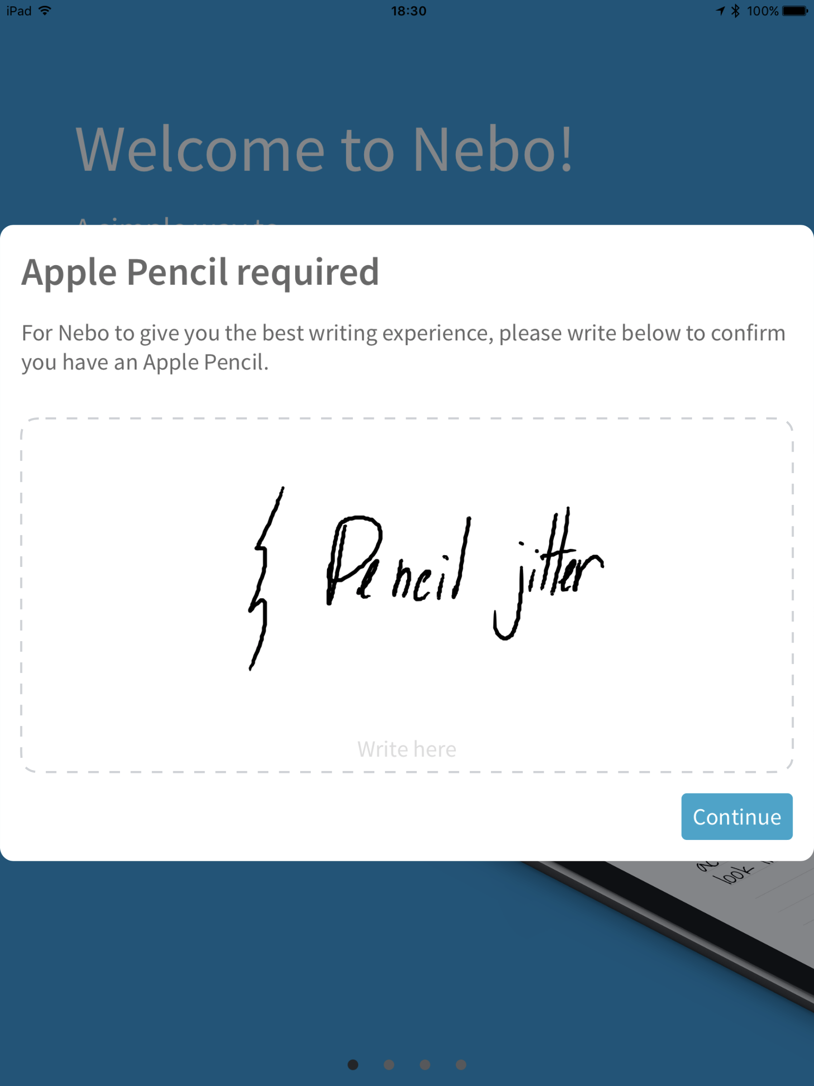

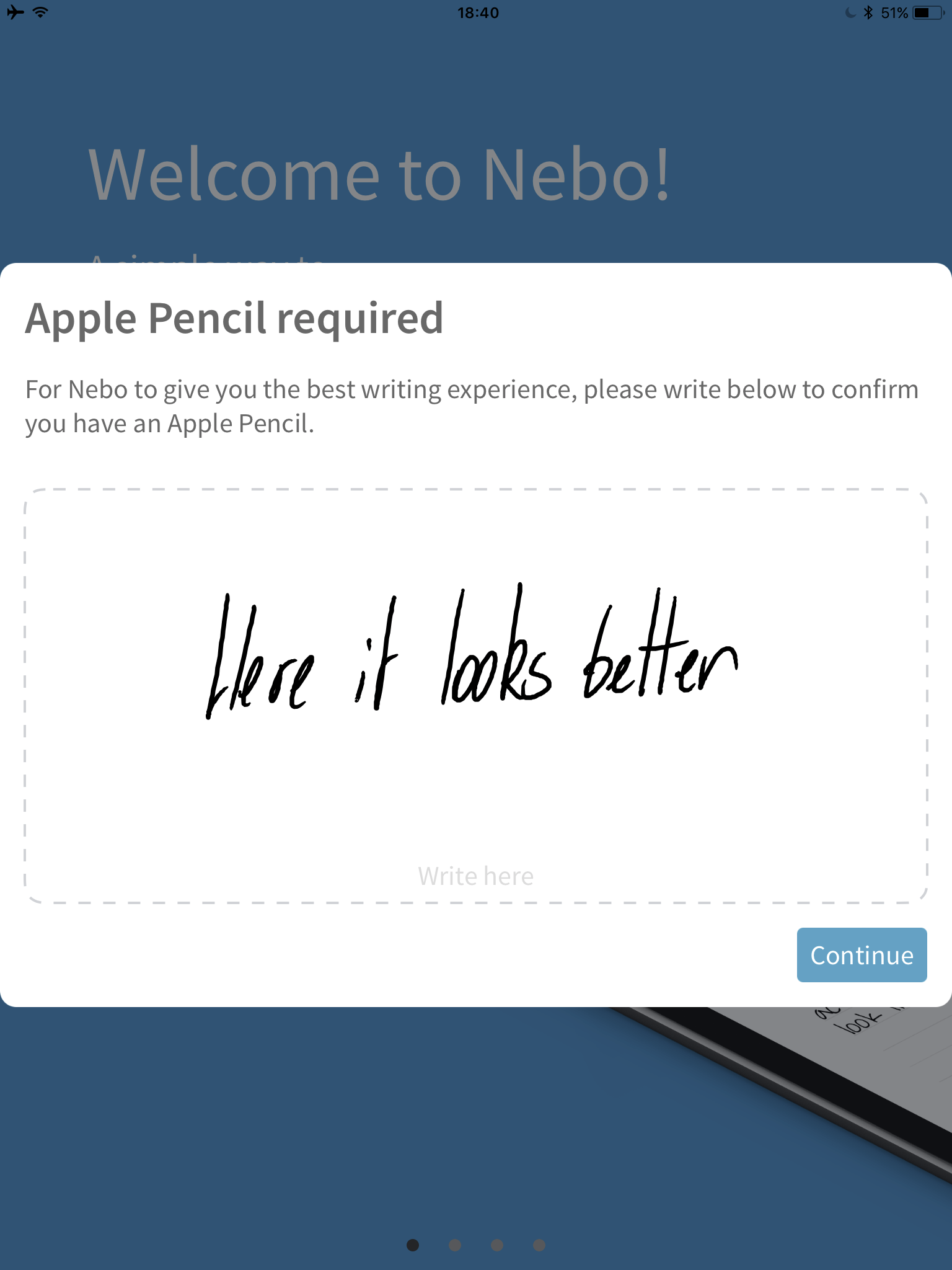

The issue also appears in Nebo:
Old iPad 9.7:
New iPad:

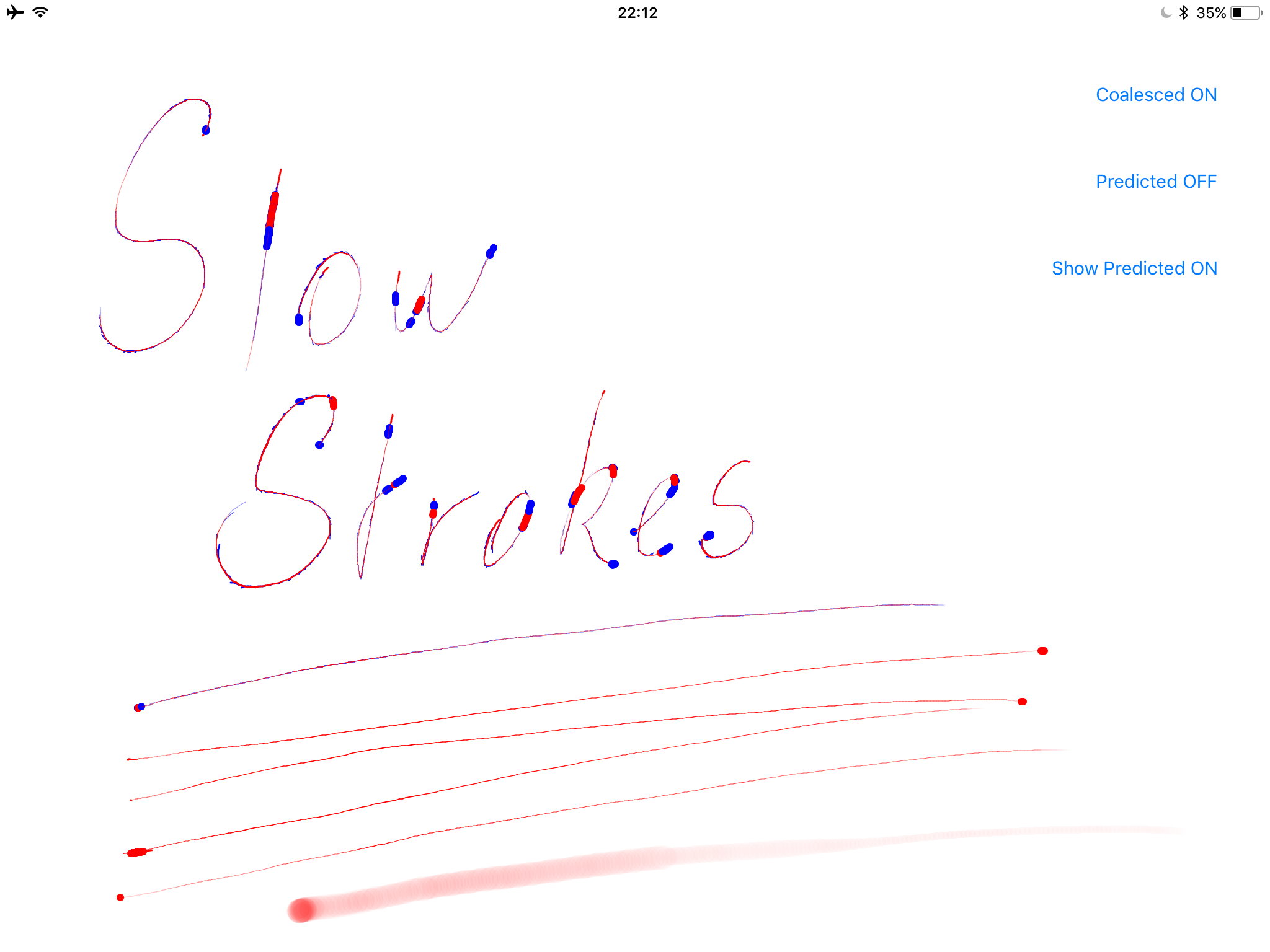

I have researched this further. I found an excellent web resource on Apple Pencil input processing in iOS apps. That page contains runnable code that allows one to see raw pencil strokes with various layers of processing added to it:
  • To account for ultimately limited speed of apps, iOS offers 'coalescence' on touch events, i.e. it records touches for you while you might have been busy processing previous touches
  • It offers prediction on where the touch (pencil) is heading
In below screenshots, the strokes are red and the predictions are blue.
iPad Pro 9.7: Here, the blue predictions actually stay close to the actual trajectory that was drawn. As a result, the curves are also smooth.

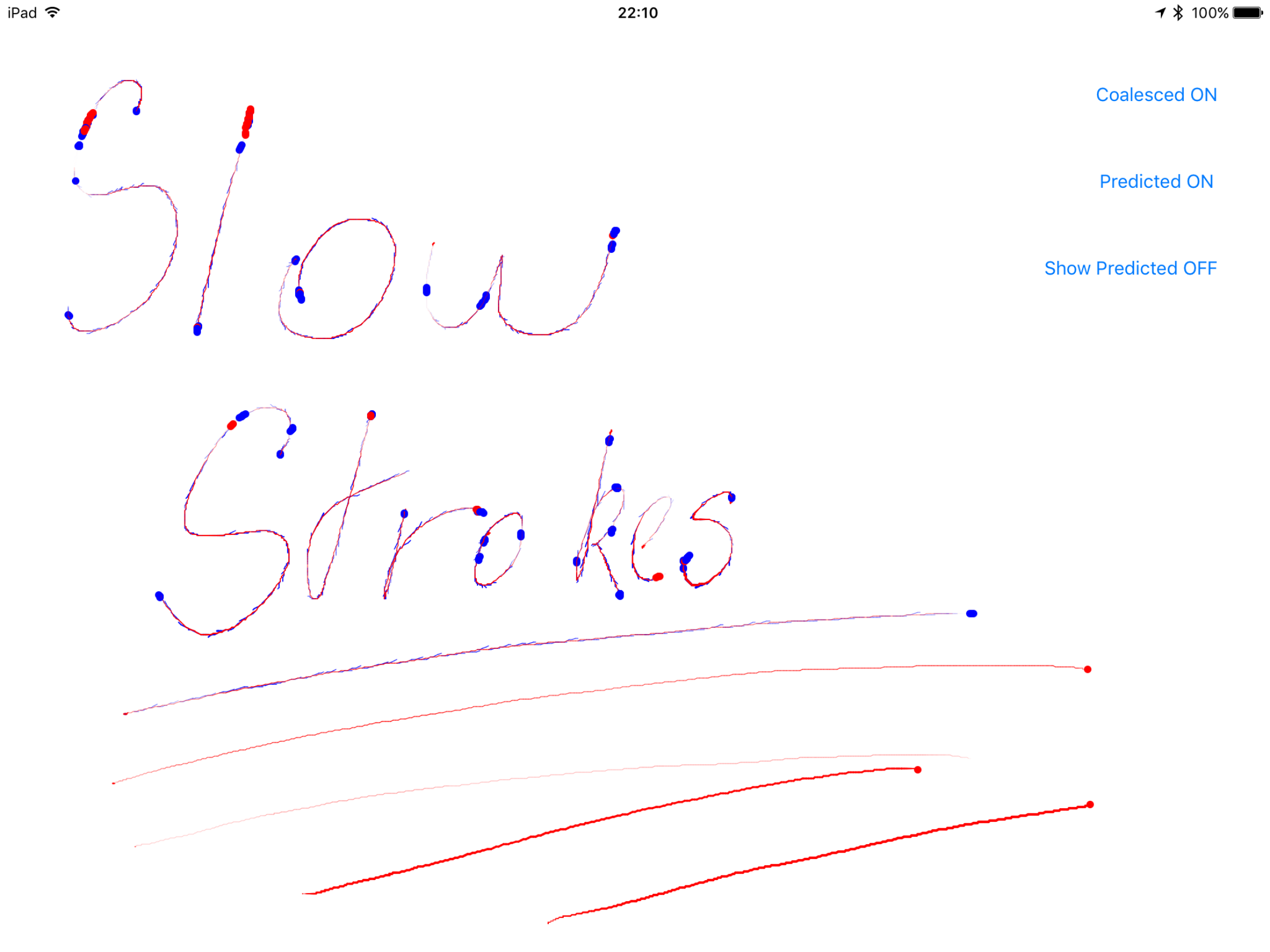

iPad Pro 10.5: With a similar drawing style, the blue predictions deviate significantly from the drawn line and seem to extend further. This might explain why the ultimately drawn line looks so jagged.
That still doesn't solve my question: is my iPad faulty or has something changed in the way the iPad supplies touch events to the apps, i.e., should I exchange my device or just wait for apps to be updated?

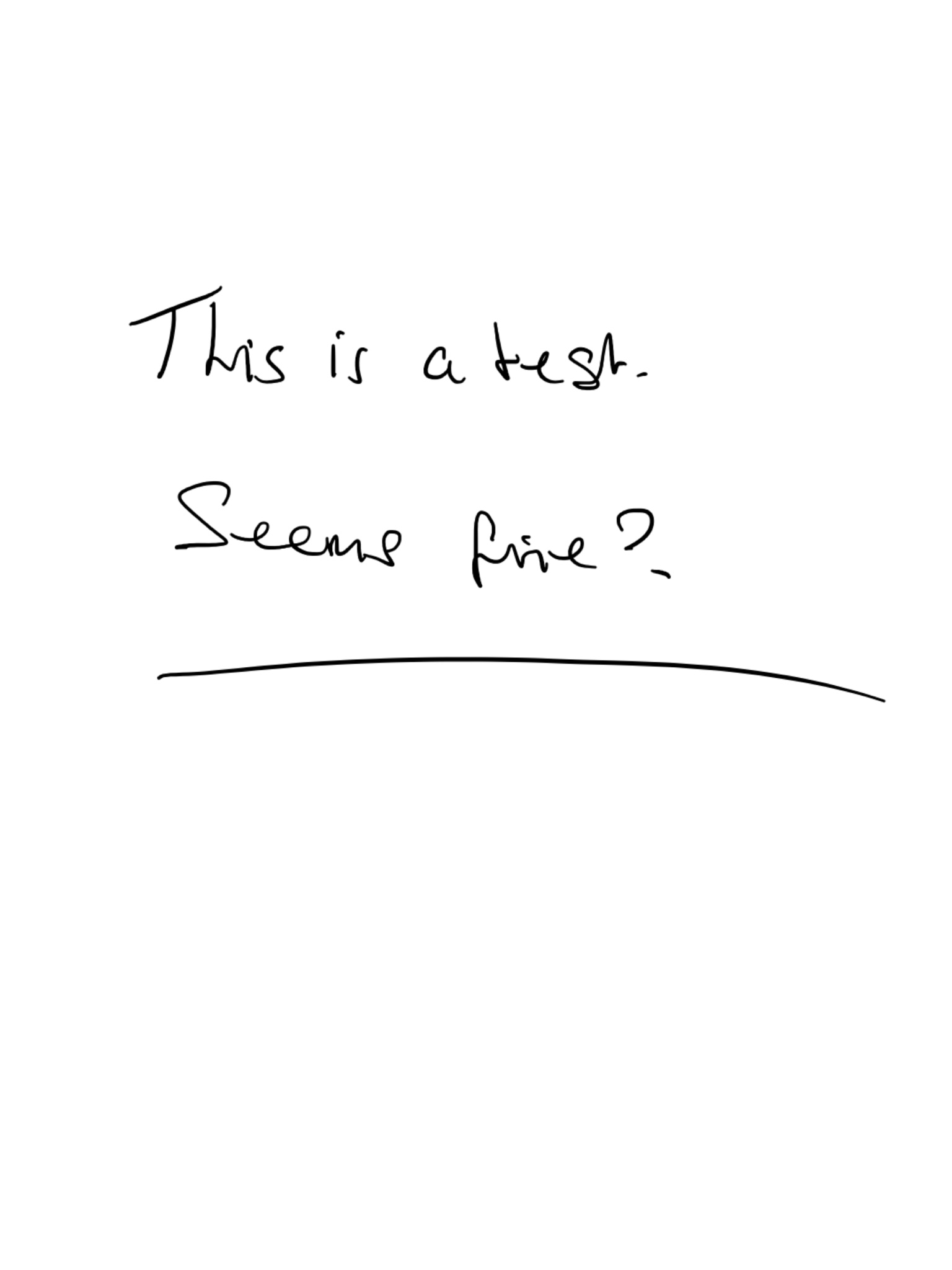

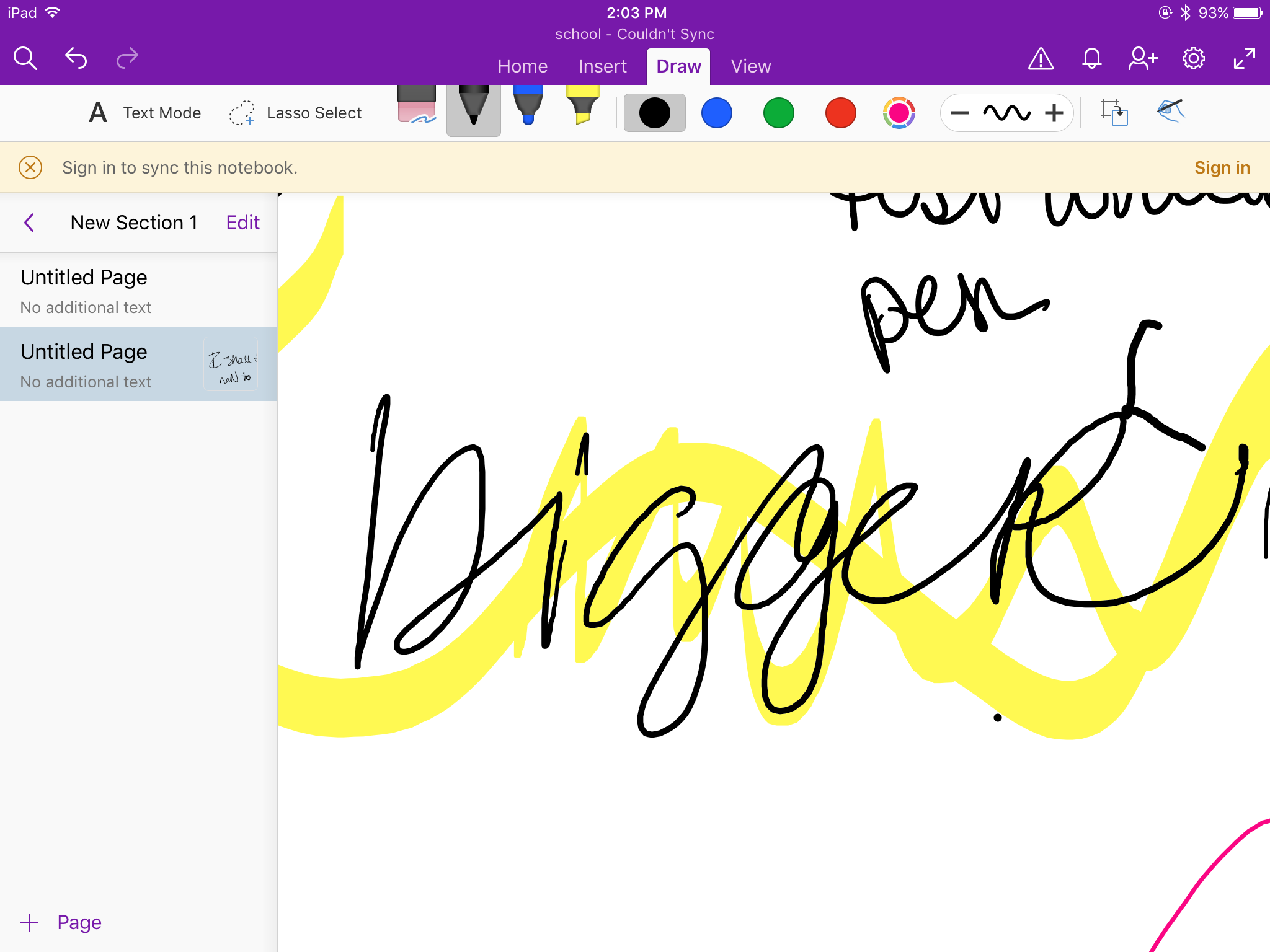

Actually, i just zoomed in where I was doodling around the other day and see some spots that i would call jittery. That would be on a 9.7 with OneNote 16.0, and with a pencil received from BB this past week.
I wouldn't call it a good test though because my experience using the pencil is minimal - kids don't share well with mom! LOL
ETA: I'll bow out - but will be reading because I will be using OneNote myself. But here is the screen snippet I just took of what I wrote. This was written zoomed in on the page. LOL, sorry if you saw my daughters flight info instead. AirDrop went haywire.
