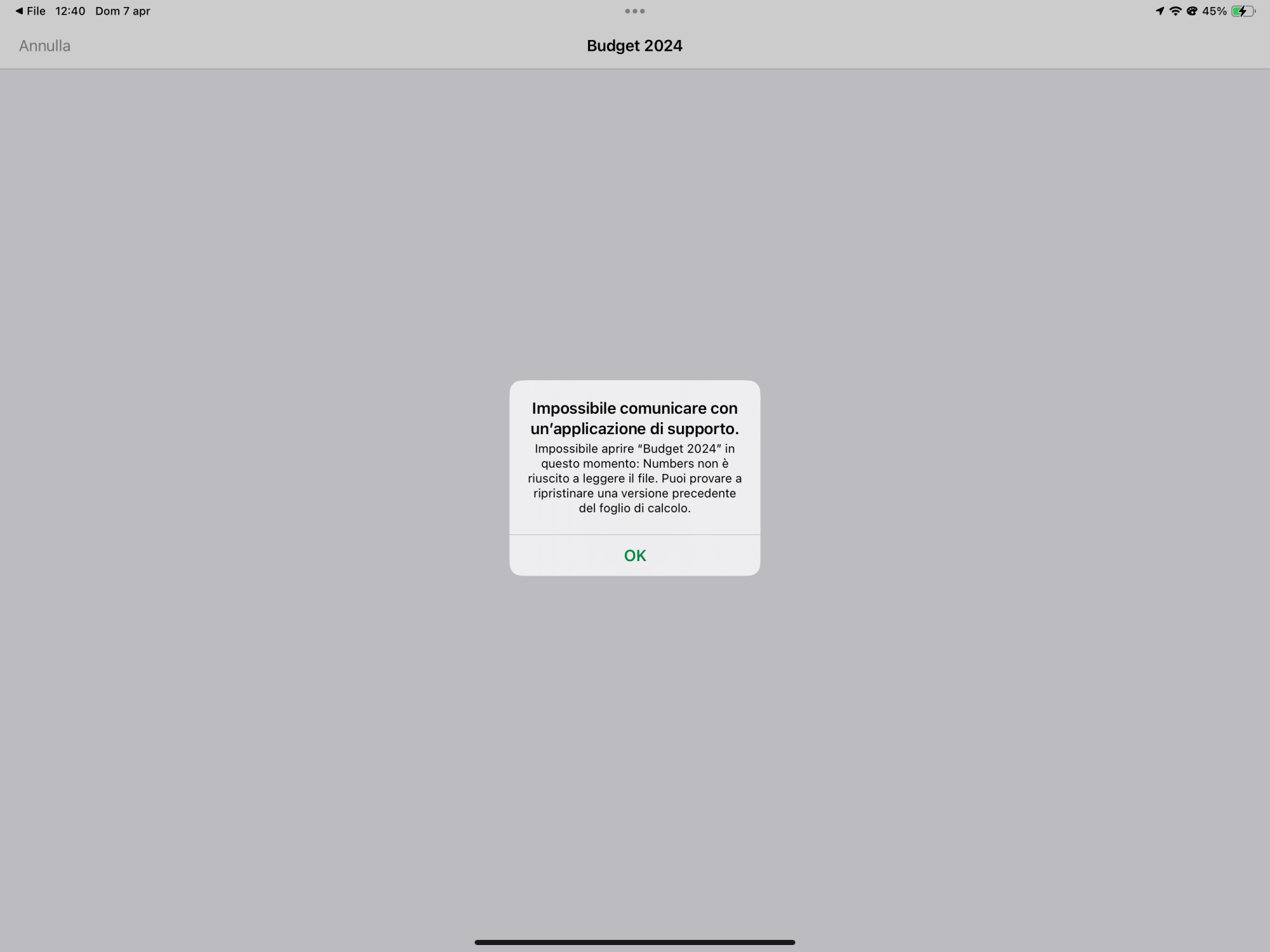

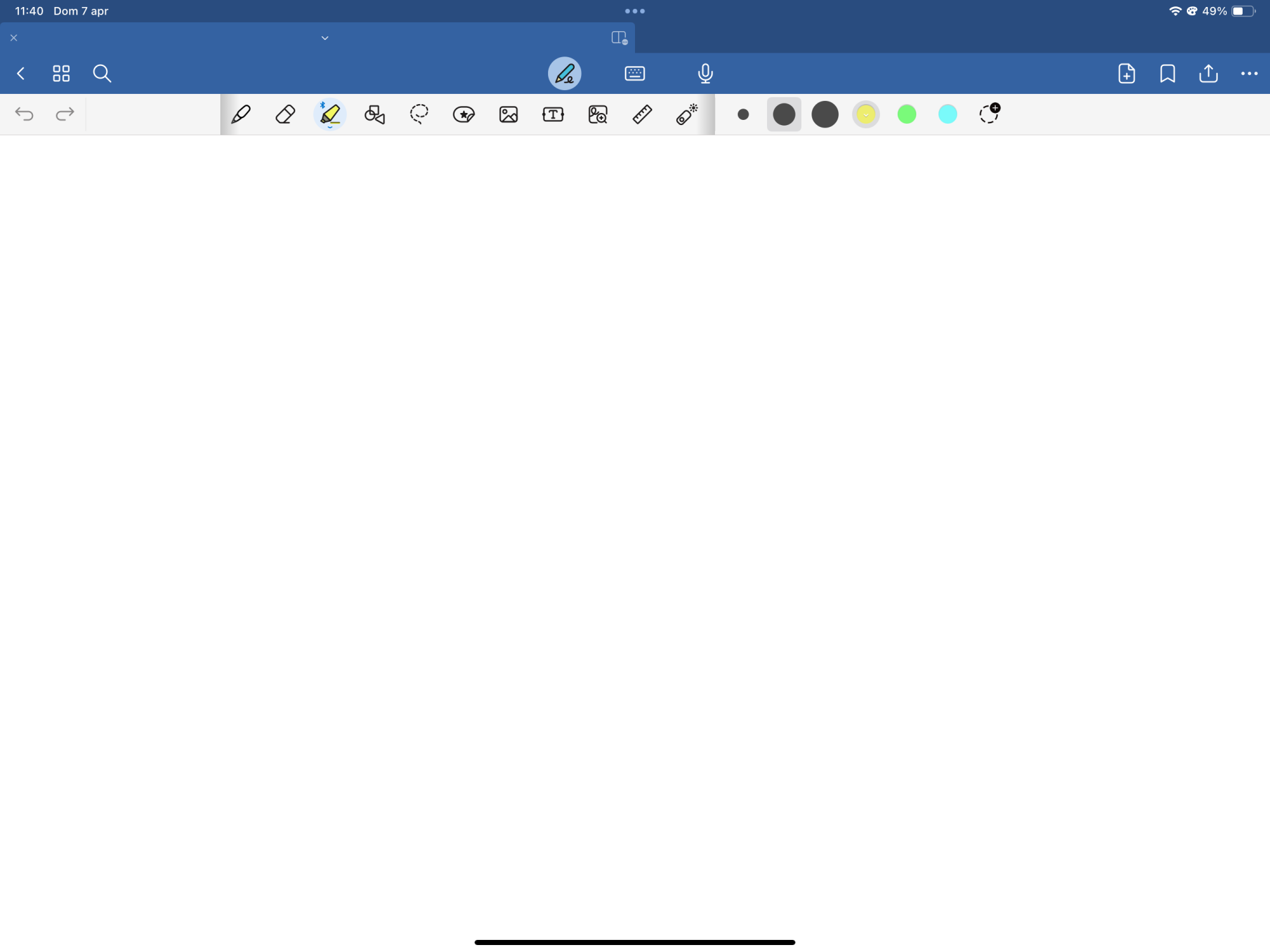

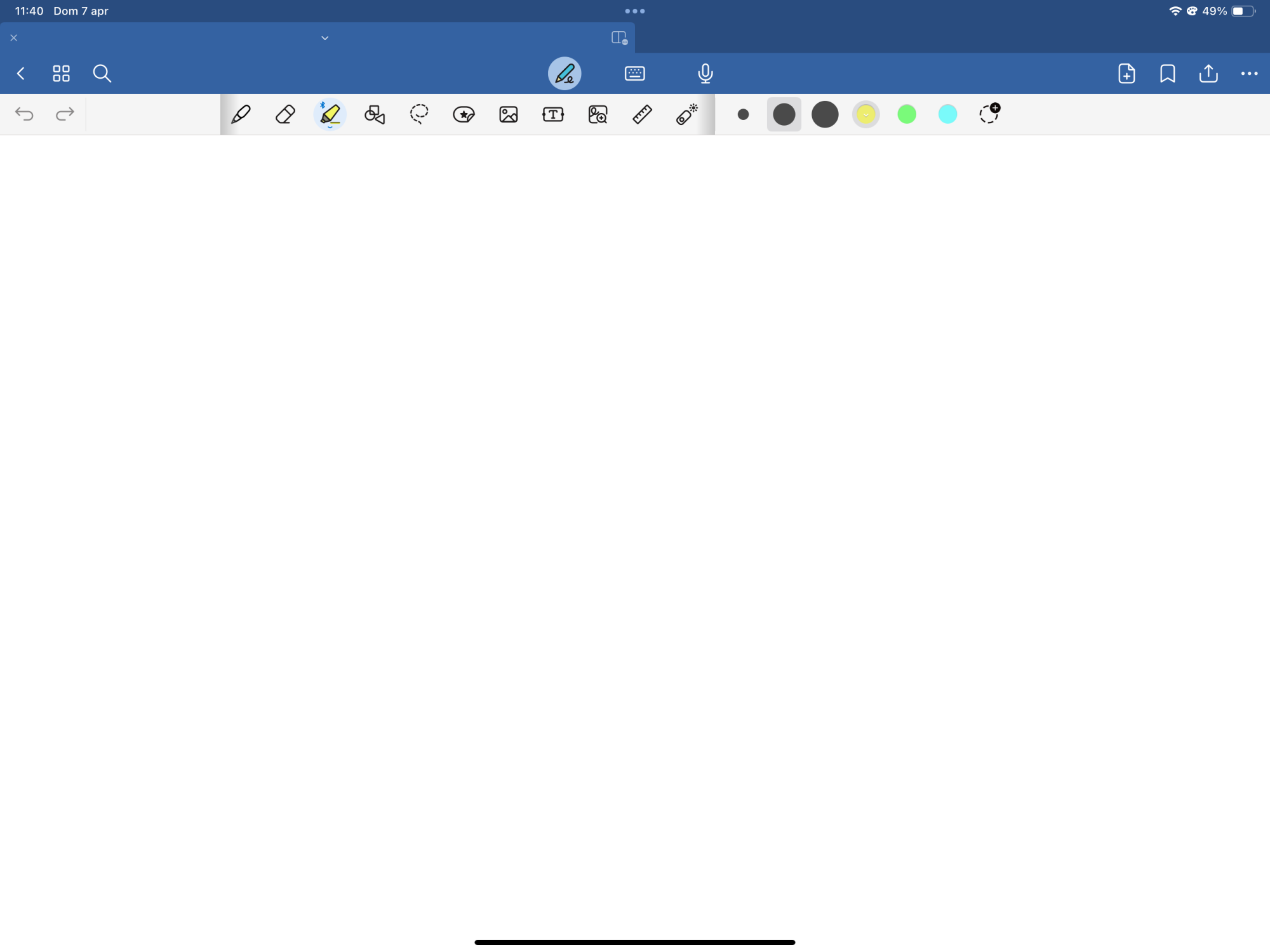

I have been having this kind of issue since Friday (5.April) evening (iPad Pro 2018, 12.9-inch, iPadOS 17.4.1).
It all started with the Files app not responding (not showing deleted/updated/downloaded... files), then it propagated to other apps. Every app using iCloud Drive as its base is opening with a blank browser screen (the left-side bar is usually there, but unclickable).
Now Files, PDF Viewer, Numbers, GoodNotes, ..., everything I tried that works with Files opens to a blank screen, nothing else. After a while the app in question crashes. I tried to launch Mail, Safari, Acrobat, ... they all work well and as expected.
I tried to Uninstall the Files app, and then reinstall it. No change.
Force restart or ordinary shut-down, turn-on procedures make the system work for maybe a minute, but not always. Then everything is blocked again. I believe something happened with the outage Apple servers received last week, but my Mac and iPhone are working more than fine.
I believe I will try the following steps, unless someone else has better ideas:
1. deactivate iCloud Drive on iPad. Restart the iPad. See if the apps resume working. If not...
2. log out from Apple ID. Restart the iPad. See if things get back to normality. If not...
3. I'm downloading the Restore image and will try to reinstall iPadOS without Restoring the device. If it doesn't work...
4. Restore the iPad completely. If it doesn't work... I will contact Apple Support.

assuming you have not some important uniquely stored in Apple‘s Files - delete Files and restore it from the Appstore.
I believe all Local-only files are stored in the Files app, aren't they?
I can make a local backup of those, of course, and try that.
One hour ago, I have contacted Apple Support, and engineers should be looking at why my iCloud Drive appears to be stuck. From an early diagnosis by Level 2 Phone Support, it looks like I have thousands of empty files in iCloud Drive, which of course I cannot see but that they can see.
My very personal instinct is that this is caused by Adobe apps. Whenever I open (on Mac) an Adobe file that is originally located in iCloud Drive, it creates a temporary backup file that is crucial for data recovery if there ever is a crash. I suppose iCloud Drive doesn't like those.
On the iPad, this all started when I exported a PDF of about 20 pages to SVG files from the Illustrator app for iPad and saved them in the Downloads folder in iCloud Drive. Ever since, the iPad has been unusable for anything related to files stored in iCloud Drive.
How those among you who use Adobe CC manage their files? Where do you save them? Locally and then make backups to Cloud Storage? InDesign cannot save directly to Adobe Cloud, for example.

If it makes you feel better, the problem is solved after fully restoring the iPad.
According to Apple Support engineers, my iCloud Drive was clogged with small temporary files (cookies, orphaned plists, etc...), which caused the iPad to "think" indefinitely until it timed out and crashed. They couldn't explain why my Mac and iPhone do not show the issue, but restoring appears to be the only way out of this.
Or... try to log-out of Apple ID. The iPad will work perfectly fine! But if you need iCloud Drive as I did, you will eventually have to log back in, and ... the problem will arise again after few minutes from logging in.
I still think that Illustrator did something bad, but it could've been also a corrupted installation of iPadOS over the last updates because several issues I had reported as bugs in the last 6 months solved themselves with a restore. I thought the pain of my Windows days was behind me, though...
