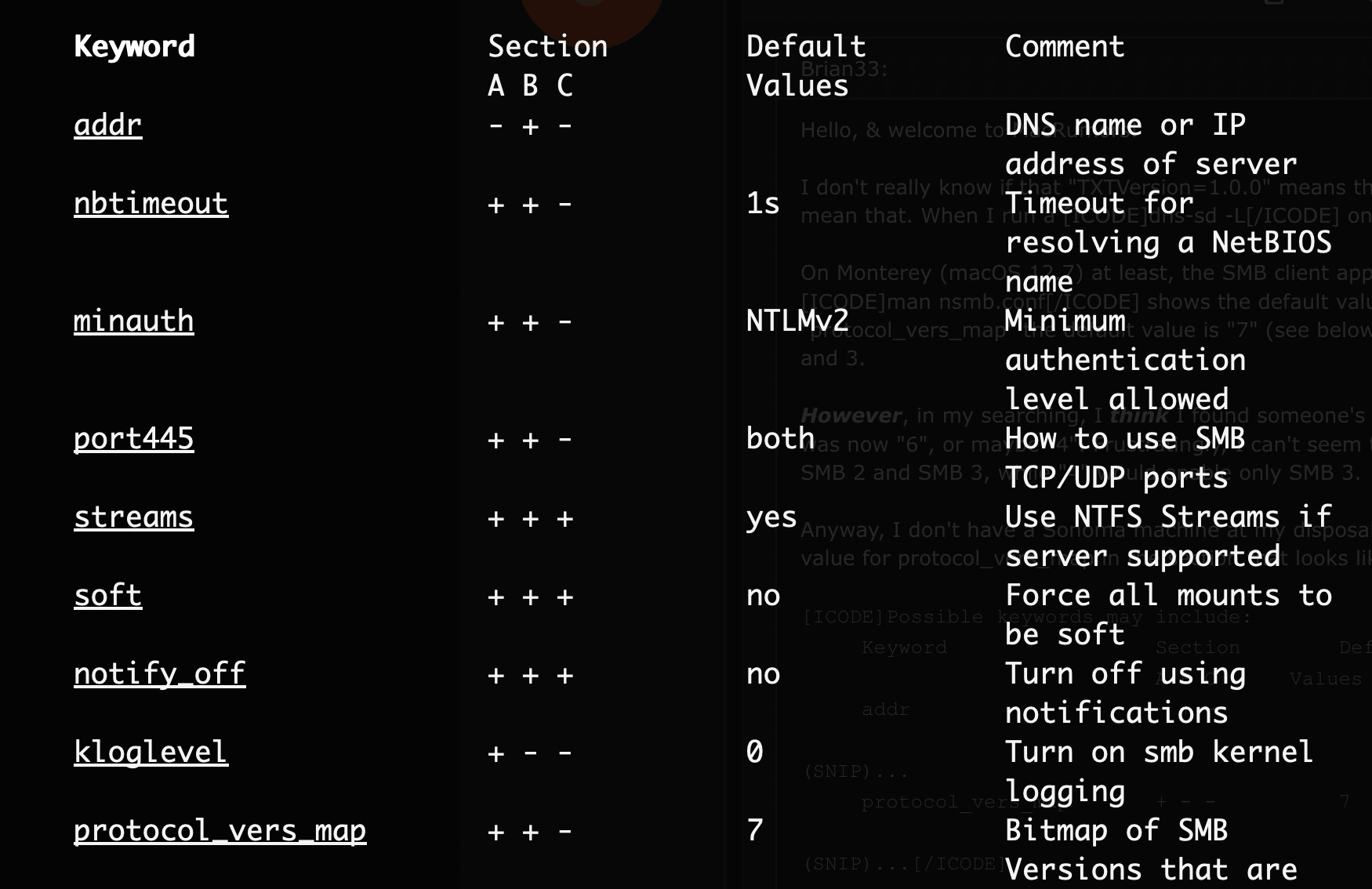

On Monterey (macOS 12.7) at least, the SMB client appears to support SMB 1.0 by default. I say that because man nsmb.conf shows the default values for the SMB client (not smbd!), and it says for "protocol_vers_map" the default value is "7" (see below), which is the bitmap value to enable support for SMB 1, and 2, and 3.
However, in my searching, I think I found someone's post that this value has changed for Sonoma, and that the default was now "6", or maybe "4". Frustratingly, I can't seem to find that page again.... But if it's true, "6" would enable only SMB 2 and SMB 3, while "4" would enable only SMB 3.
Anyway, I don't have a Sonoma machine at my disposal -- can you run man nsmb.conf and look at the value for protocol_vers_map in the section that looks like this:
Possible keywords may include: Keyword Section Default Comment A B C Values addr - + - DNS name or IP address of server (SNIP)... protocol_vers_map + - - 7 Bitmap of SMB Versions that are enabled (SNIP)...
I'm curious if it has changed from 7 to some other value in Sonoma. ??
IF it has changed to 6 or 4, that might be the issue! It appears that you can create a nsmb.conf specifying "7", and put that file in either ~/Library/Preferences/nsmb.conf (to affect your user account only) or in /etc/nsmb.conf (to set the value for all users).
I haven't tried this, but it looks like the file could be just the two lines:
[default] protocol_vers_map=7

The man nsmb.conf on Sonoma reports :
I notice that in Sonoma A B C = + + - for protocol_vers_map where as your's was + - -
I am not sure I understand what it means.
JM
That part's not too important -- it just specifies which sections of the config file that keyword is allowed to appear in.
The critical part is the default value of 7 -- which we now know is the same for Sonoma and Monterey. The 7 means that, by default, the SMB client does support SMB protocol version 1 (as well as 2 and 3).
So, your issue isn't as simple as the client refusing to use SMB 1 with your "WD TV Live Hub" device. (Of course there might be a bug introduced in Sonoma.)
