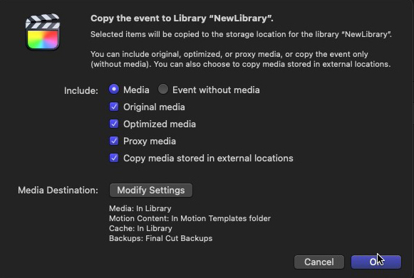

Okay, weird one.
I have a few events that are no longer needed. I deleted the files from the library directly (my bad) and this has left me with 'phantom' events.
Basically FCP thinks there's an event there but it has no associated files so on start-up it says 'Library corrupted, files missing'.
I have tried to delete the Events but it seems to be a catch-22... without any content they can't be deleted but because they are there as Events they are seen as corrupted.
I tried the File> Move event to trash route but the option to do so is greyed out.
Any suggestions?

One potential solution: make a new library, copy the good events to the new library, delete the old library.

Copy the event to Library
Copy or move items between libraries in Final Cut Pro for Mac
https://support.apple.com/guide/final-cut-pro/ver397277a3/mac
Thanks bogdan & sorry for the delay in reply.
A couple of the libraries were on one 12Tb external drive so that solution actually worked well.
Obviously didn't just drag them but moved from one library to the other in the FinalCut window and then deleted the old library. As it was just moving stuff around on the same drive it didn't take long.
There were a couple that were on separate, smaller drives without the room to create duplicates before deleting but they are mainly archive drives so I can live with just dismissing the error when I load them up.
Reactions: bogdanw
