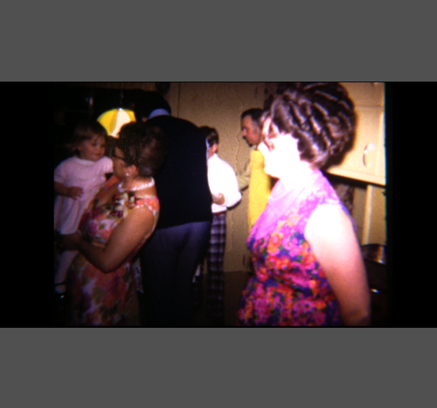

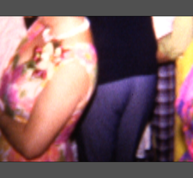

I am trying to create a new project/sequence/ from an old one by selecting and copying clips from the old sequence to a new one. I get varying degrees of success. Some of the newly copied clips are just like old ones as one would expect. However, some are distorted aspect ratio-wise, and some are just magnified so that part of the frame is missing.
Anyone have an idea of what is going on, or better, how to fix it?

The only "effect" I have applied is crop, and that has been applied to all of them. Don't know why I would get effects I didn't use. Only some of my copies are corrupted. The rest have copied with no modification. Really puzzling.
