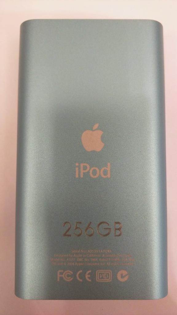

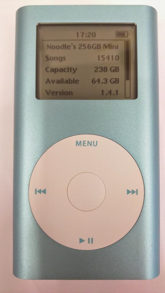

Well finally finished my Mini upgrade. Currently have over 15,000 tracks on it and only using my db file is only at 28.5MB. Getting an average of at least 20 hours straight play time.
1 Used 2G iPod Mini 4GB
1 Tarkan CF-SDXC Adapter
1 PNY 256GB SDXC
1 Custom made 256GB 1G iPod Mini housing

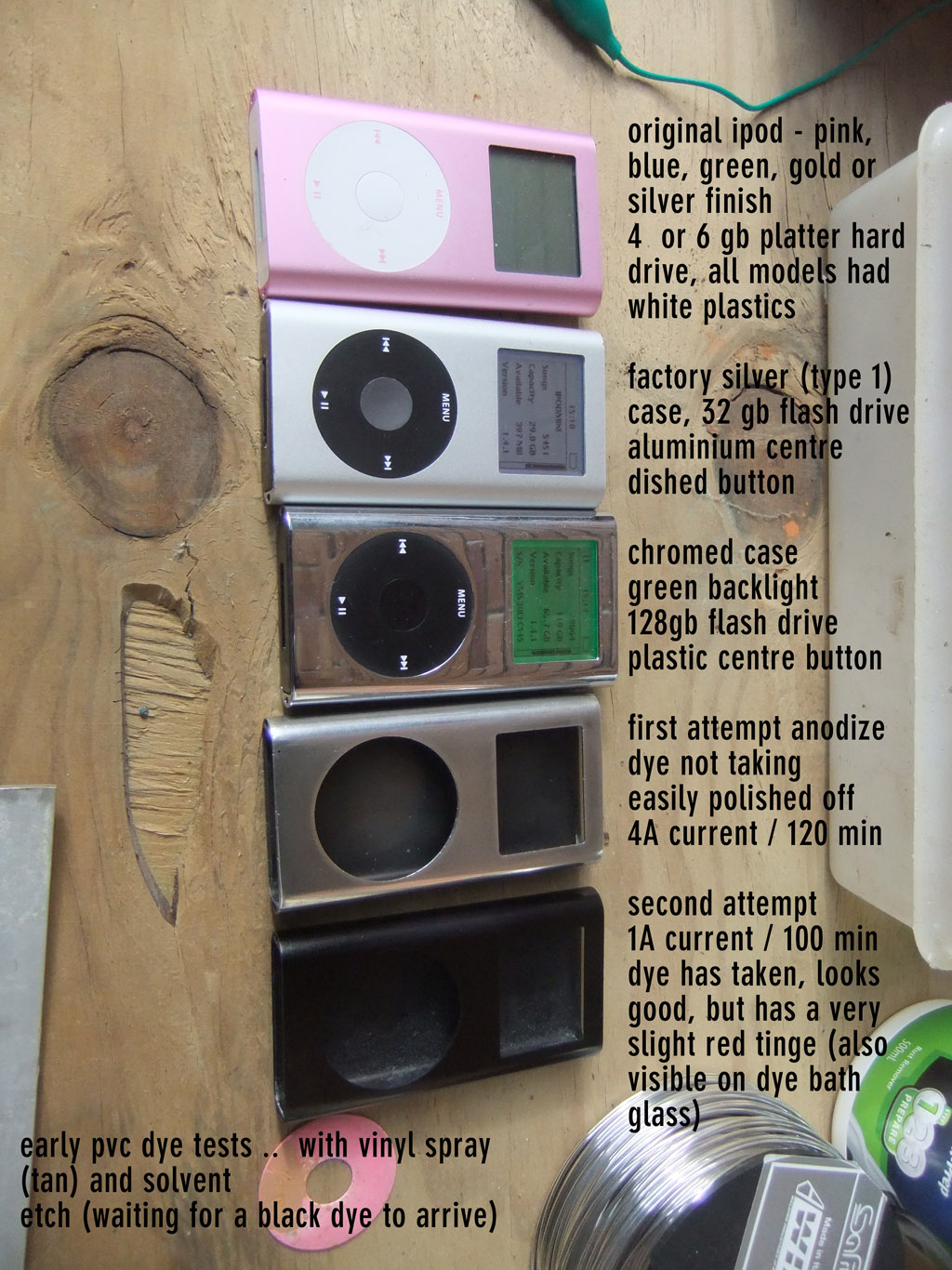

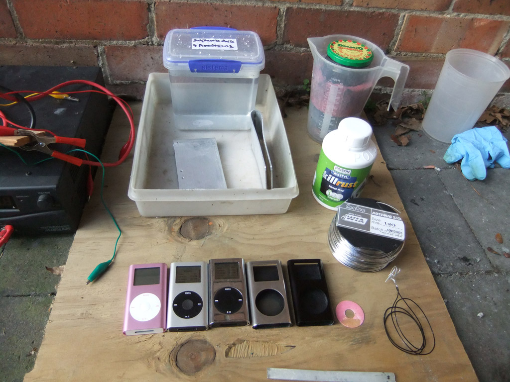

.... addendum to my ipod-mini modding post ... https://forums.macrumors.com/thread...od-mini-see-pics.1843060/page-2#post-22198866

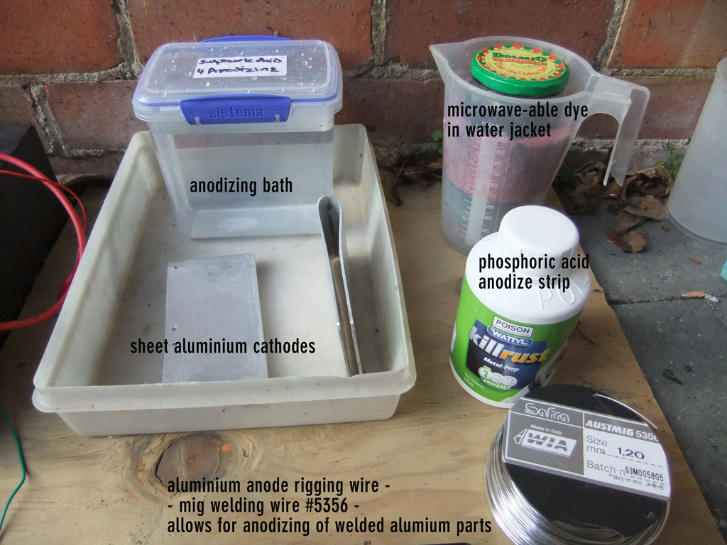

remove Apple applied anodizing by soaking in phosphoric acid for one or two days ... you can buy that from a hardware store as clear-as-water rust remover
best anodizing receipe i used after some experienced third party advice and experimentation
· 20 to 23 degrees celius ambient temperature
· 2 to 3 amps for a single ipod-mini case (approx 26 square inches exposed surface area)
· 7 to 9 volts (NON-switching power supply)
· 180 minutes
after removal from anodizing bath (33% battery acid + 67% distilled water, which equals approximately 11% pure sulphuric acid + 89% distilled water) , then rinse, optionally dye, and seal in boiling distilled water

optionally, dye in a bath, preheated to 50 deg.C, no additional heat applied, so probably cooled to 40C over 1/2 hour, use distilled water - i used a tall 500ml glass jar placed in a plastic jug so i could surround the glass jar with hot water and cap the 'hot water jacket' with a kitchen sponge -- this can be easily heated in a microwave prior to suspending the ipod-mini case within the jar ... the black dye i got as a powder from ebay, but i suspect it is merely laser-printer / photocopier toner and was opened by border customs inspectors who thought it could be an illegal narcotic ... it had a slight red tinge when applied to the case, but this tinge dissappeared after a few days
to close the aluminium pores (sealing) boil for 1/2 hour ... in distilled water, no sealant chemicals added, as i don't have any ... i just bought a cheap electric kettle / jug to boil the ipod-mini case in
i used aluminium mig welding wire to suspend case from an aluminium support strip acting as the anode bus bar (positive 7 - 9 volts) placed on top of the anodizing, rinse, dye, and sealing baths, last photo (at the botttom right) shows how i looped it to press fit within the interior of the ipod-mini case, and the support strip which connects to the positive side of the power supply ... the two larger aluminium sheet metal cathodes connect to the negative side of the power supply

at the time these photos were taken i was experimenting with recolouring the PVC material used in the endcaps on a unused white ipod-mini click-ring ... the tan vinyl spray was old and lumpy because it was from the bottom of the aerosol can ... in the end, the best results i got for recolouring the end caps was black vinyl (auto uphostery / carpet) dye, removed from an aerosol can, and applied with an air brush
