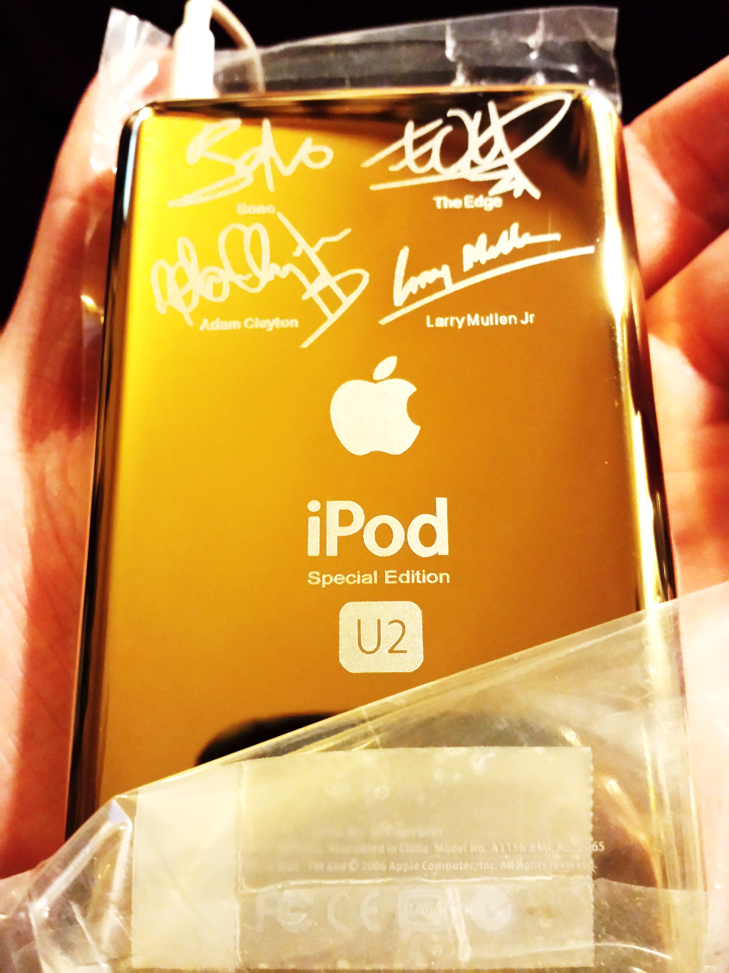

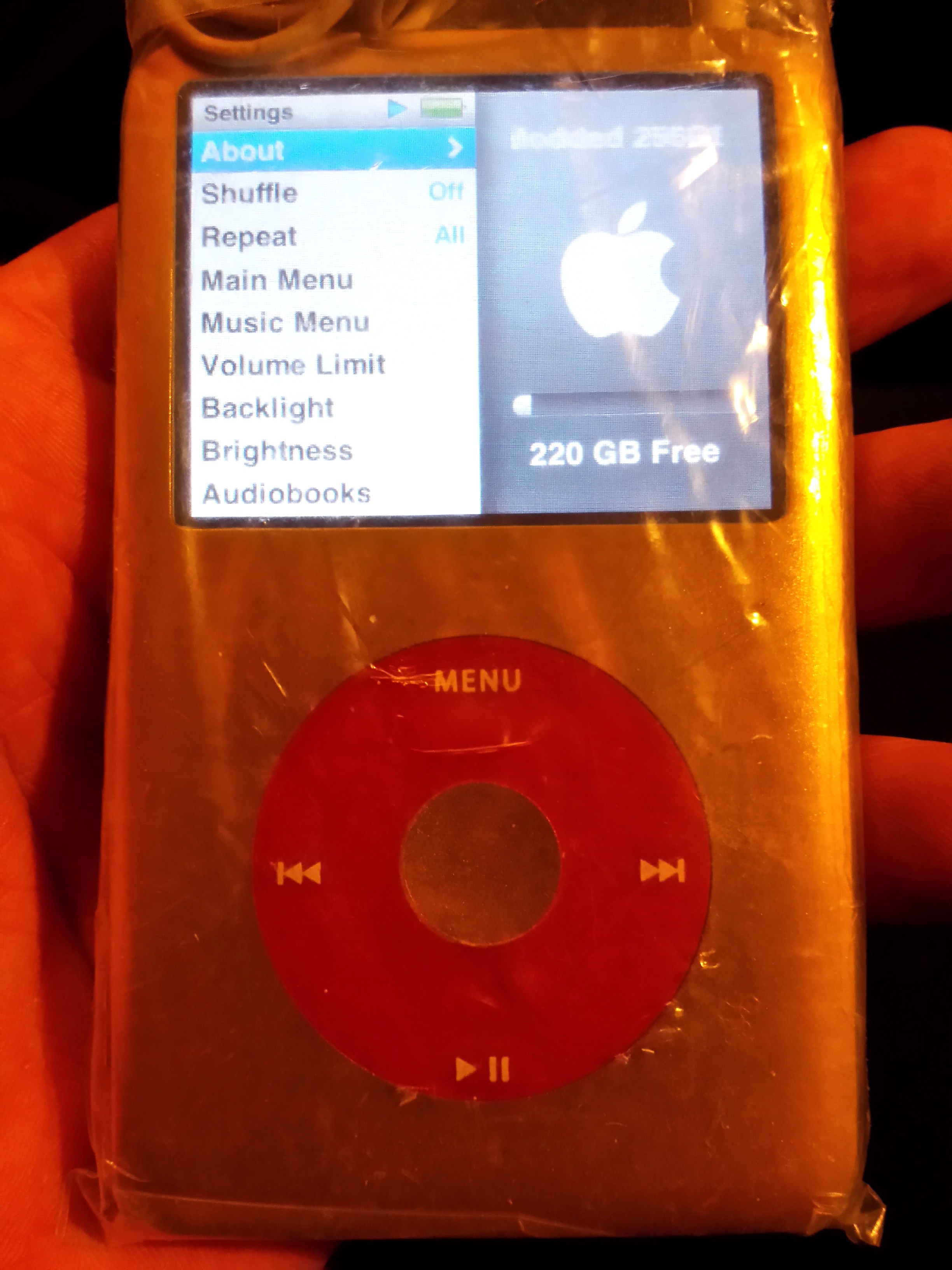

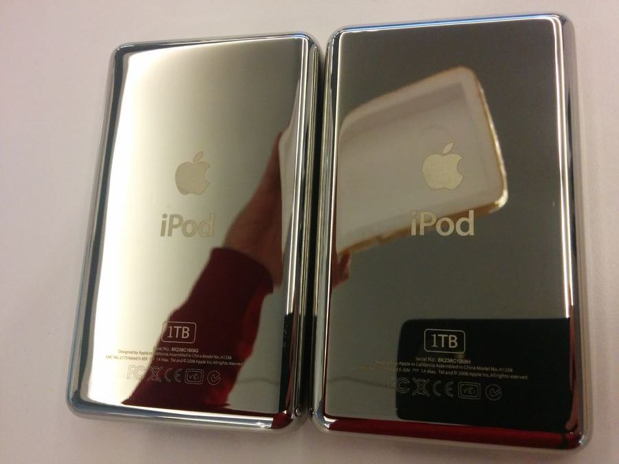

Just got my thick back 1TB replacement metal back. Time to work on turning my other 7.5G iPod Classic into a 1TB ALAC Monster with 2,000mAh battery. Probably won't get started until January though, still reconverting my music to 320Kbps .mp3 for the 256GB Classic.
Did u order order that battery from China? I ordered one with the thick back for mine. Going to do the mSATA mod probably 500GB.
I ordered mine directly from the guy in China. He is on the Headfi boards. I already had the thick back with the 1TB markings on it.
Where did you get those backs from?
The 256GB I picked up off of eBay and I linked to the eBay store for them.
The 1TB I picked up off a forum of someone who ordered 160GB replacements and was sent 1TB so I don't know where to find them. I tried looking everywhere for them. Would love a thin 1TB backing.

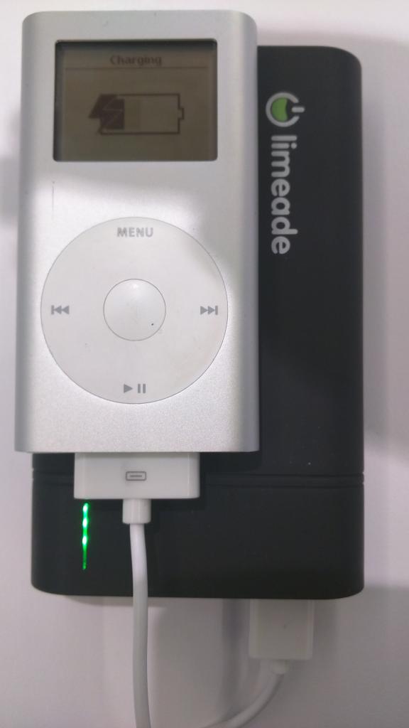

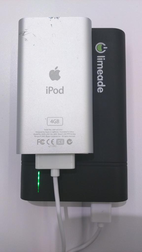

Next project. Time to convert the iPod Mini to 256GB and up the Classic to 512GB.
Installing an SSD into an iPod Classic in place of the hard drive

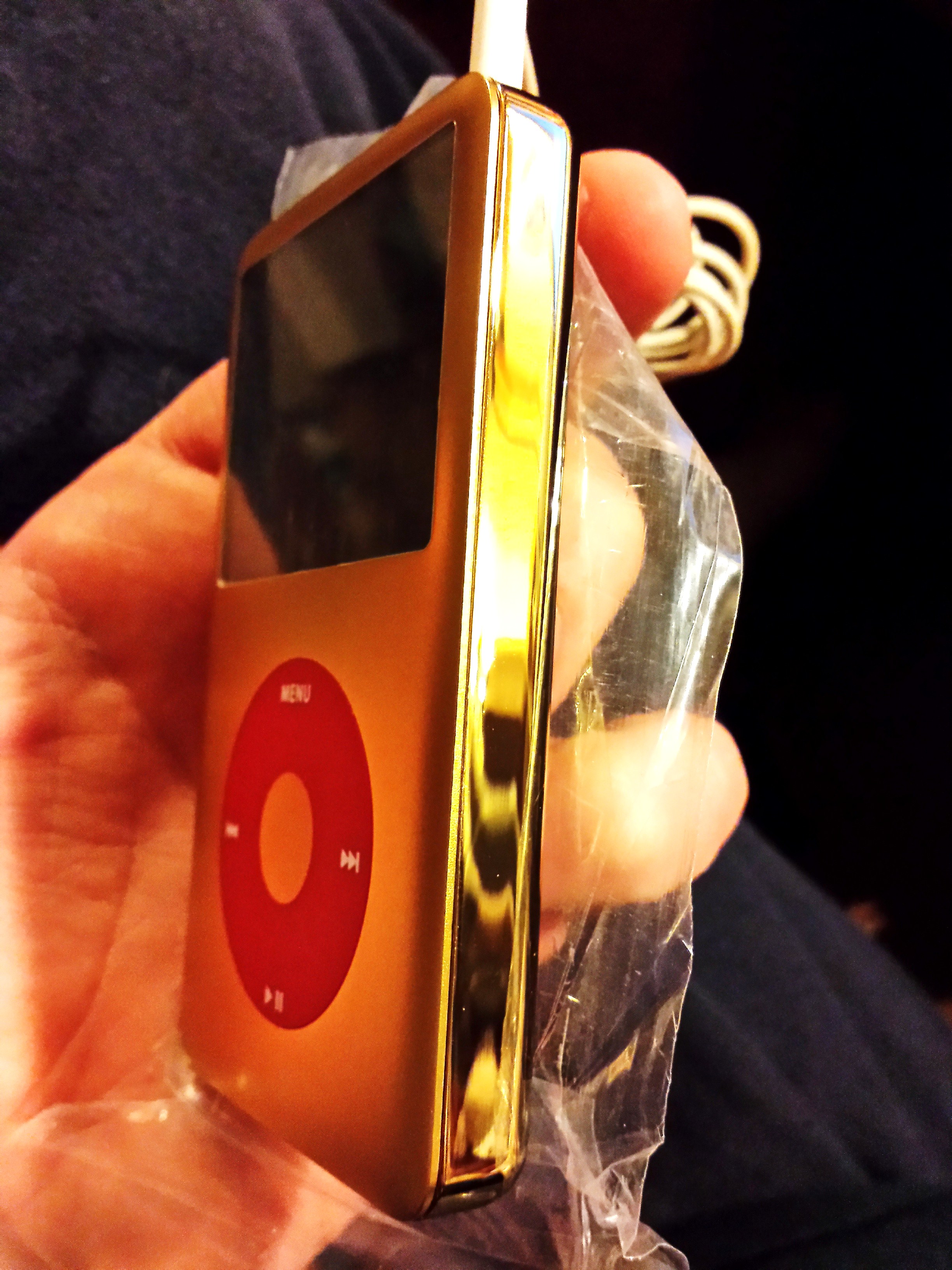

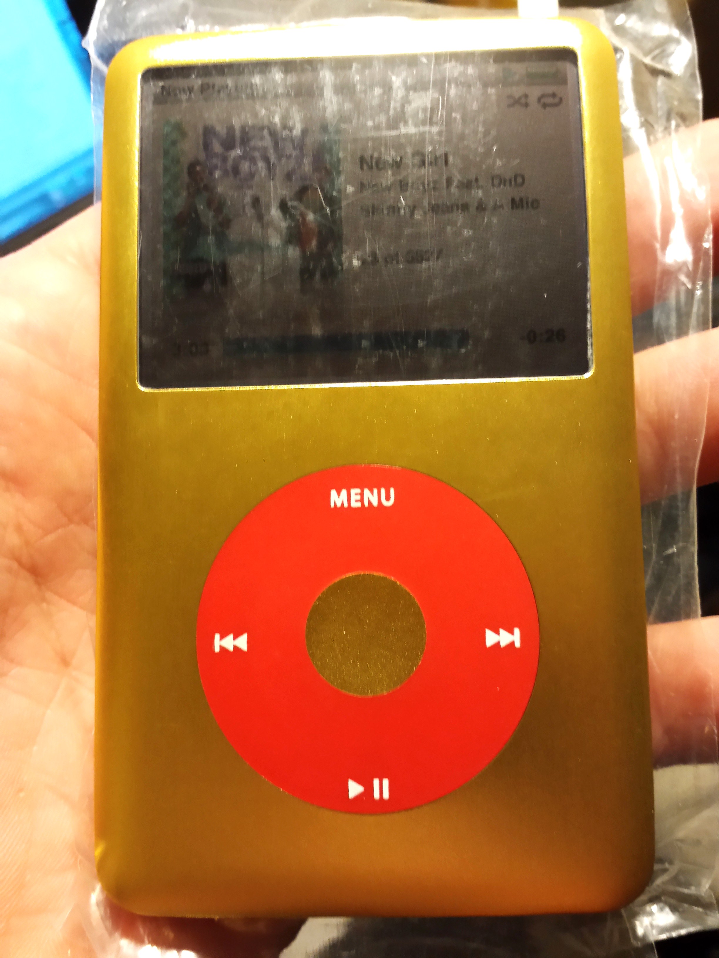

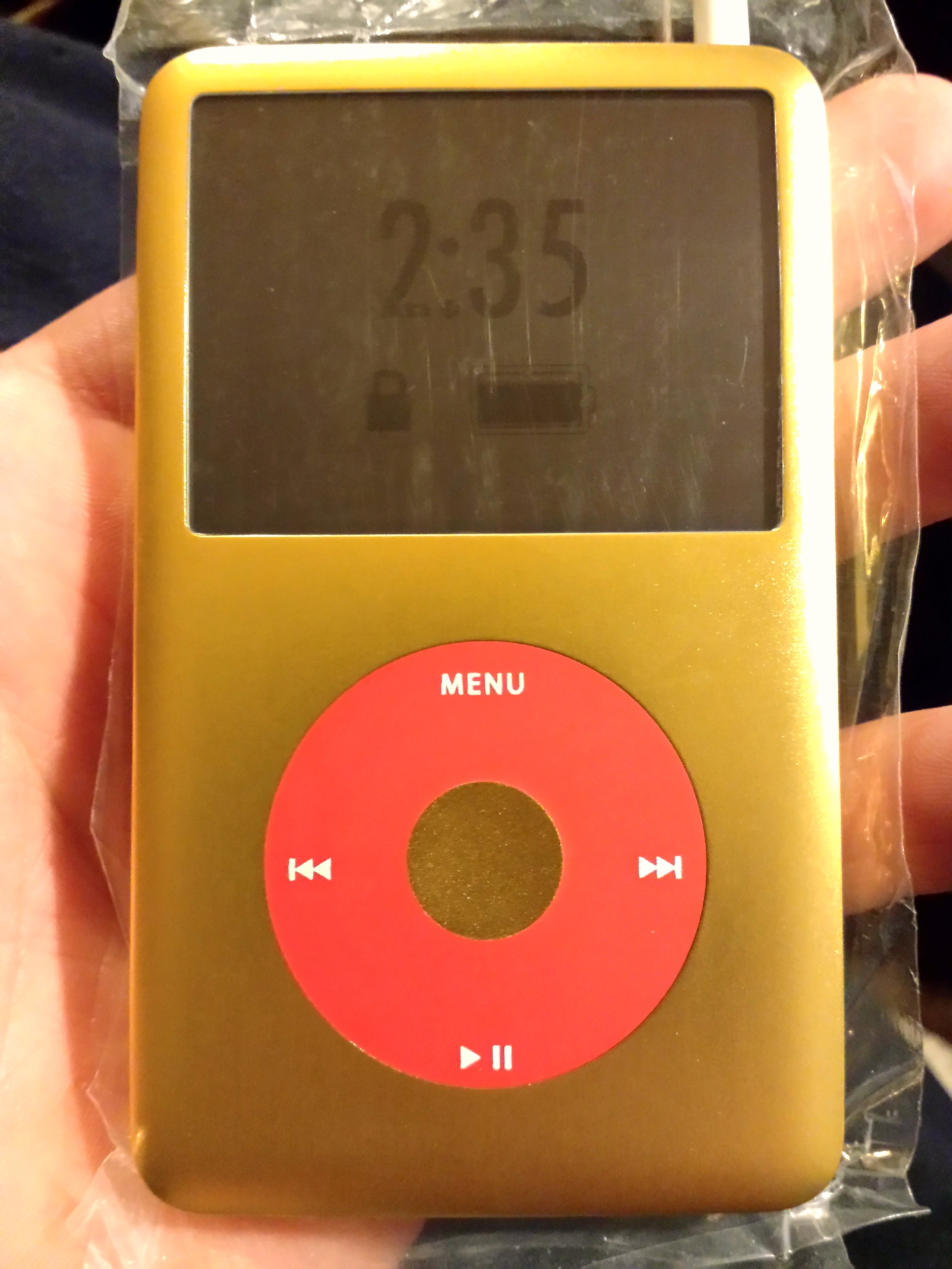

Here's some pics of this latest project I've done.
https://www.flickr.com/photos/131371374@N08/
It's a 7.5G Ipod Classic 256GB mod. (I could have went
the 512GB or 1TB route, but opted for the 256gb for
the time being with this one.)
I did this mod with a gold faceplate, red clickwheel,
gold center button, thick gold U2 back plate, a 7.5G
motherboard (7th gen thin 160gb board), a Tarkan
SSD iFlash adapter, Samsung PM851 256GB SSD,
and lastly a 1900mah battery, (which is why I went
with the thick back plate with this one. With this
battery it's a tight fit, but pretty much a perfect
fit at that.)

Ipod Classic 7th gen 256gb SSD Mod - Gold U2 Version
Ahhh, ok, figured out how to upload and imbed pics...
here you go for anybody interested.
Hit me up with any questions you may have.
I'd be more than happy to help you out if you'd like.
