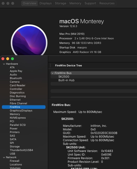

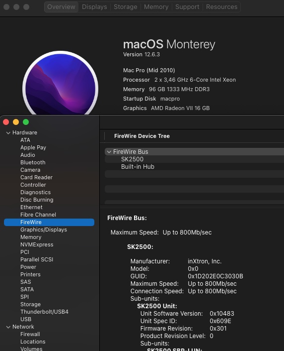

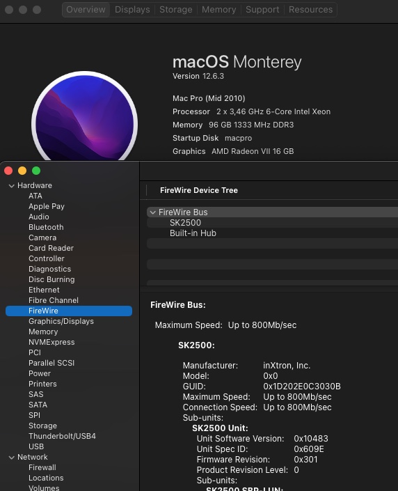

firewire work well on monterey
(also under big sur)

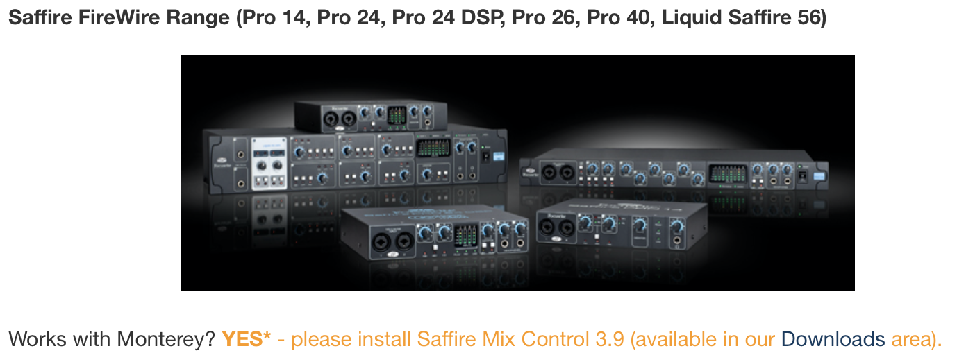

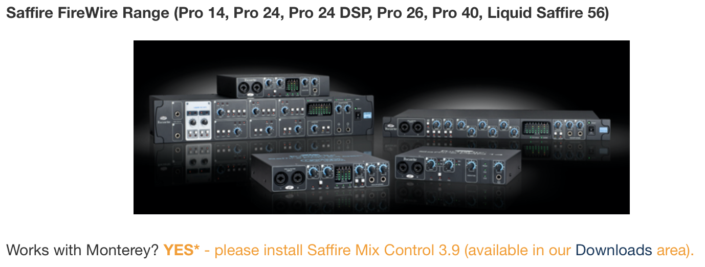

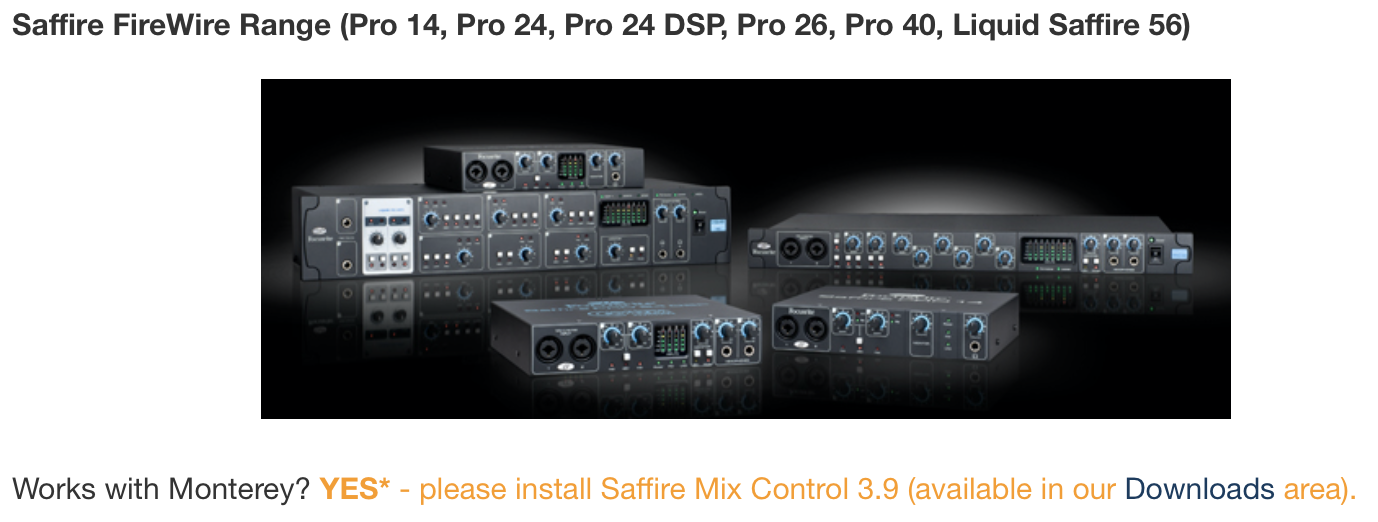

Really hoping you read what I posted above.... Even though it's d/c, it does still work, so I will ask again:
  1. Do you have Saffire Mix Control 3.9 installed on the 5,1?
  2. Are you running Monterey (with OCLP 0.6.1) on the 5,1?

Sorry, yes for clarification, I’ve seen that compatibility list on the website before. I was using the 3.9 mix control and OCLP 6.1 on both the 3,1 and the 5,1. It got it working in big sur and Monterey on the3,1, but not on the 5,1. The module is recognised in mix control on both systems, and sound input works in both systems, but sound output only works on the 3,1. The Safffire output device appears in the list, but there is no sound.
