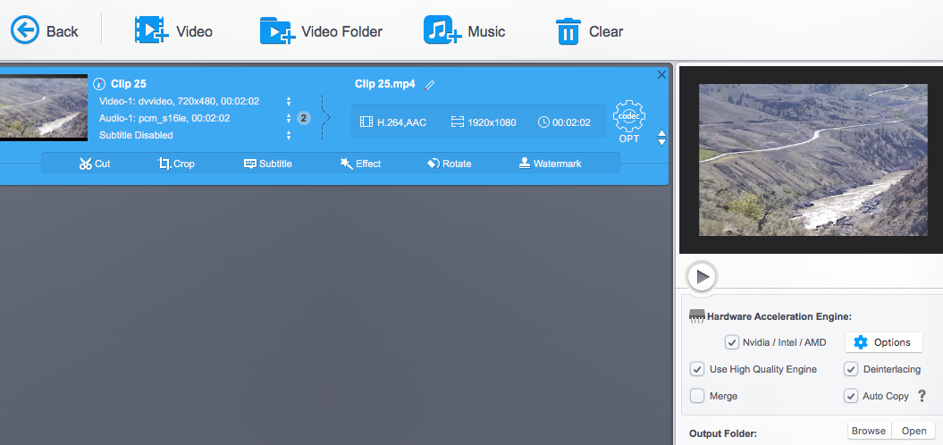

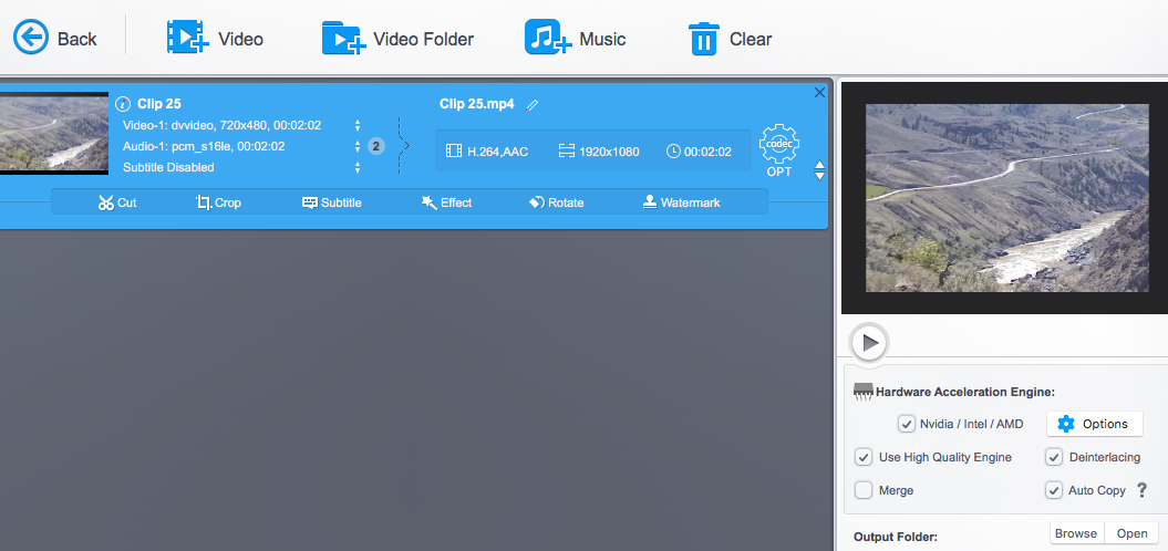

I got VideoProc working and did a test run, but the file seemed pretty bad quality as was just about 585mb in size. I selected "merge", but perhaps I missed some other settings? "nvidia/intel/amd" and "Autocopy" were checked by default as well. These were the option settings:
Am I missing something?
Thanks...

Based on your system specs using Quicksync, you are not going to get any higher quality unless you either go with the fastest Mac Mini 2018 and CPU encoding or accept a slightly lesser quality with Quicksync. You can change the settings in VideoProc to re-encode to a higher quality file using just the CPU rather than Quicksync, but that may double or even quadruple your encoding time. Your Macbook Air wasn't designed for this type of work unfortunately as it is only a dual core.
Which is why I have a Mac Pro with a lot of cores and threads to do quality encoding for my DV final output if I need to use it with another project, but I think the best economical approach for you and that is you are looking for the best quality output consistently for all your tapes would be to use a professional video conversion service. Not all are alike. You need to find one that also works with movie studios or other professional videographers and they do charge quite a bit more than normal services and the reason is that, they have professional commercial grade equipment that will preserve your footage as close to original as possible. Whereas some other services may use prosumer grade equipment that is slightly better than your deck now and offer quality that is slightly better.
In terms of file output, these services will offer you either in non-compressed form or higher quality compressed form. Prices do start to go up when you want to achieve the same quality as your DV clips and that is because, you start to need to use much faster computer and high grade equipment to capture your tapes. You can certainly improve when using better software on your Mac, but just judging from what I am seeing in your response, I think you are looking for a professional quality commercial grade service in which your current gear won't be able to deliver.

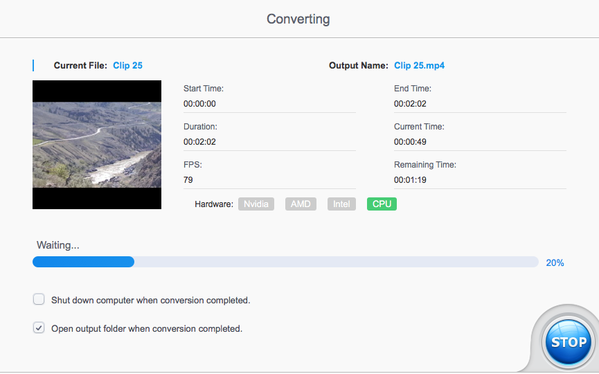

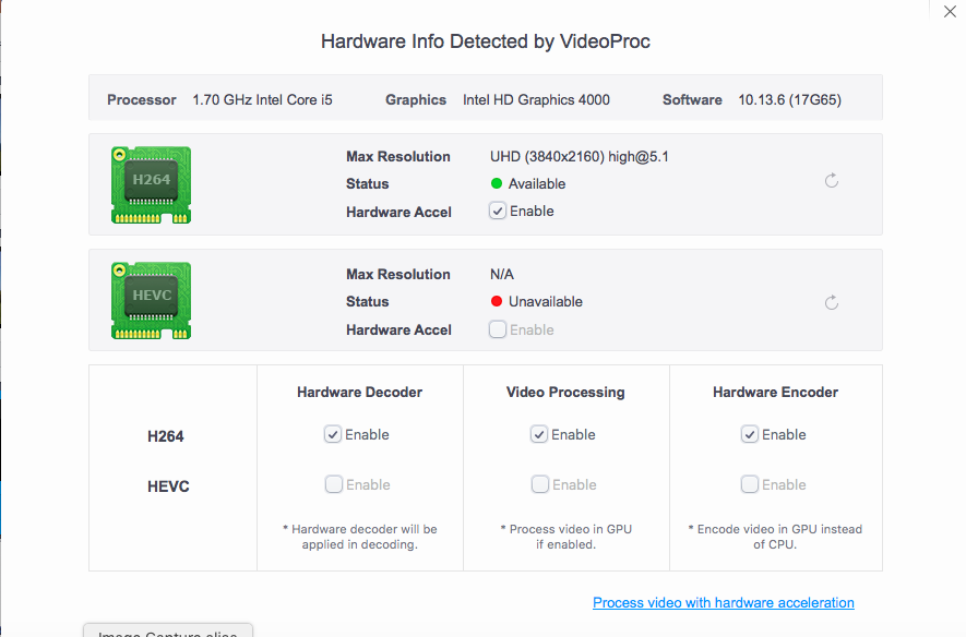

Perhaps this may help.

A faster computer simply speeds up the conversion that's all. Quality remains the same when you process it using the CPU, highlighted by the green CPU indicator on the Hardware selection. If Intel and CPU are both highlighted, then Quicksync is active. Simply click on Intel to turn off Quicksync if you want the highest conversion quality.
Try it with your MBA with one clip. I did one from 720x480 to 1920x1080p up-sampled with my Mac Pro as it did it at a pretty good time. A newer Mac Mini 2018 will be faster with the latest Intel 8th gen Coffee Lake and probably be your least expensive Mac to get more horsepower. I would not recommend getting an older Mac Pro or a PowerMac G5 as they are old hardware; although I do own both because I got them pretty cheap.

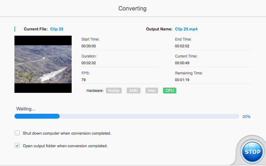

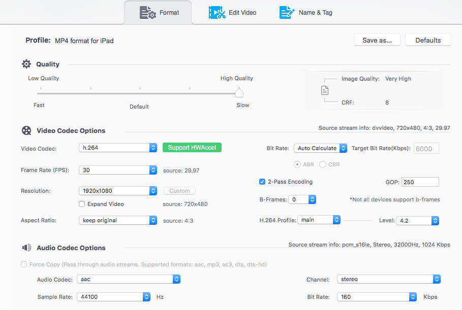

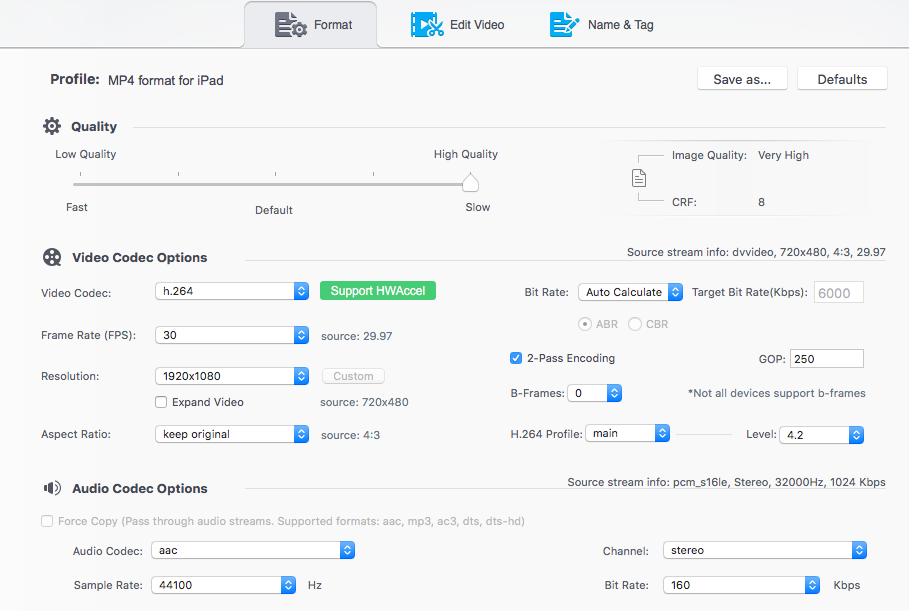

Thanks for this. I just tried to bump up the MP4 settings to the highest, but the output file is almost exactly the same size (it's actually 1mb smaller). I only changed the "quality" setting to "high quality/slow". Should I be changing any of the other settings to get a higher quality file or is this as good as it will get? It's actually not that bad a quality and it takes just about 3-4 minutes for the MBA to generate it. So, I don't mind waiting for a better file (if one is possible to make).
The only other setting to select is a 2 pass encoding which will perhaps further improve quality. File size actually gets slightly smaller due to a lower bitrate. File size will only increase if you select an intrafarme format (non-compressed). Basically MP4 is a compressed format, whereas DV file is not. But you can not play a DV stream on most portable players because the file size is going to be really big.
The consumer grade capture DV format usually ends up being lower bitrate. That is the difference between consumer grade and commercial grade capture, and commercial grade capture is better but at a price.
