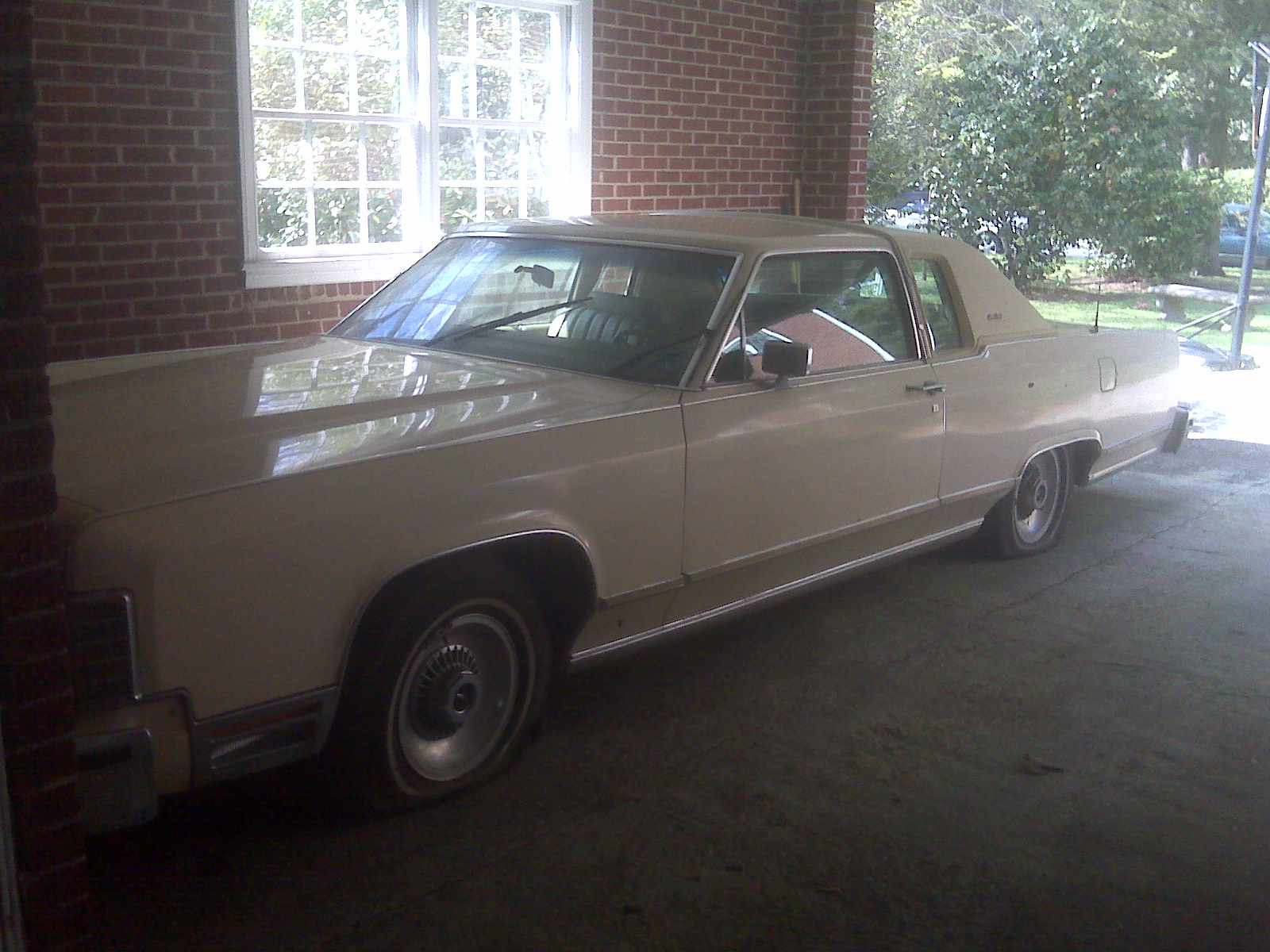

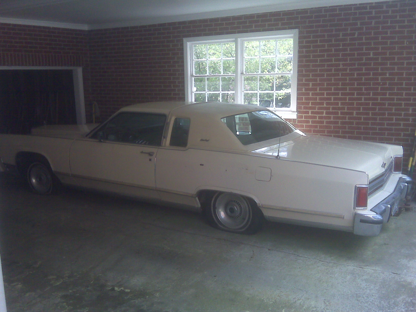

What do you think it would cost total to do all that? Oh, and the tires are flat, duh :D
Pics!!!!!

Wow, nice car, but the trunk is huge!

I actually passed one of these on the road yesterday, first time I've ever seen one. It's not as long as it looks when it's on the road. Nice car.

Haha, thanks. ::D It actually is VERY long in person, I had trouble getting a side shot of the car because it was so long and there was nowhere to back up.
