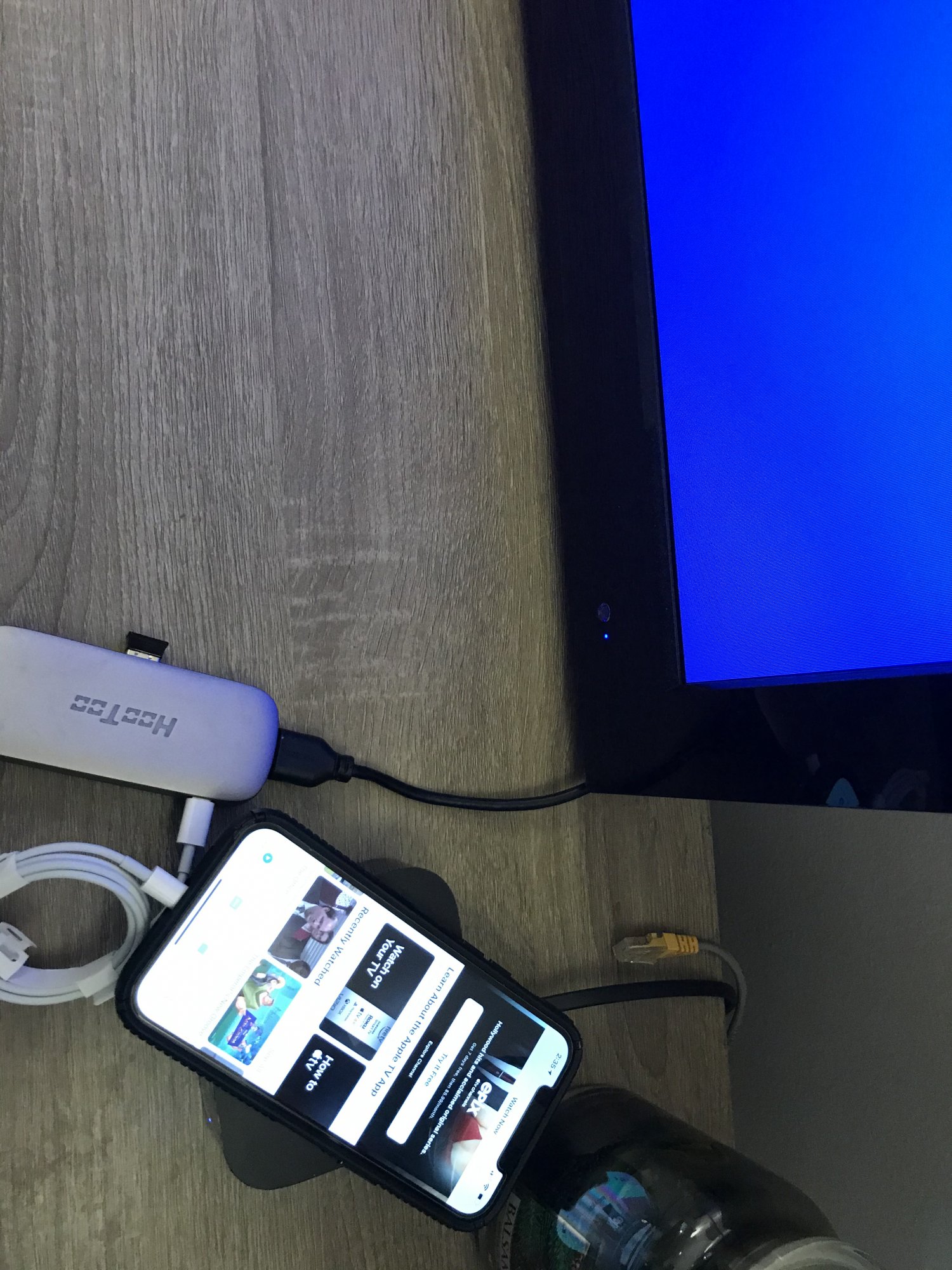

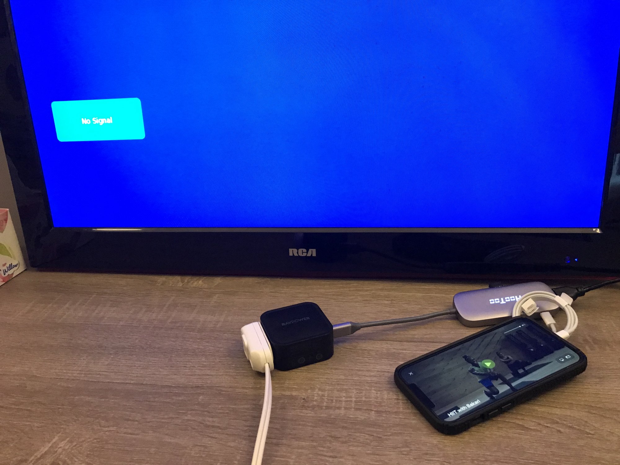

Has anyone tried using a lightning to USB-C adapter + USB-C to HDMI dongle? I'd love to know if that works.
Just attempted it:
Lightning to USB-C cable (that came with my iPhone 12 Pro Max). Connected USB-C end to an HDMI adapter (which doesn’t require it’s own power to function btw, and even tried with the power connected to the adapter). Connected HDMI cable from my dumb RCA TV to this adapter, to no avail: the screen remains without any input.
I dunno why I never thought of this idea. But it didn’t even recognize the adapter.
This is another picture with the power on. No screen mirroring happening. It all plays only on the iPhone.

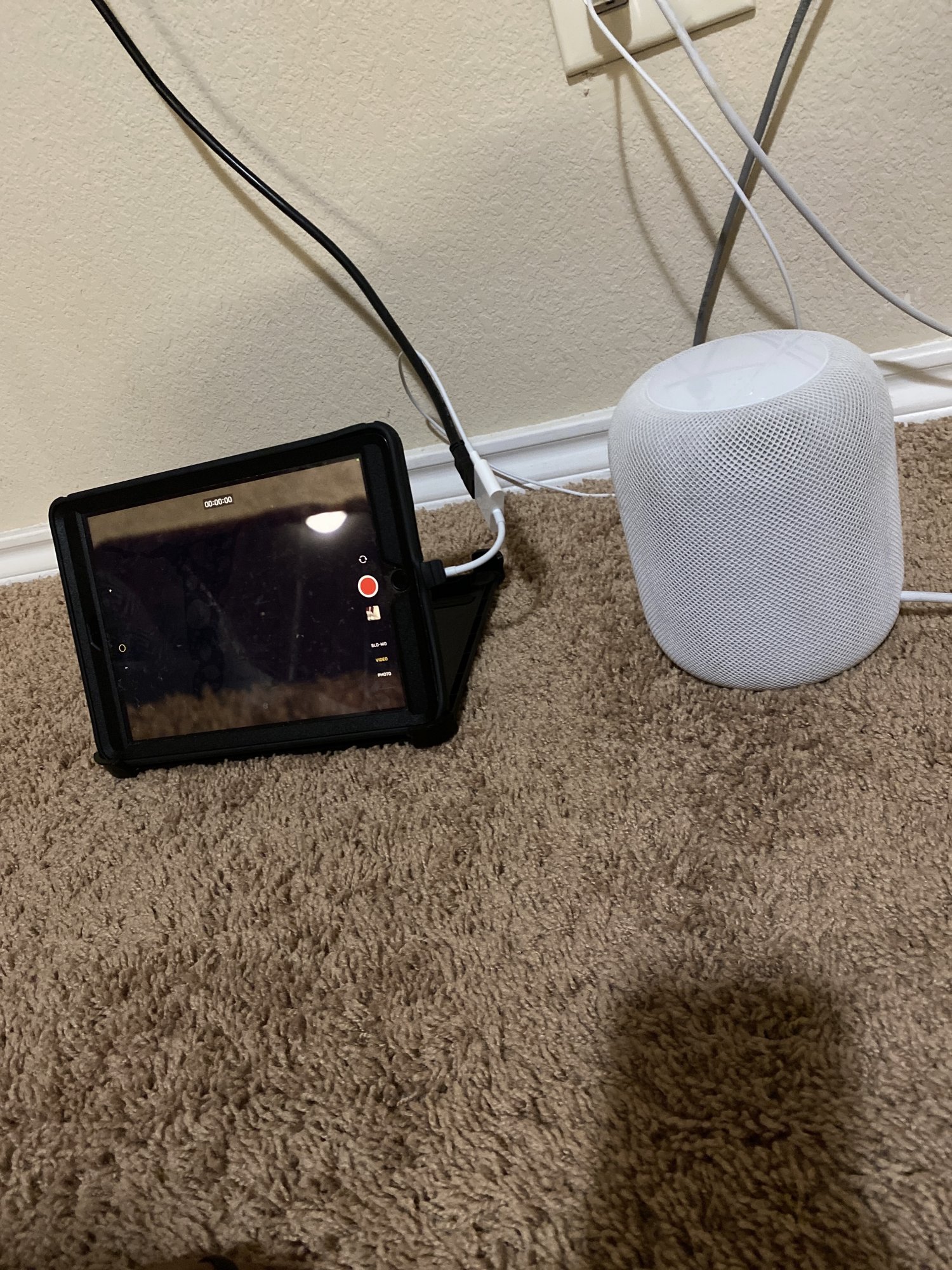

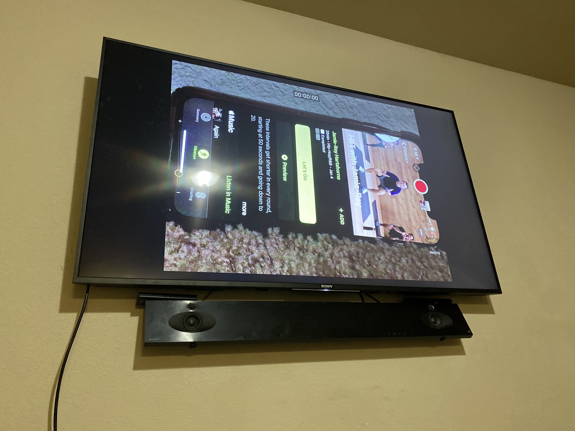

The best thing I got is connecting an older iPad with the lighting HDMI converter to a TV. Open the Camera app and Putting your phone within the camera view of the iPad... a little ghetto but does the job
