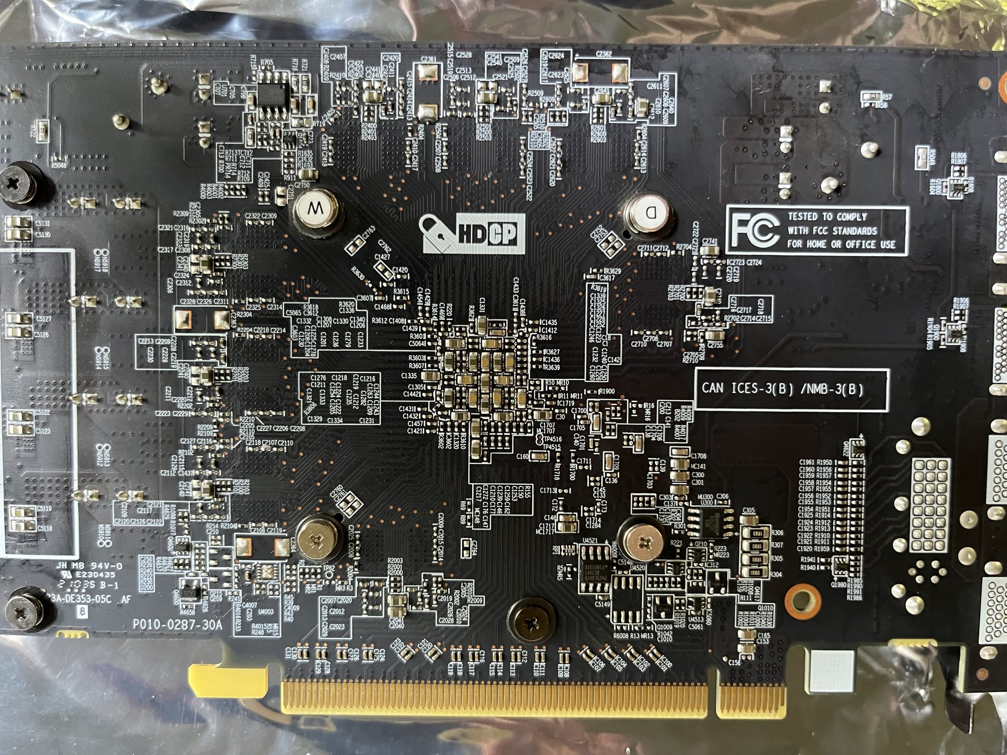

@tsialex - I ordered some thermal paste and I should be able to remove the heatsink and check the memory soon. Looking at the card I doubt it has been removed before - there are a few stickers on the heatsink screws that look like they may be factory applied.

@tsialex - well I couldn't stand it so took the heat sink off. It has Hynix memory though it is marked H5GC8H24AJR.
All the RX 580 VBIOS on TECHPOWERUP reference H5GQ8H24MJR for Hynix memory. Not sure what else might give me insight into what the card is - a broken RX 580 or something else.
Also - it does seem to work fine in Windows but only in Safe Mode on macOS but then reports that very strange memory size.
