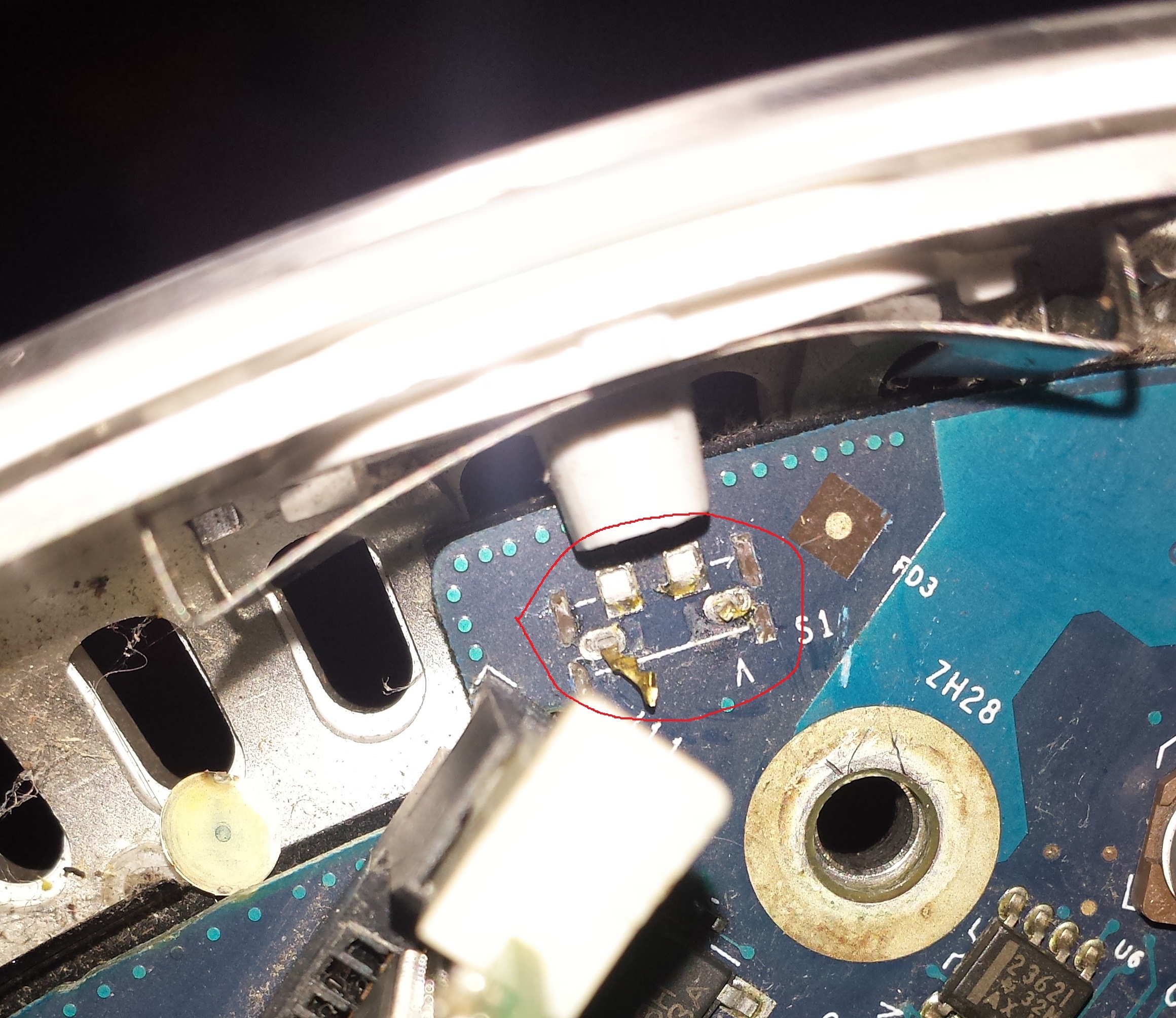

My second eMac wouldn't turn on too. It was a faulty power button. I built myself a testing power circuit and found that the button does nothing. Then started the eMac with a short circuit like all my old window PCs with a wire on the power button pins. That would be an easy to fix problem
Thanks, ill try that right now

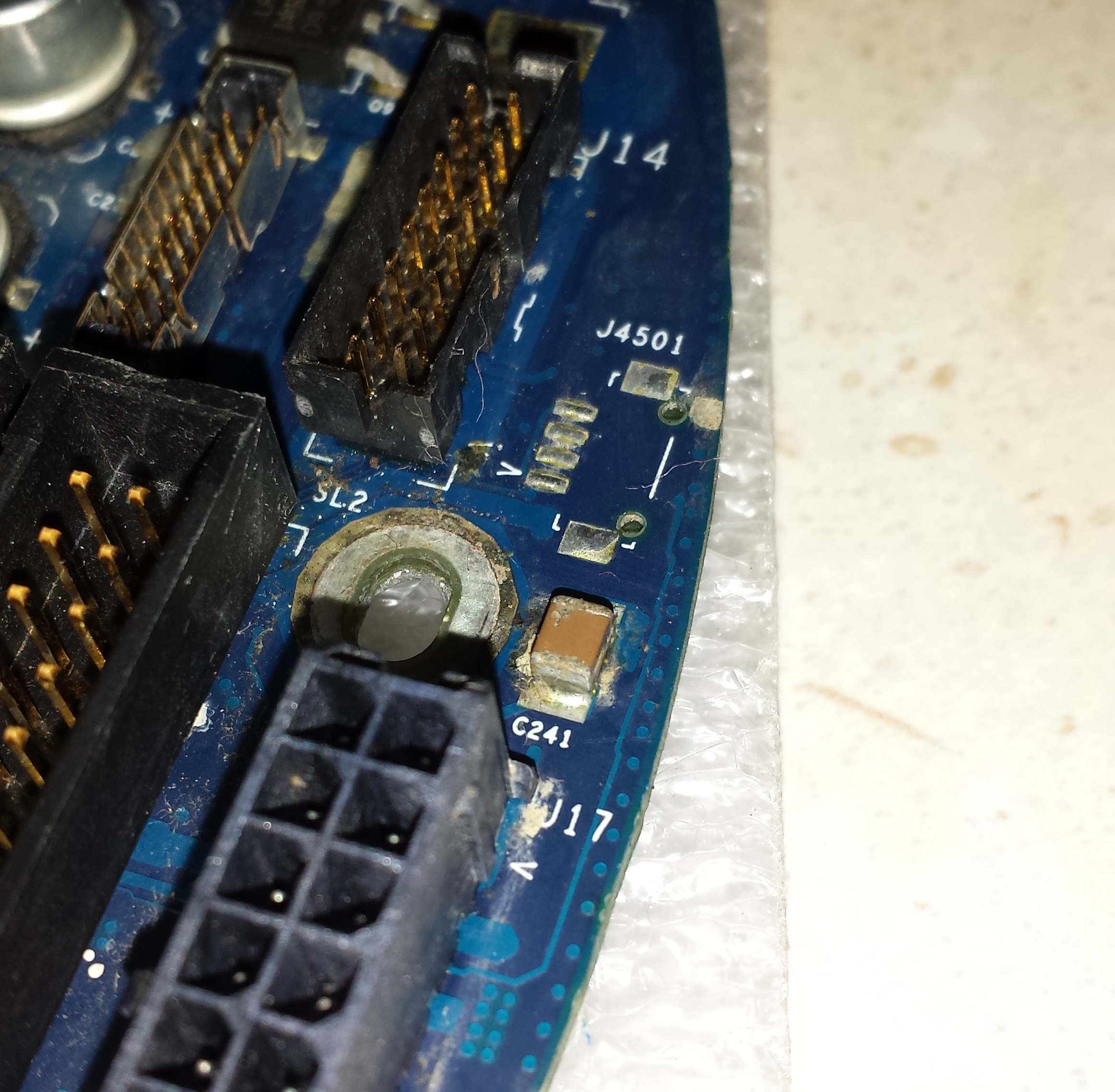

Here is some pictures, first one is where the white powder was, second one is of where the power switch used to be. Unfortunately the improvised power button didn't work, any other suggestions on what to do? If it still doesn't work, ill just turn it into a PC with an Intel compute stick inside.

I believe C241 is a 0.22 µF, 6.3 V ceramic cap, ill replace it and share what happens.
