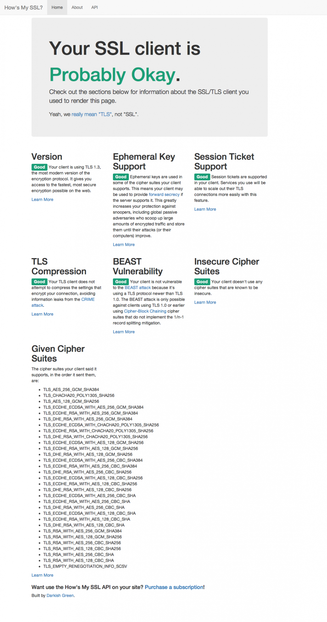

However, Safari 5 resumed (see SSL compatibility check, was all "bad" before) 😃 😃 😃 😃 😃 😃 😃 😃 😃 😃 😃
With that being said Apple sites remained an impenetrable defence be it Safari 5 or Safari 9. The former loaded the main page of their developer site but I was rejected the auth window.

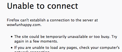

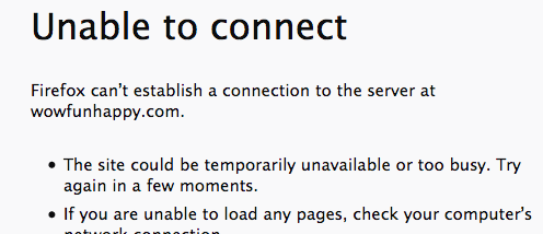

True, however it wouldn't open neither in Firefox ESR nor in Safari.
I don't know whether it would make sense to try to block incoming connections at OSX firewall for Squid at this point. Please let me know if you want me to check anything, I'll be glad to help on my side. Do I need to revert squid.conf back or it's okay to leave it as it is now?
True, however it wouldn't open neither in Firefox ESR nor Safari..
You should tell Firefox to not use the proxy. I believe I have instructions for that in the download. Firefox ignores the certificates in Keychain (grr), but more importantly it has its own, modern SSL implementation so there's no need.
But the fact that wowfunhappy.com (which is nothing special, it's just a Github Pages site) wouldn't load in Safari is actually super telling! Something about the proxy is very much not working correctly.
If you search for Squid in Activity Monitor, does anything come up? Have you tried rebooting, just in case that clears something out? Did you definitely add the Squid certificate to your keychain?
Edit: Okay, I just saw the screenshot you edited in. So Squid is definitely running. If you’re sure you followed the setup instructions, please PM a copy of /Library/Squid/logs/cache.log.
